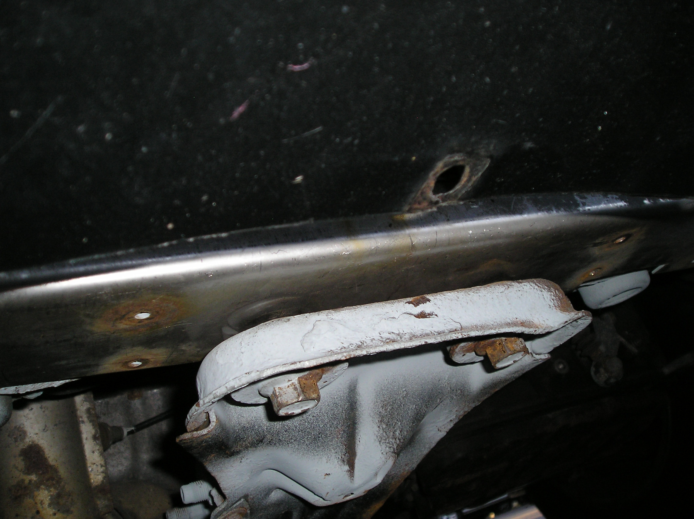

Why you guys need new lower radiator support. A L profile galvanized steel plate is all what need. It is not temporary solution. It is permanent solution. 1,5 year after plate is installed at my car everything is OK.

so you put a plate on top or made the whole support out of galvanized steel? It is an idea but thats expensive and impractical for most. I dont live in the rust belt so I dont have a dog in this fight against rust.

b/c that L profile covers only the outside... if you have ever looked inside a rusted radiator support you will know what I am talking about... plus with everything rotted inside where you gonna bolt the L plate? Better yet try to weld it! Its not that hard to replace the lower radiator support on the maxima... it cost me less that $200 for a new support, hood latch support and numerous little screws and plastic clips to repair mine...

^ thats what I am saying if you just put a plate on top then it will probably be worse because it will trap moisture in between and rust just the same. Now if you made a whole support out of GS then it would be a nice upgrade but that is expensive and if I am not mistaken I do not think you can weld to GS so it would be tough

all the responses in this thread are correct. this is only a solution if the part where the cross member bolts up is only kinda rotten.

I just find health part of lower radiator support and screw my L profile there. This L profile I paid 1$ (from a Infiniti at junkyard) otherwise would cost up to 20$. It can be like this for next 4-5 years and then I will just buy longer L profile to catch another no rust part of LRS.
Just to emphases it is a L profile with SS screws. It is not a [] beam.
You have here something. But only complete LRS from Galvanized steel would make sense because beam would rust just at weld point. And true I would buy only Galvanized steel LRS because regular one make moisture inside. My 1$ plate is superior to regular LRS because is galvanized ( true only zinc plated ) and big hole is behind for water to escape. I expect last as is for 4-5 years. I don’t think regular LRS would last so long.
It is like that already 1.5 years in Mn weather. Plus I use Cold galvanizing compound at it and everything else at my cars.

An L-shaped piece of steel was bolted on by another member 4 years ago
http://forums.maxima.org/4th-generat...sting-out.html
They're no longer active members so who knows if it still holds?
I threw on the OEM lower radiator support last January. It wasn't that hard just time consuming. I had more than enough guidance with the hundreds of posts and pictures already made so I never even made a post myself.
Another method to try is sandwiching 1/4" beams onto the top non-rusted section of the support. My friend couldn't afford a new OEM so I did that for him on his 2000 MAX. I mounted the cross member bar onto the top section using 1/2" bolts going thru sleeves and grommets. I used this members album for guidance
http://forums.maxima.org/album.php?albumid=223
He did that job back in 2008 on a 1995 MAX and states that it still holds today.
GS is the way to go in the rust belt that is for sure. Some aftermarket companies make whole frames out of GS. Props for trying a new idea. A few GS plates in the load bearing spots with plenty of rust preventer and you have yourself a nice set-up. Really glad I dont have that problem
If you talk about LRS from GS now you talk about real quality. For me it is superior to OEM. Would last for decades. Kind heavy discuss about rust and LRS when people recommend "throw Rustoleum primer at LRS...". I mean they are in beginner stage of rust fighting.
Just to add I asked before 2 years at Nissan service for price of LRS and they said like 350$. I asked how much is galvanized one and they said it is not problem if need but 100$ more. Basically if you want they build hot deep one for you.

what makes you think an OEM rad support wouldnt last more than 5 years? mine was fine until i totaled my car. and the one i replaced it with has no signs of any rust and its been on for about 2 years.

i live in ky where we get salt for a dusting my is about gone what i thought after i replace mine is before i bolt it all on cover the bolt hoes up and hit it with some bed liner so it dont rust out or get any salt build up on it..i painted my buddies with it after he bought one and still looks new after 3 years no sign of nothing and helps to with rocks from the road hitting it and other things cats dogs coons lol
I'm pro carpenter contractor and I know play with still profiles, bolts, screws and grinders. Just IMO should be given more chances to steel profiles in case of LRS. Who ask for difference between galvanized and painted Google it.

Just to report to this my old thread as is today L profile is still always strong. So keep going on 3,5 years lather. Massive respect to Nissan. My Infiniti is car with smallest amount of repairs that I had ever. Car is almost 200 000 miles and go like new. Minor rust, of course beside LRS.

I'm here still always too. 5 years after and 70K miles my L profile is still strong. It work and it is not temporary solution.
Attached Thumbnails One opinion about lower radiator support-picture-016.jpg   One opinion about lower radiator support-picture-015.jpg

You can weld galvanized steel. I do it all the time. I just wear the proper PPE when doing so, otherwise you can get sick the next day from it (just a little sick this past Tuesday from welding some galvanized on Monday).
ef9 is offline
Old 11-16-2015, 09:41 PM
bbsitum's Avatar
Join Date: Jun 2011
Posts: 83
I didn't weld. I used SS sheet metal screws, I think 6 of them to screw plate to healthy part of LRS. Of course welding would work too.

I just hope the sheet metal screws don't vibrate loose.
ef9 is offline
Old 11-21-2015, 07:36 AM
bbsitum's Avatar
Join Date: Jun 2011
Posts: 83
No they didn't do. I didn't tight them never. Two reasons. One is they made some threads in LRS and second they sort of weld over time with LRS. I know in front they will not go out. It from my construction job, I'm a carpenter contractor. All what you need is a L plate and a few SS metal screws. Then you need a strong angle drill to predrilled holes and then you need a strong impact driver.
You are mistaken. One of my friends is a welder and welds GS all the time for his job.
However, doing so gives off nasty, if not toxic fumes and should not be done without very good (think fan blown) ventilation and without a breather mask.
