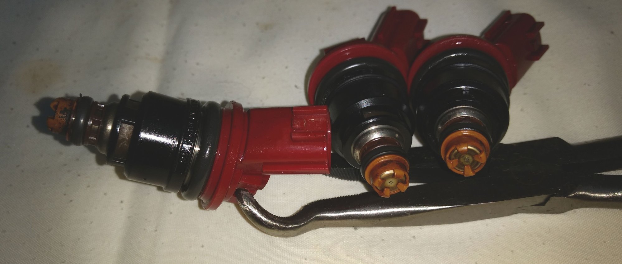

Last night I changed the left bank (front) three injectors. After looking at the condition of the old injectors, I'm really glad that I'm doing this replacement.
The o-ring on one injector had become hardened and flat compared to the other two. All injectors were extremely dirty. I just don't see how the car ran as good as it did with those injectors.
I did try out a new tool from Harbor Freight that seems to well for pulling injectors. The tool name is a Long Reach Hose Grip Pliers. Also, I will use the tools for removing and installing hoses. I can think of more than one use for this tool.
Look at the crud on the end of the left injector in this picture. This weekend I aim to replace the other three under the intake plenum. I'm sure those injectors are in similar shape. What a MESS!
The injectors in the picture did not leak -- that I could detect anyway.
After looking at the condition of the old injectors, I am now 100% convinced that proactive injector service or replacement is a very worthwhile endeavor for a high mileage vehicle.
CLICK on the picture below to expand it and see all of the crud buildup on the screen and pintle cap.
One of the o-rings was flat and hardened compared to the other two. You can see the nozzle end condition in this picture.

These 16600-10Y00 appear to be longer than the OEMs I've pulled from my 1998 and various A32s at the JY. To fit these longer JECs fuel injectors into the rail do the OEM rail cushion rings need to be replaced with larger ones? If they do please provide the PNs for the rail cushion rings and the cap cushions. I plan on ordering a set of 6 new JECs fuel injectors. Injector #2 started leaking and needs to be replaced.
Here's a photo of injector 2 I just pulled. I already snapped off the broken pintle cap. I plan on refurbishing this injector with a new cap, mesh screen, and O-rings. Also give it a cleaning with sea foam.
Maybe a touch smoother.. Though the old fuel filter was very dirty and I cleaned the EGR tubes and replaced the EGR and EGR vacuum solenoid along with the new injectors. The old injectors were healthy. Since the cost was so low, injector replacement was strictly done as preventative maintenance.
