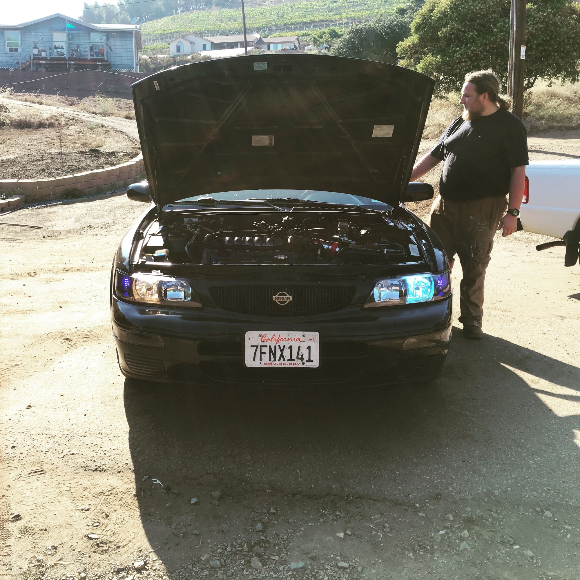

I have these on my Maxima. Instead do got mine off of amazon, they're out of stock now though I believe. It came with the new harness to split the bulbs and all the hardware needed to mount them. My car had been in a accident with one of the previous owners so I can't really speak for the fitment of them. One side is pretty close to spot on but the other is not but that's my cars fault. The weather stripping on them isn't the best and one of headlights leaks water in when it rains or when I go though the car wash. So if you do buy them I'd take a minute to make sure all the gaps between the lens and housing are filled with sealant. They do look really nice however. I've invested a new bumper so I can have mine fit as nicely as possible. They did come with bulbs to but I replaced them because they weren't bright at all and didn't look very good. You can see them vs some HIDs I put on in one of the pictures (not me in the picture btw��). I want to warn you to not make the same mistake I did. When you take the side marker lamps out of the original housing make sure the plastic connector for the bulb is in good shape. I didn't and I have white bits of broken plastic in my nice new headlights because it was so old and brittle. I painted them black afterwards to match the lights but I still have white plastic bits stuck in there... if you'd like I can take better pictures in the morning. That's just what I had at the moment

I can see the HIDS look better on the headlights, I know there is probably threads on this already about how the r34 have horrible output than stock.. the only reason why I haven't got these yet cause most of the time the seller only supplies the headlights and not the harnesses/bulbs needed to do the swap.. I got bored and was searching around ebay and found this seller to supply the necessities for the swap.
