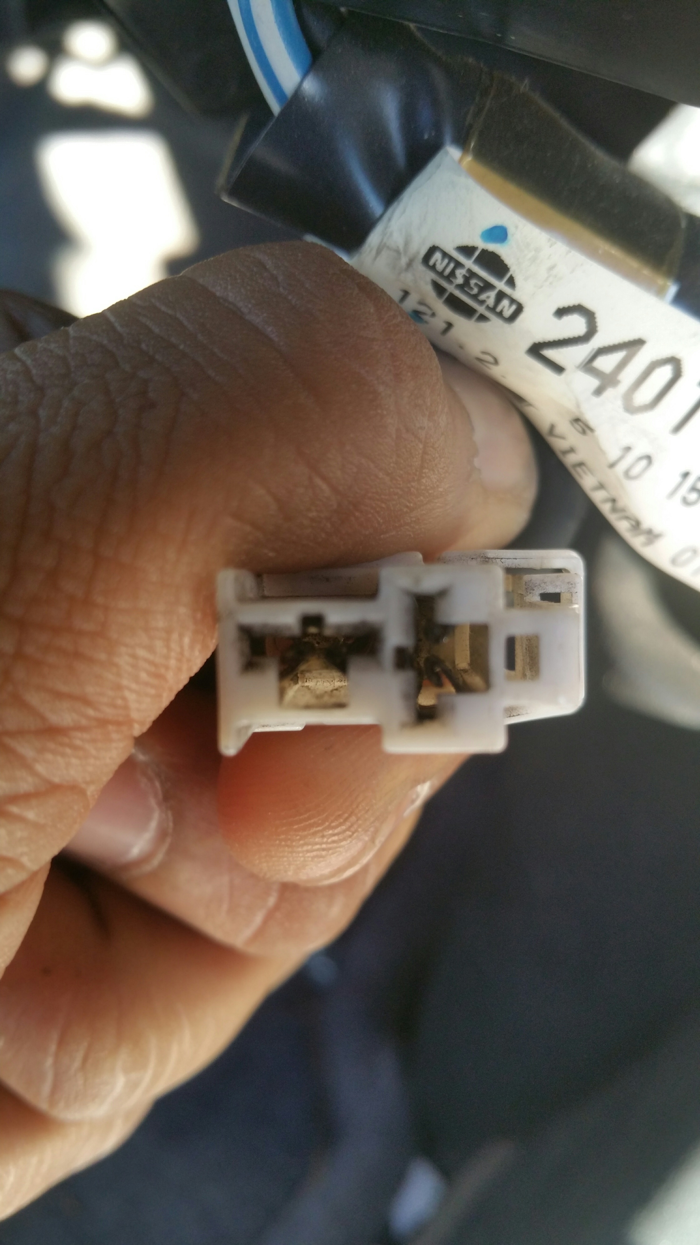

One thing you guys need to learn is to tell us about your car and what options it has that are related to your problem. At least you stated that you had a 2002 gle, which is more than some people will do. However, that is not enough. Do you have the manual climate controls or the auto climate controls? Because you have the GLE model, I assume you probably have the auto climate control system. And if my assumption is correct, do you have the Nissan navigation system?
Since your answers haven't allowed me to pin point the exact cause of your problem, I would like you to run the built-in self diagnostic for the auto climate controls. Go to page 43 in the link below and follow the instructions for starting the diagnostic.
http://boredmder.com/FSMs/Nissan/Maxima/2002/HA.pdf
But in post # 16 you also made a statement that "the plug that goes into it was all burnt up" in regards to a mechanic changing "the blower motor control module". "Blower motor control module" is not an actual part name. Did the mechanic use the term "blower motor resistor" or "fan control amplifier"?
But the burnt up plug comment concerns me. Wires and connectors that are subjected to the high temperatures caused by a short can crystallize the metal and it looses its ability to conduct electricity. The metal also becomes brittle and breaks if you try to bend it.
Can you post a close-up photo of that plug?

I have attached a pic of the plug that he says is burnt. To me it looks dirty. It is the plug that goes to the blower motor. I ran the diagnostic from the PDF and it indicated that everything was working properly. The only thing is that on the first step when you enter diagnostic mode the light for the fluorescent display tube doesn't light up. I have attached a picture of that as well. If that is the case then I will need to replace the A/C Auto Amp?

Thanks for the photos. On the burned connector, that connector was on a fan motor that burned up. The black stuff that you are probably thinking is dirt is smoke from the fire. Being inside the car and hidden up in the corner of the dash, that connector never gets dirty.
I can't see the metal contacts clear enough to be 100% certain, but I think that connector should be replaced. Seeing this photo combined with you having removed the motor and connecting it to the battery is making me think that the connector is no good. Visit a junk yard and cut one off of a car there.
On the other photo of the control panel, it has everything illuminated. It sounds like you are saying that you don't have the dash light. Off the top of my head, I don't know how that works. I'll have to go look at my car.
I think I have a solution for the connector that will work without needing to go to the junk yard. I'll do it in the morning and post pics and hope it works.
