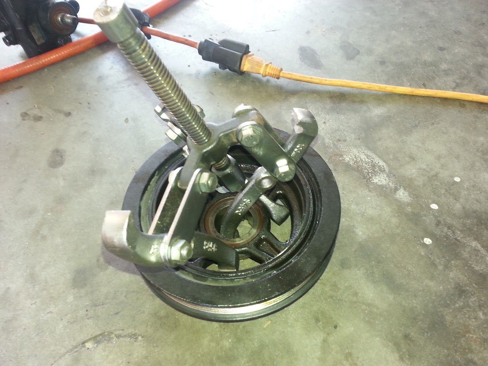

Had a little leak behind the harmonic balancer so I replaced the seal and the harmonic balance - It had 100,000 so why not replace it while I'm there
RinconI30 is offline
did this solve your leak here? i'm looking at a similar mess in mine and was thinking of doing the same thing
cornholio is offline
Old 05-31-2016, 07:12 AM
  #68
RinconI30's Avatar
Join Date: Sep 2015
Posts: 57
Yes it solved my leak I have no more leaks on the ground
