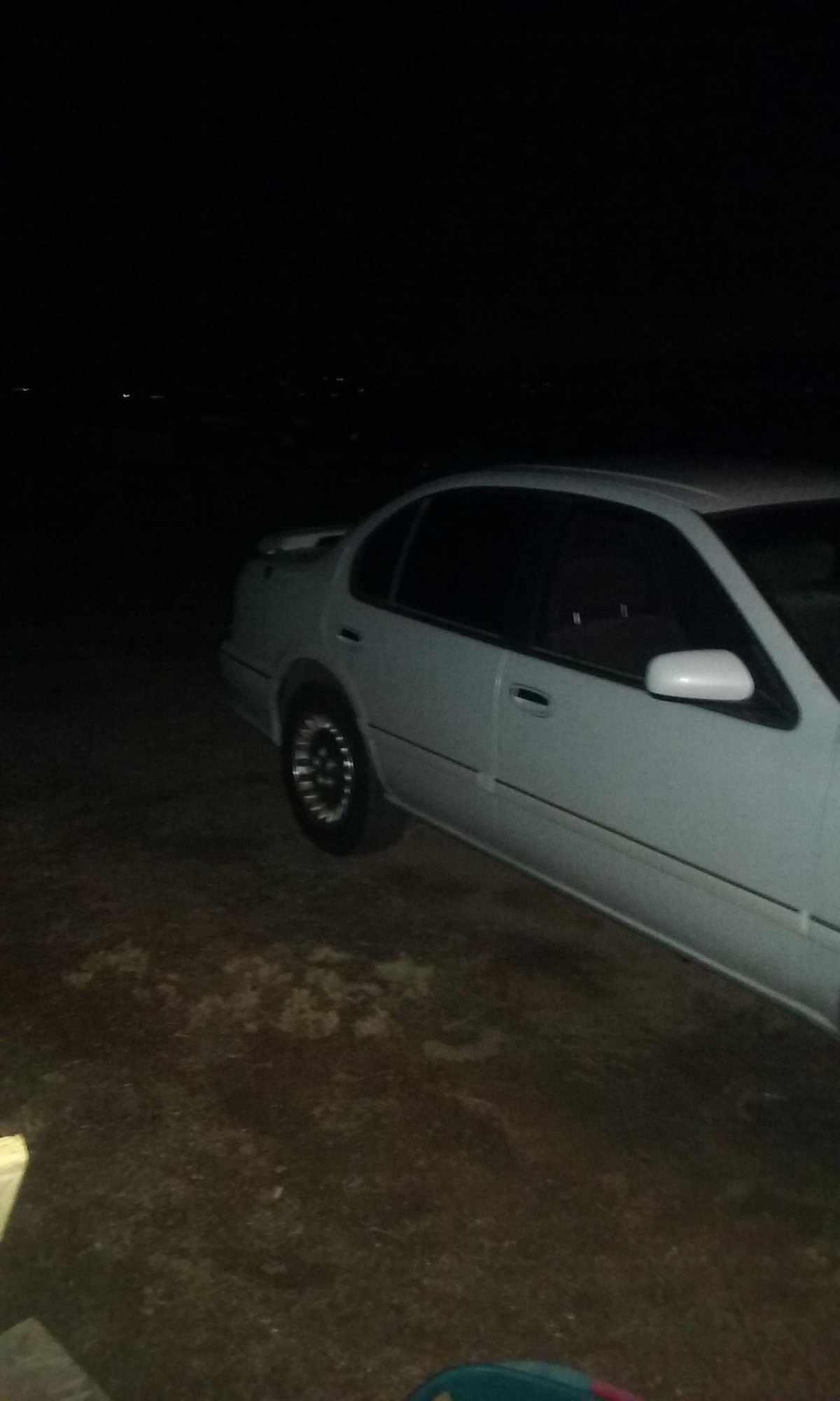

Hi all, I just picked up a 98 I30 for 400 dollars and I have a few things I am going to perform on her whilst I am rebuilding the the venerable VQ that was in her.
1st up is headers, then on to Egr delete, removal of the evaporative emission system * key note "Emission regulations" not required where I live *,
full suspension overhaul due to blown wheel bearings and struts, recover the console lid * thankfully not broken at all *, and rebuild the power steering due to 230,000 miles of YUCK... any thoughts of anything else to look for while in there?
