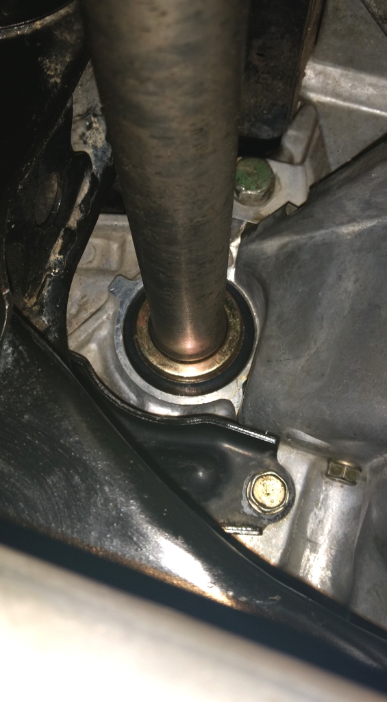

The installation isn't hard provided you have the right sockets. I usually rent/borrow a kit that has 32 MM through 36 MM at Advance auto.
The hardest part on a manual transmission is to remove the transmission seal on the passenger side. I broke down and bought a seal removal tool today for the passenger side.

Yep. I always replace seals with new axles. Its just not worth the headache. I have a similar approach for reusing the old fluid to verify leaks. I just changed the fluid a couple of months ago with a fresh round of Redline MT90.
I made a tool from PVC pipe and coupling that is a perfect fit over the outer rim area of the passenger side seal that I use for installation.
Over the past six years of owning four 4th gens, this makes CV axle replacement job #8. I know I have another coming up next year. It's starting to get old. LOL

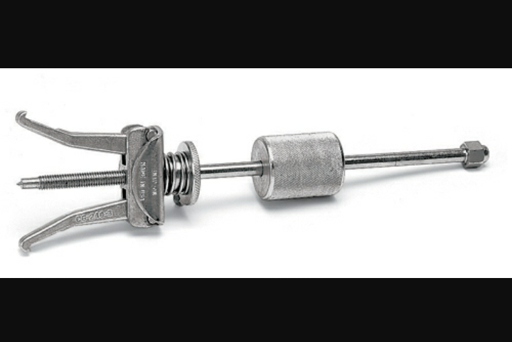

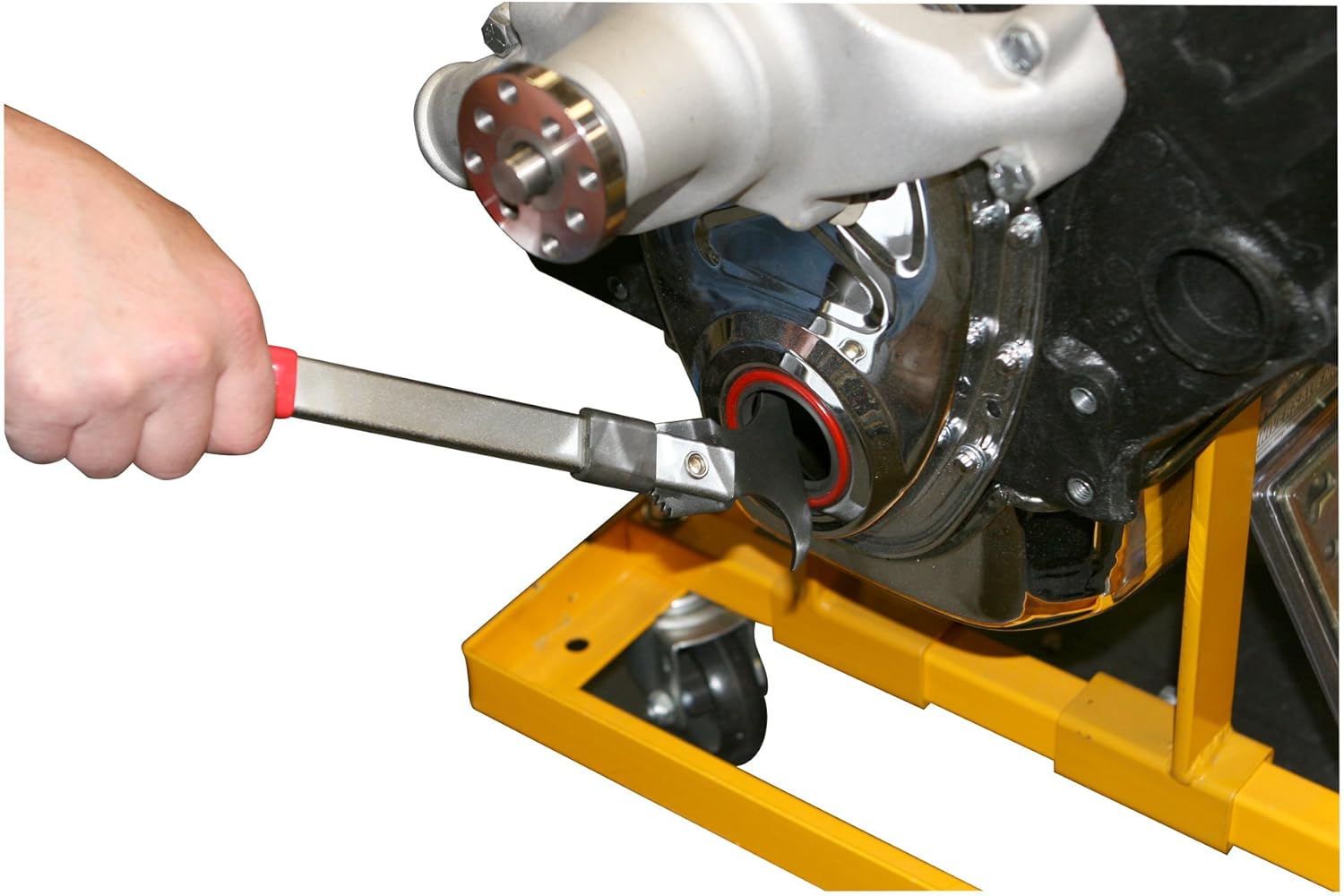

Yes, passenger side axel seal is a real pain to get out. Could you share the tool your using to get it out? A normal seal puller did not work for me, or there was no room for angling, went ahead and removed y pipe and cross member it was a nightmare.
This looks like a better tool because the head can be adjusted to an angle that will work in the tight space on the passenger side. I would have been done a couple of minutes faster if I had been using this tool.

I dont like using those axels seal pullers. Those can be harsh on the casing where the seal sits. I used a bearing like puller. getting the passenger side seal was a piece of cake with this tool. To bad i did not find it my first time around

Well after all the work to build enhanced axles for a RE4F04A.
Once I pulled the axles and took a look, it turns out the transmission has VLSD. I'm happy and sad all at the same time. I know somebody had installed a different transmission, I would have never guessed it to be one with VLSD.
The passenger side is an OEM type axle, the driver side is another GSP. The OEM axle has a cracked outer boot. The GSP is ok but I know it will not last.

I have a rebooted OEM driver side axle, and a rebooted Rockauto APWI passenger side axle.
It turned out the noise I had been hearing was from wheel bearings. Those have been replaced and are ready for the knuckle to be installed.
Strangely, the outer boot on that old GSP axle held up. It looks like it may be approaching 8 years old. The boot material is weathered from many years of wear. That leads me to believe the outer boot split problem on GSPs may be more common with non-VLSD axles.
