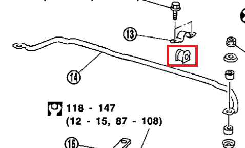

Sadly no label on the bushing :P
However I did find a great old post about this: "What size sway bar bushings"
Looks like I need 20mm front sway bar bushings. Energy Suspension makes part 7.5118G and they can be
had on Amazon had on Amazon
for not too much.
One review mentions that the bushing didn't hold up very well. Anyone else have experience with Energy Suspension products? Don't know if I have any other choice... Perhaps OEM. Doesn't look like Moog makes this part, sadly.

Here you go, this is the part number for the SE 97-99 maxima bushings 54613-0E015. I know because I replaced my bushing already from the dealership. I ordered them online through Nissan website and I forgot to enter we and I got the small gle and gxe bushing instead and the reordered the correct one and it was much bigger. I don't think you will find the SE bushing outside besides from the dealership.

The Energy Suspensions Part number: 7.5118G is for the SE model and are for 20mm Sway Bars. Even if your Sway Bar is 21 MM, these aren't Metal and would still give enough to work just fine. ES only makes 20MM bushings for 4th Gens.
The 1999 SE model uses a 20MM Sway Bar and these are a perfect fit. Might be the case for 97 through 99 SE models. I have a 99, so I know these fit mine.
GLE and GXE models use a 19MM Sway Bar. Use Moog if you have either of these, they only make 19MM Bushings. Or OEM, but use the appropriate ones.
