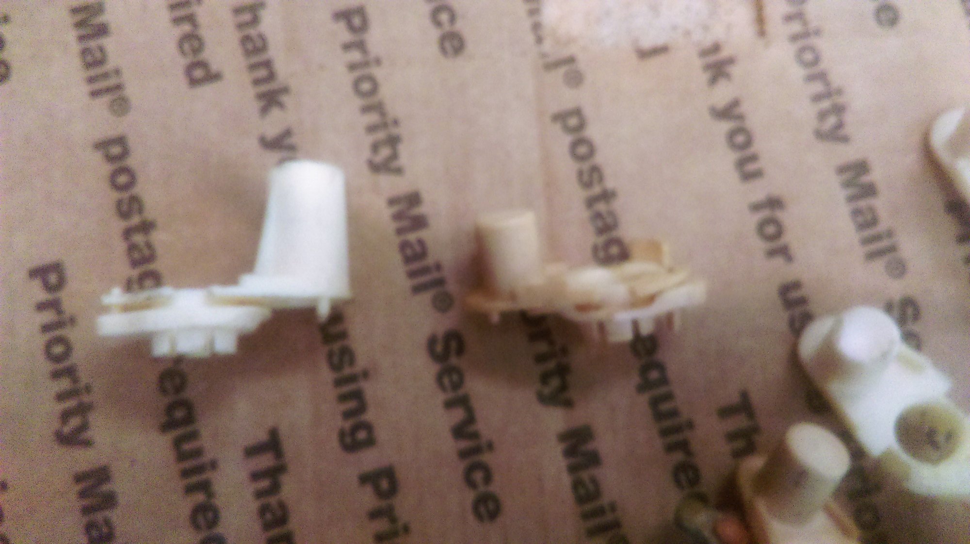

Posts: 160
Here is a better pic of the plastic what I would call bumpers. The air bag hits the bumper and since the airbag is not grounded the ground for the horn is completed. The brackets are spring loaded so force on the airbag will cause the spring to compress grounding the metal bracket and grounding the horn switch.
97-99 are on the left. 95-96 on the right
The 95-96 are sold. The 97-99 are up for grabs.
