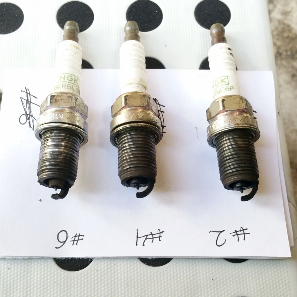

Right after I took out the spark plugs, they all appeared to be wet with fuel. Not sure if any were significantly more wet than others (maybe hard to detect). I did notice one (#5 IIRC) was a little drier that the rest.
Here are the pics, though some of the fuel had dried up by the time I took the photos.
I took them with a phone camera but let me know if you need better pics, I'll use a proper camera.

I think the pictures are fine. Cylinders 1, 2, and 4 look like they may be running on the rich side.
I would be tempted to pull the injectors from the left bank (closest to the radiator) in install new o-rings and pentile caps just to see what happens. That would leave you with only one rich cylinder on the right bank under the intake manifold.
I run the NGK copper v-power spark plugs that cost roughly $2.50 each. I know they are a low cost plug that only lasts 25,000 miles. But I would actually pay more for them over platinum or iridiums due to the amount of spark they produce compared to other plugs.

I'll guess the 2 left on the top cylinder, and the middle one on the bottom (maybe the left-most too?)

Those plugs look blackish, and tell me that the engine.has been running rich on fuel for a while.
Normal plugs in a healthy, happy engine ate usually greyish to tannish.
So this tells me that you have been having an over fueling problem. So you are on the right track.
Which should be good news.

My suggestion would have been to run a compression check considering how oily the plugs look... kinda tough to do when the engine is apart... You can perform a leak down test assuming the bottom end is not torn apart and set a measured amount mineral oil into each cylinder and time how long it take the oil to drain past the rings
