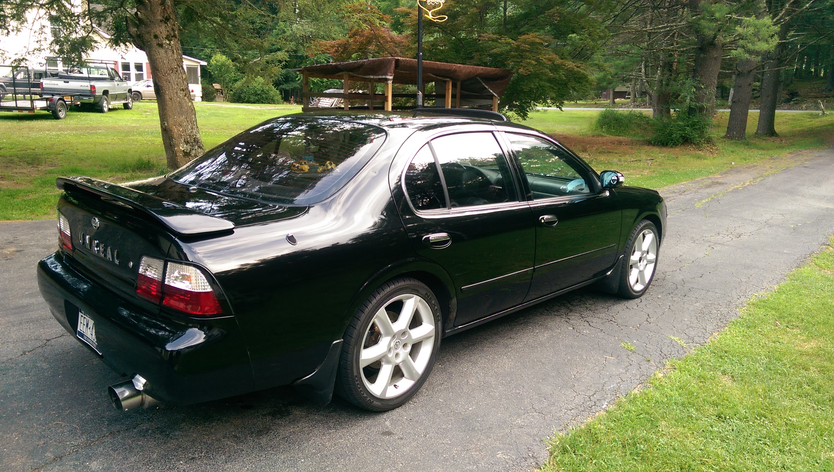

Yeah I am thinking a lower mileage or that rebuilt long block for 2.2k and use my covers and new gaskets and seals that go along with it. I have spent a lot on the car and this might sound crazy but my 8 year old son wants to drive it when he is of age. Makes me want to keep it and gives me the chance to rebuild it as silly as that might sound. I know it might be a lost cause in some peoples eyes but I am not one to let go of my things that easily This is what she looks like
