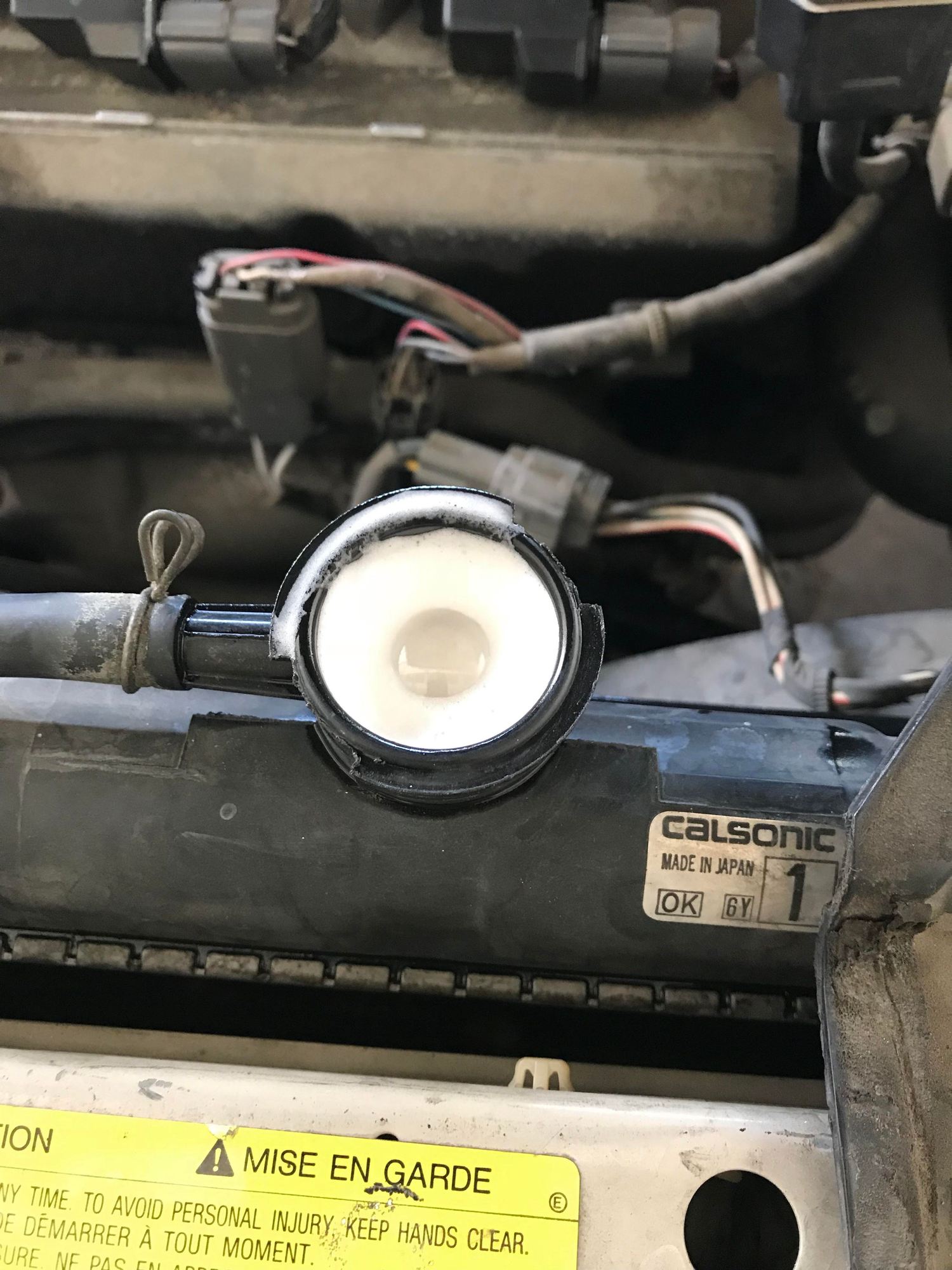

Edit: more information
I found out that the cap is actually not failing to release and is probably fine. The piece of **** test kit compresses the spring so much that it has no room to move in order to release when the cap is installed in the tester, so it is totally useless.

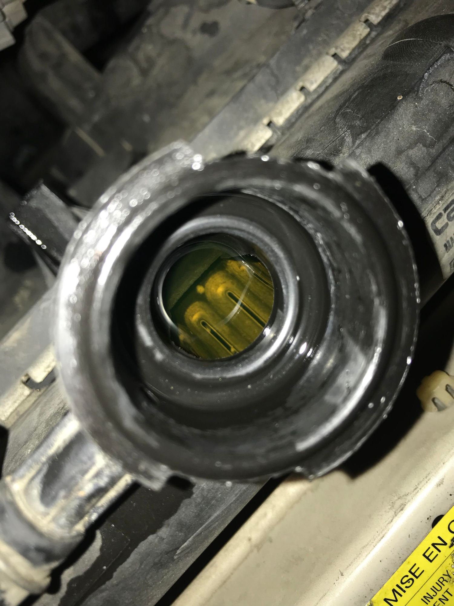

This is a video of it after warming up with cap off. Maybe still air in there? Bubbles continue after it's hot, is that more air or boiling coolant?
Can also see the coolant jump when I rev the engine, how does this look for flow?
All temps I see when fully warmed up are 160-180 but indirectly through the hoses.

I watched the video and have these comments/suggestions. The temperature gauge showed 168º which is the opening temperature for the thermostat, so the thermostat seems to be working as it should.
Looking at the radiator filler opening, I think there may be air in the system. A bubble would come out once in a while and that is not normal. If the cooling system were purged of air, there would be nothing to create a bubble. As for the coolant surging/jumping when you rev the engine, that is normal because the water pump is running faster.
As advised by others, try bleeding the air from the system. Raise the front of the car at least 12 inches and run the engine for a few minutes after the thermostat opens. I personally raise just the left (driver) side when I do this but others seem to have equally successful results when raising the entire front.

Thanks for looking at it, I'll try bleeding it out next. My thought too, the temps seem normal and see a drop from hot to cold side of radiator so it all seems good.
As far as the reservoir, if the level does change, it isn't very much and I really haven't noticed it. Should I add coolant to the reservoir and look for changes? Currently it is below half but above the lower line.

The water is hard here but I think it looks good inside, what do you think?
I know it looks kind of crusty on the outside of the radiator there but that was from it overflowing while checking it and wasn't there before.
I used to live in Salt Lake City. They have hard water, dissoved limestone. My first cars radiator looked like the inside of a cave. My car overheated frequently. I was a teenager at the time. I could not understand why at the time

That's too bad about the hard water. Isn't the rule of thumb that only distilled goes into the radiator? I'm curious if you think my radiator could be original or has been replaced recently?

The coolant has turned white and foamy as it’s gotton hot. Is this normal? When the fans kick on the white foam goes away.
Also the hose to overlfow seems to be blocked because the coolant runs over the radiator top instead of going freely into the tank. Could this be a problem?
Still getting big bubbles out of it.

The foam could be steam from overheated water.
Especially so because it goes away when the fans come on.

I have never seen a radiator do white foam like the photo the op posted in a post # 25. The coolant evidently has something in it, but I don't know what it might be.
