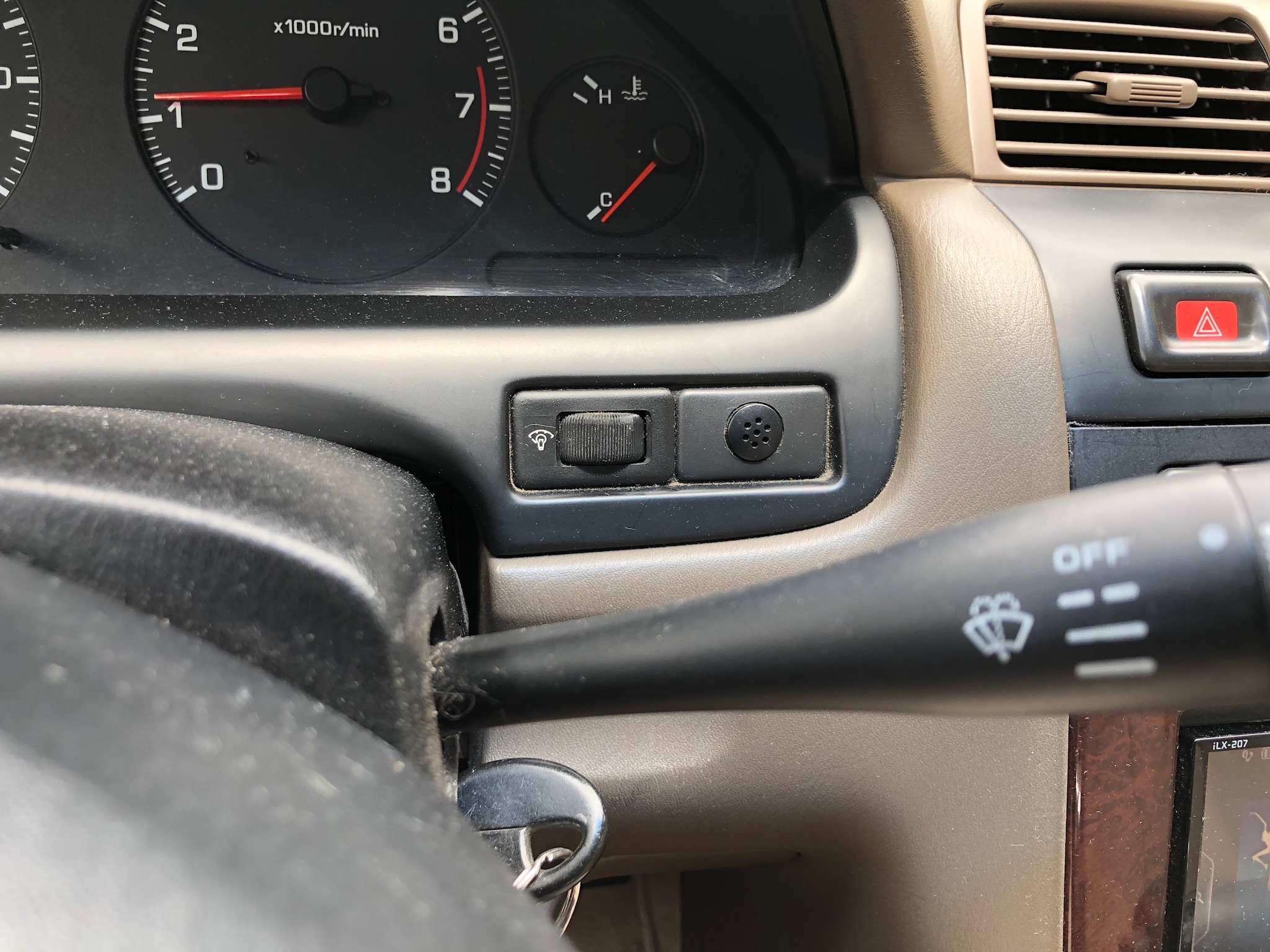

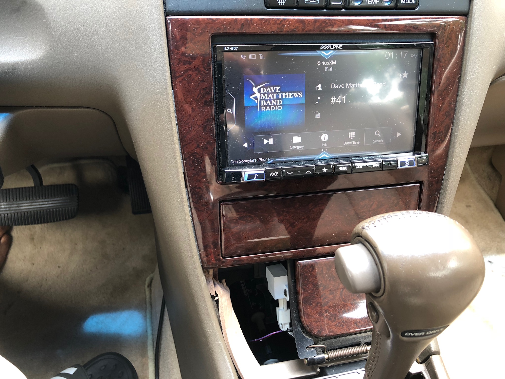

I mounted my mic next to the dimmer switch. Removed the little cover and used a drill and round file. Extra wire was bundled and secured with zip tie and tucked away behind the mic.
As for the usb wire, I just ran it along the side to allow for easier switching between usb drive and the lightning cable for the iPhone. I’m sure you can find a way to run it up the middle towards the cup holder/center console area.
