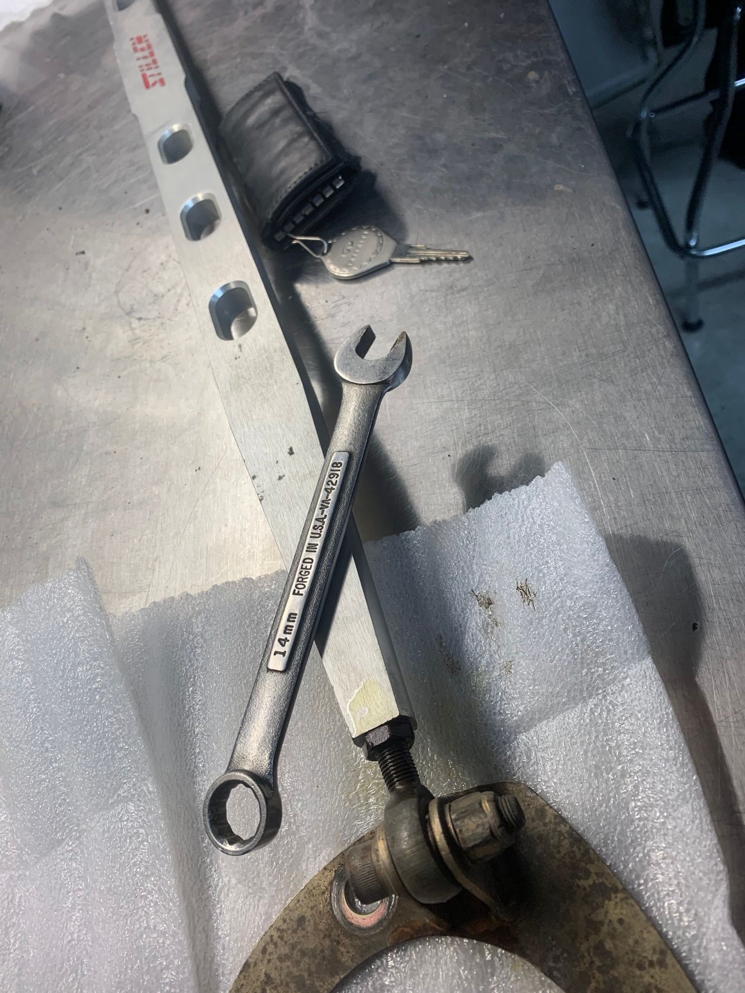

i'm cleaning up the used Stillen piece before installation. i'm trying to loosen it's adjustment / lubricate it and WITHOUT breaking it. Is the adjustment nut reverse thread ?
the "adjusting nut" ? did not turn counter-clockwise under moderate force...i put some kroil on it and will come back to it. it was rusty - but not _that_ rusty
the allen key bolts and nuts as delivered seem a) backwards (allen keys should face forward - if only for looks right?) and also b) beat up. What Grade bolt is necessary for replacement ?
what material are the end links made out of? they have mild corrosion on them - whats the best way to clean them up? i was thinking "wire wheel"...
i only staged this photo a little
the nut in question
reallywildstuff is offline

the term "counter-clockwise" is relative to one's position.....ie bar side vs mounting bracket side. Assuming you turned the nut counter-clockwise relative to the mounting bracket, it should break free. I don't recall those eyelit bolts being reverse threaded. You said you gave it moderate force, it won't hurt anything giving it light to moderate force the other way to see if indeed they are reverse threaded. Have you tried both sides?
I would re-use the allen bolt, just clean it up. How it's mounted is personal preference. I agree with you, the allen head should be pointing towards the front of the car.
Wire-wheeling the brass looking mounting bracket will work, but keep in mind you'll have light scratches remaining. Perhaps start with a buffer wheel.
The Wizard is offline

There isnt an adjustment on the drivers’ side - only on the passenger’s side.
the bar has a threaded hole on the passengers side that the eyelet threads into. Im “looking” down the hole when I say “counterclockwise”.
i did briefly try it clockwise too
i will put the bar in a vise and try again

Nut should come off like any nut should, you just need more leverage it sounds like. Why adjust it though if it doesnt need it? Its not like theres a variation in the gap between strut towers with different maximas.

Rather than trying to bust the nut free, why nut try spinnning the whole bracket/eyelet bolt counter-clockwise?

All of them were frozen in place - better to R&R it before putting it on the car.
Once I disassembled the end pieces this was easy, The eyelet and its stop nut are regularly threaded.
