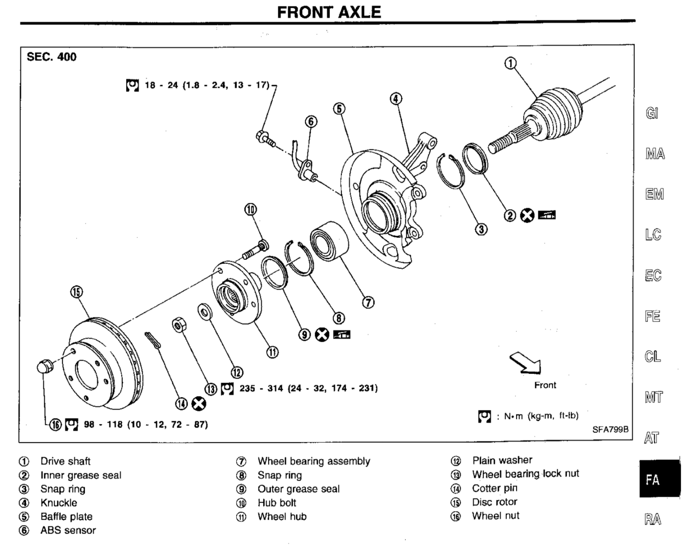

Yeah I'm feeling like a pretty big idiot at the moment:
Parts 3 and 8 are both snap rings, both of which are still in the freaking assembly. Ermahgerd I don't know how I botched this one so badly. Geez. Next time I think I'll actually look at the FSM for realz before I do this. Outta time tho, headed on the road tomorrow - probably need to find a shop to press it out tomorrow either way. The car is living in my friend's garage overnight. I also did not have wheel seals.
Can snap rings be reused if they're still springy?

Well Bubba.... I can call you that now that you live in Alabama.
In one of these threads you brought up doing this, I told you about the new bearings (NTK), Retainer Clips, Seals and Hubs, and the Hubs being the only thing you might be able to reuse. IOW, new other three parts. No acknowledgement. So I figured you were onboard. Of course there are retainer rings. How else would the bearings stay positioned in the knuckle? The guy in that video spoke of them. Musta been chowing on some Gumbo during that part, Eh?
Well, Mama always said.........
Now that you've beyond mangled the retainer clips pressing the bearings out without removing them, you better order some asap. OEM or Timken also makes them (same part numbers in and out). AND new Inner and outer seals (same part numbers in and out) Maybe you can return the press. LOL
