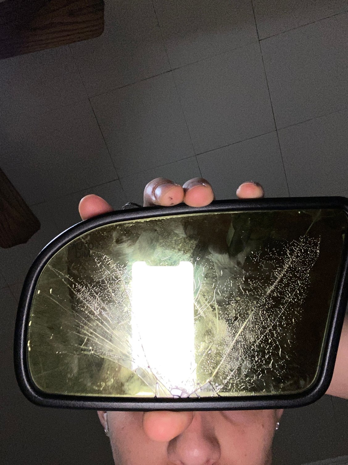

Tilt down mirrors and auto dim mirrors
Hello fellow Maximinions! Lol
So I have to replace the mirror that’s a part of my side view mirror assembly, and I can’t find an auto dim mirror besides the ones at Nissan which are almost 300$? I get that because of my auto dim feature they will be more expensive, but my question is, if I get a cheaper one that doesn’t have an auto dim feature, will it still have the ability to tilt down? Or do I have to pay the full price on my left side in order or to get that feature ?:/
Joseph Velez is offline

As far as I know auto dim and auto tilt are two separate features. One is controlled by a motor and the other works because of a chemical coating on the glass. Regular mirror glass will work with the auto tilt feature.
Richard66 is offline
Old 03-15-2021, 01:04 PM
Join Date: Feb 2002
Location: Southern California
Posts: 16,636
Just swap the mirror glass. Easy peasy.
