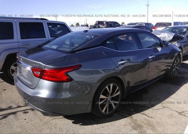

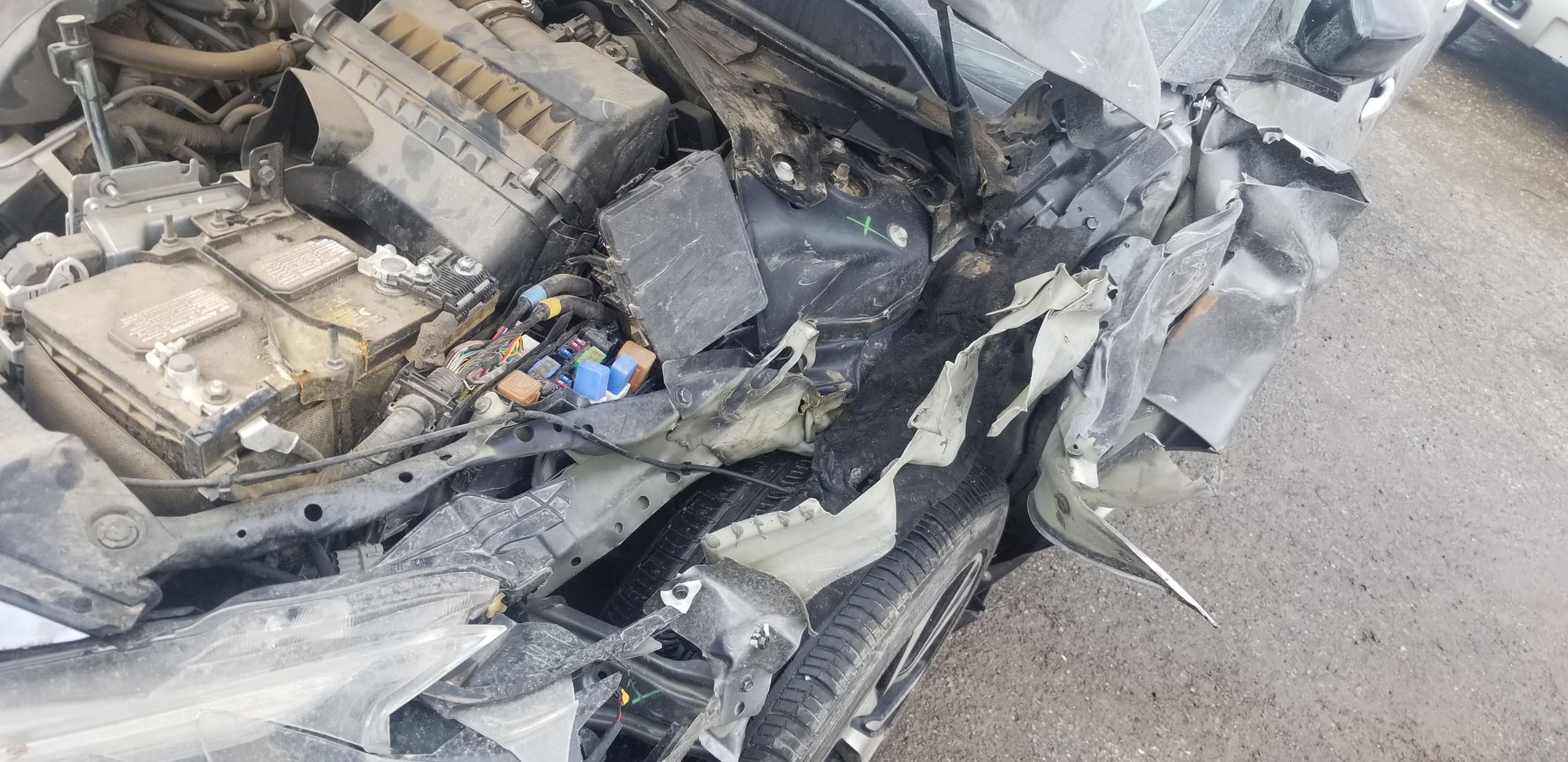

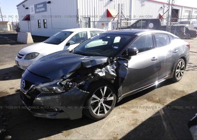

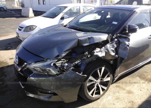

Hey guys so I recently purchased a 2017 Nissan Maxima Platinum from Auction. Here are the pics. Waiting for car to arrive.

That car was totaled????
wild willy is offline
Old 03-07-2019, 05:13 AM
Join Date: Feb 2019
Posts: 75
How much did you get it for? Damage doesnt look THAT bad

That's not really that hard of a whack^^^
Looks more like the vehicle went under a box truck or lift gate, then either pulled away or was deflected by the impact. It was high enough up, this could have been at any multitude of speed, 25-45 mph with or without braking attempt. This sort of localized clip really just riped up the exterior panels, and not actually absorbed a solid impact. Most important to note, the bumper cover is untouched for the most part, all impact was in the upper fender/hood. At least that's how I see it.
Thats what i was thinking. Looking at the images car was not in a serious accident

Could be some really bad frame damage you have not seen yet until you get it. They will salvage for that reason as well. Looks can be deceiving not looking bad.
FattiesGoneWild is offline
Old 03-07-2019, 10:39 PM
Super Moderator
Join Date: Feb 2002
Location: Southern California
Posts: 15,528
^This. Frame damage most likely. Usually on the auction sites it will give some sort of indication of why it's salvaged or for sale etc.

There's no traditional frame on these cars, and again, it's all damaged above the wheel, so the lower part of the car is likely untouched. There will likely be a few parts underneath that need to be replaced, the upper support that holds the fender essentially and header panel behind front lights, but probably more for reason that it will be impossible to get the fender and hood to lineup with just a repair. But welding on a new, or bolt on, not really sure what it looks like under there, it's likely going to be a quick turnaround. I'd love to hear the progress on this repair.

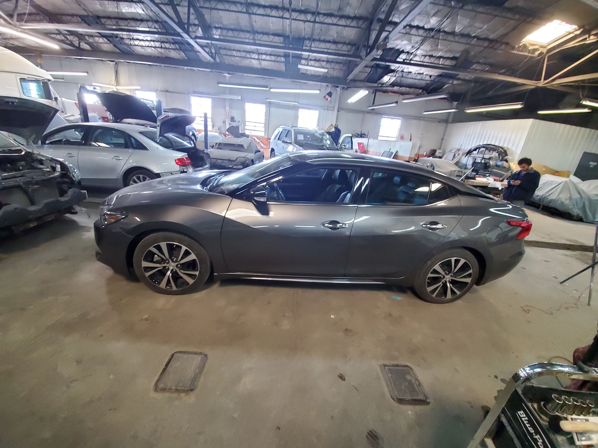

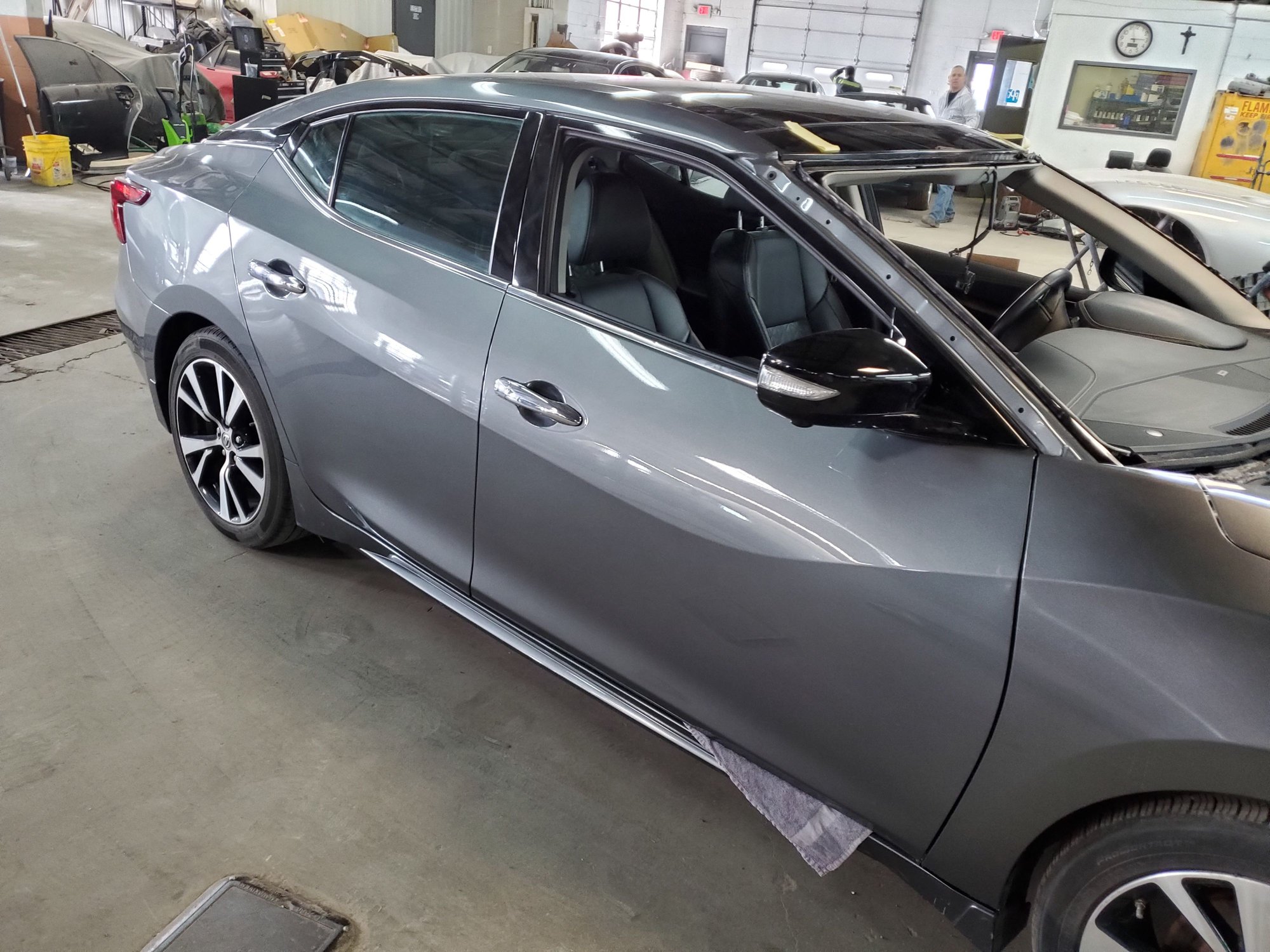

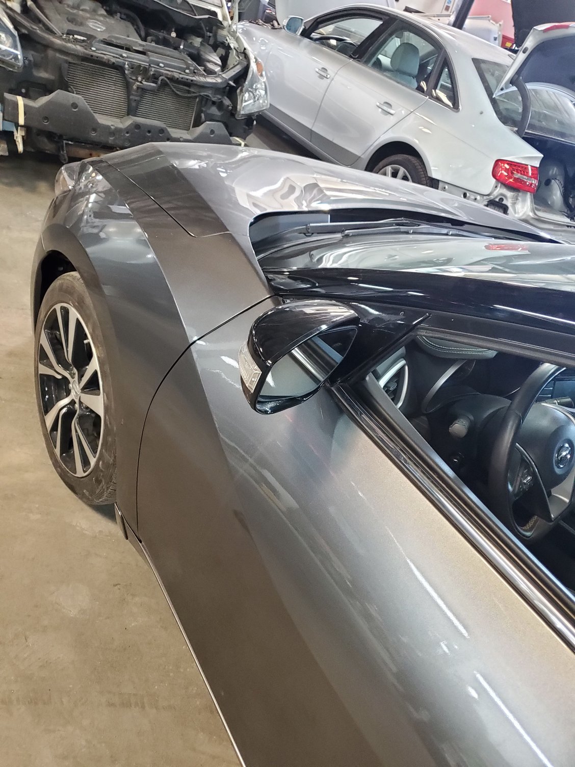

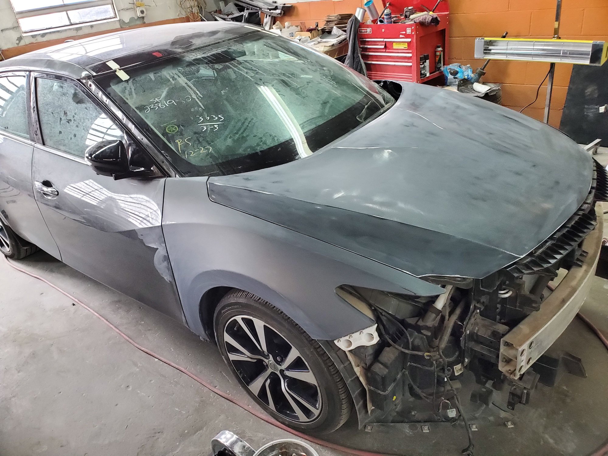

Old 04-09-2019, 09:05 PM
Join Date: Nov 2012
Location: Detroit
Posts: 34

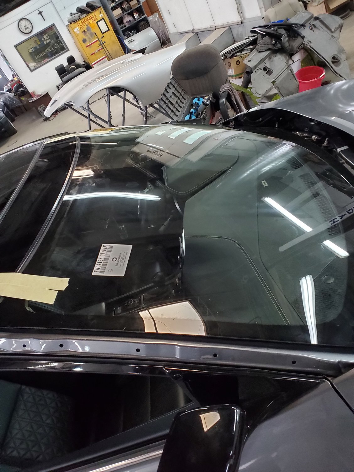

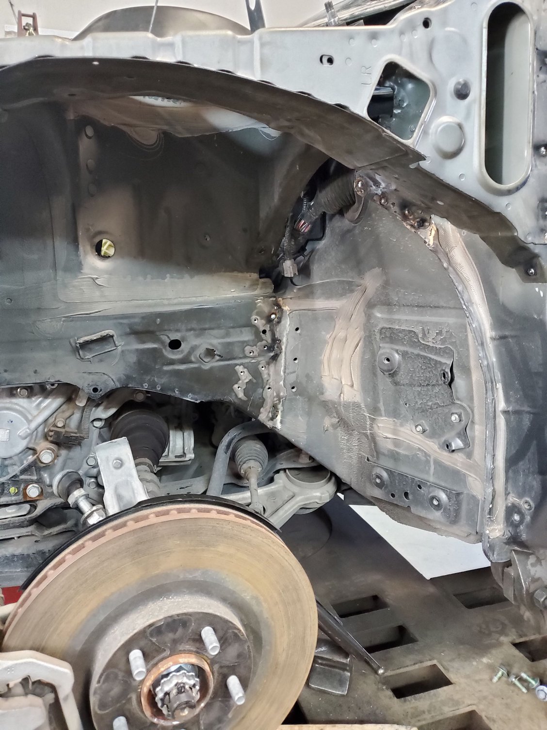

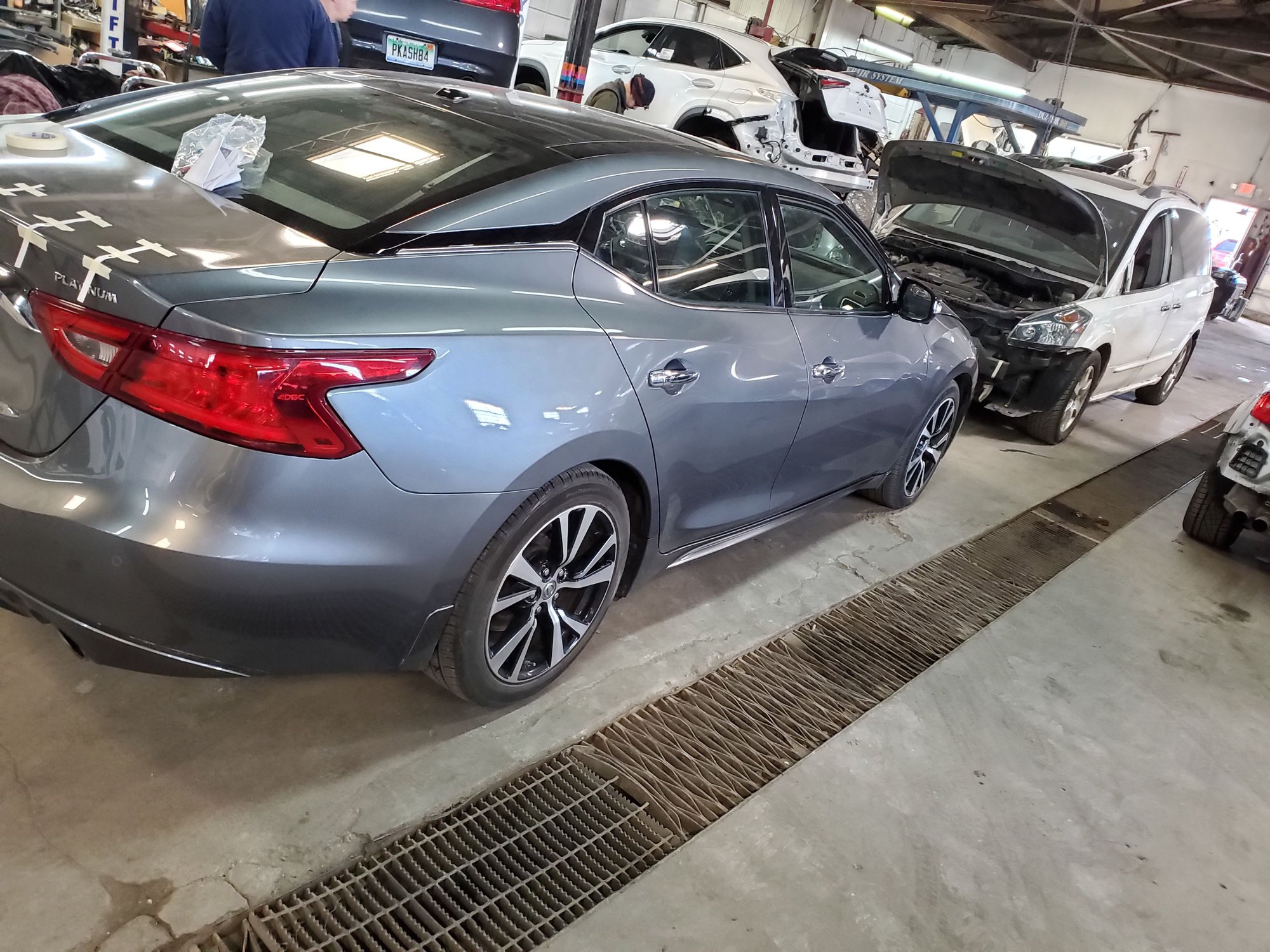

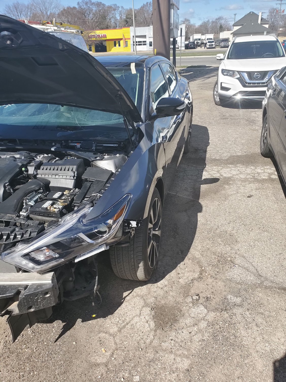

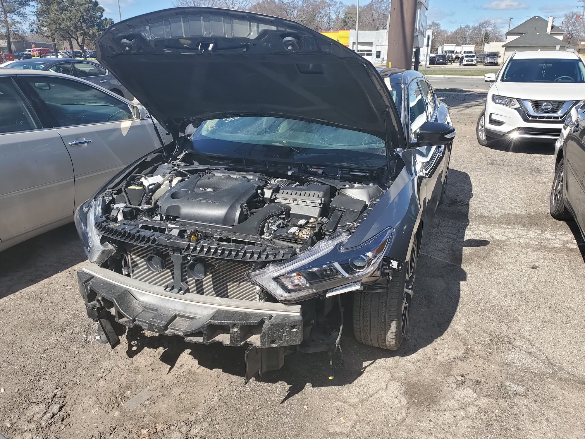

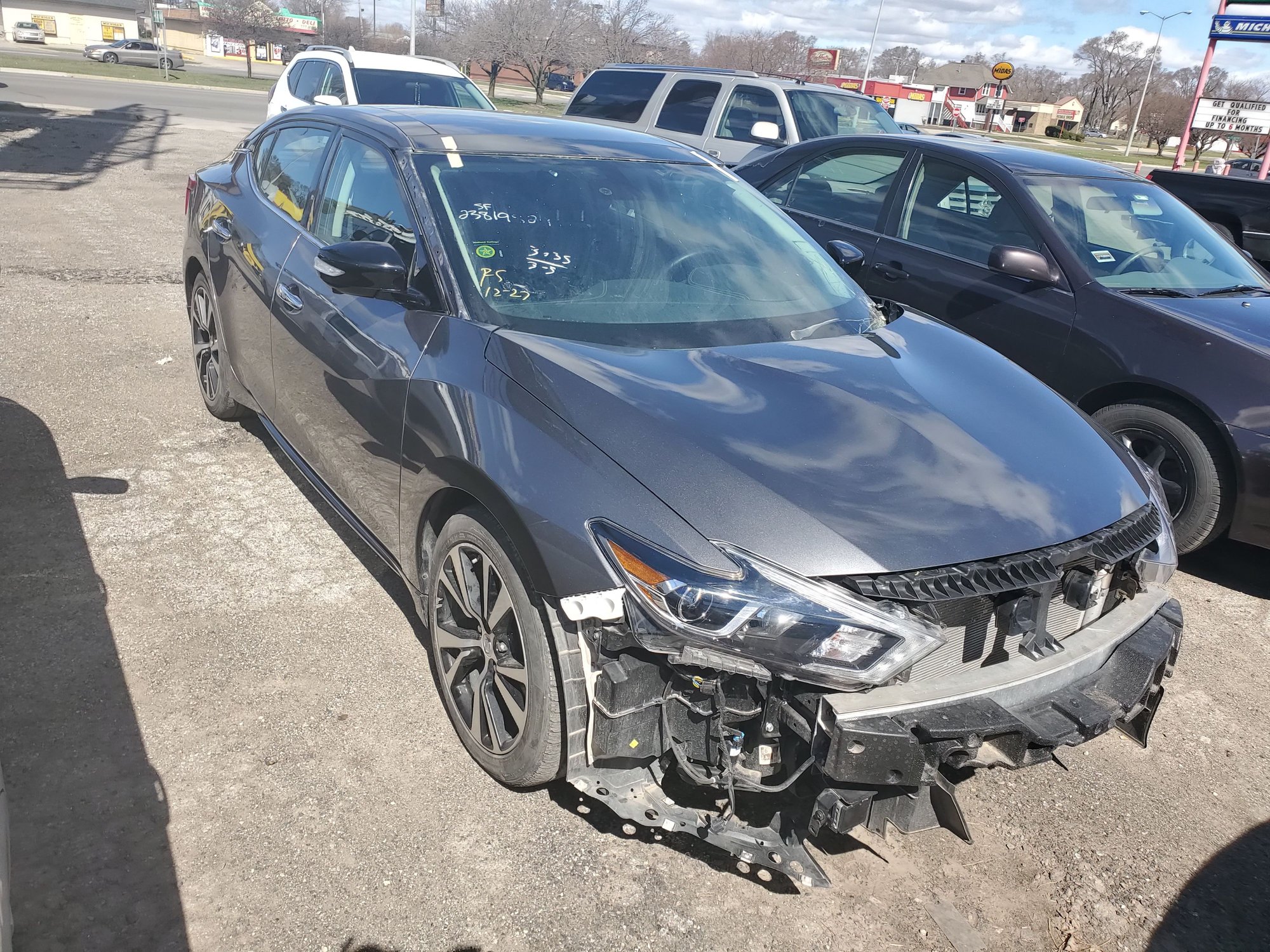

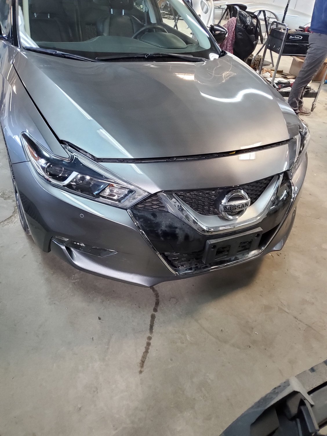

Hello Guys, Sorry for not updating everyone, I was on vacation. Here are some pics of before and after of the car. I bought a whole left Fender Apron, LH Fender (Aftermarket), Strut, Aftermarket Hood, and Aftermarket Headlight.
NissanLover13 is offline
Old 04-09-2019, 09:16 PM
Join Date: Nov 2012
Location: Detroit
Posts: 34
I took the vehicle to Eastside Imports located in Michigan. They did a great job with welding and putting the fender apron together.
Old 04-09-2019, 09:18 PM
Join Date: Nov 2012
Location: Detroit
Posts: 34
Very Professional work on their behalf
Old 04-10-2019, 03:38 AM
Join Date: Apr 2009
Posts: 1,954
Looking real good!

Honestly no surprises, I initially thought that the fender frame was going to be difficult and may have to tear apart the dash to weld the frame, but luckily I took it to skilled guys knew what they were doing and didn't have to do any inner removal of dash.
Majority of the parts I bought from a local parts store called Quality Auto Parts, they sell all sorts of aftermarket parts for vehicles. Parts were not expensive, the Frame for the fender I bought from a salvage yard for $580.
The left 2 doors had a small dent the size of a pencil, I had both doors fixed to match the fender and blend the right fender to match the front.

Old 04-10-2019, 05:27 PM
Join Date: Nov 2012
Location: Detroit
Posts: 34

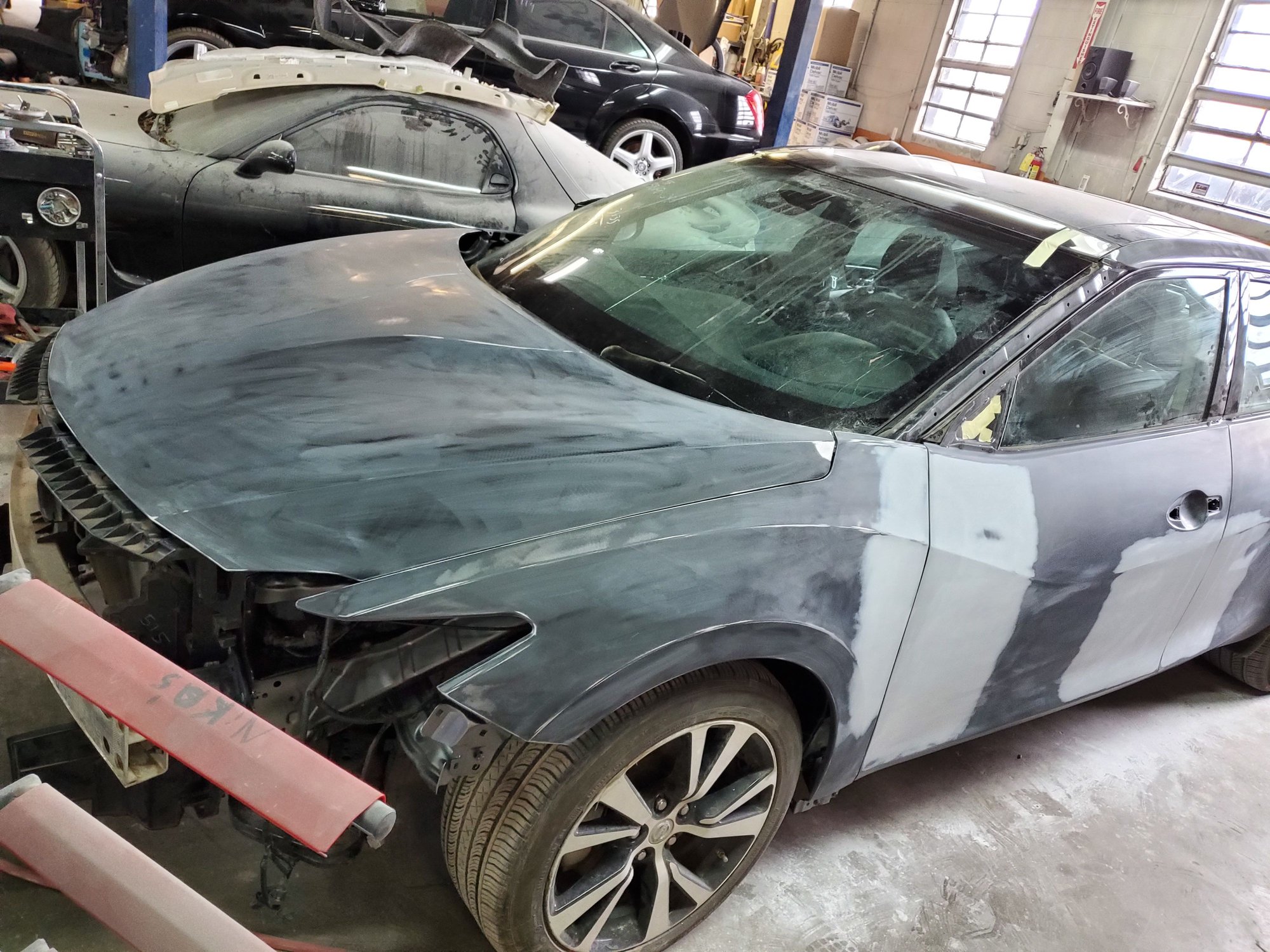

Please check out the pics posted

Old 04-11-2019, 11:39 AM
Join Date: Nov 2012
Location: Detroit
Posts: 34
Originally Posted by robtroxel View Post
Very shrewd shopping on your part and Thanks for the parts break-out list. We look forward to the finished product and your overall report when done. I was glad to see you had the frame/body checked and corrected to specs. The key here is a solid body shop with fair prices. Standing from afar, I would think the average Joe might spend lots more dough than you have to make this car right, hence the total loss price. All the best

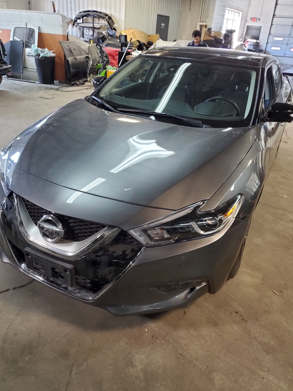

Very true. Here are the pics of the cat painted

All I can say is incredible! You have a great eye for picking just the right type of wreck to restore!
