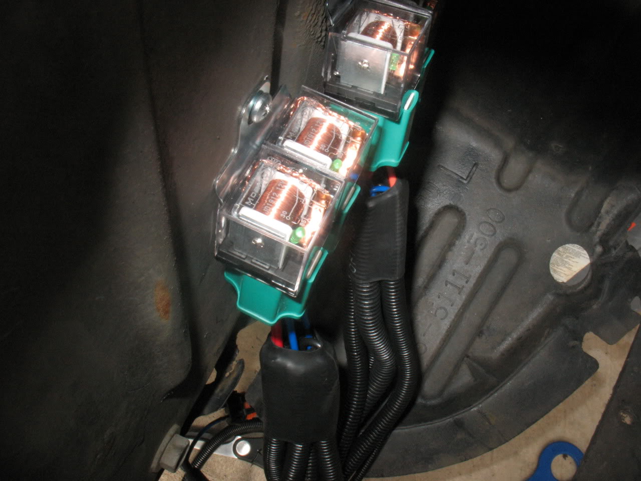

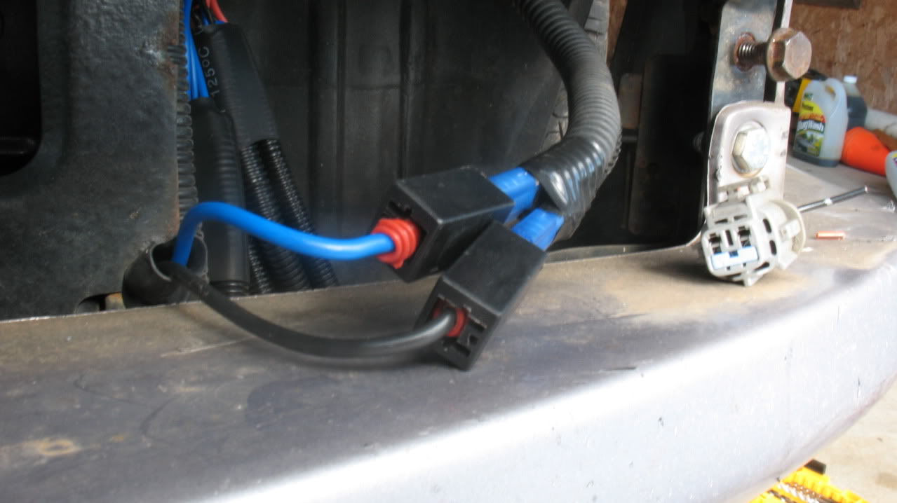

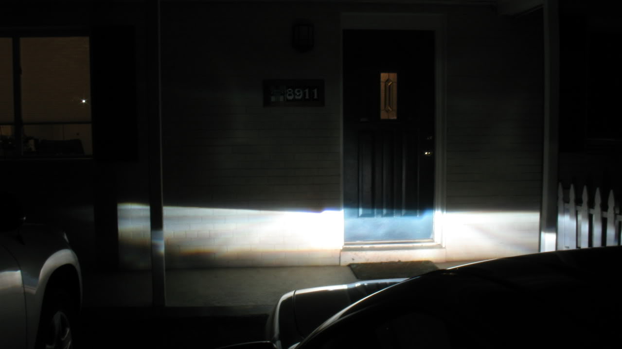

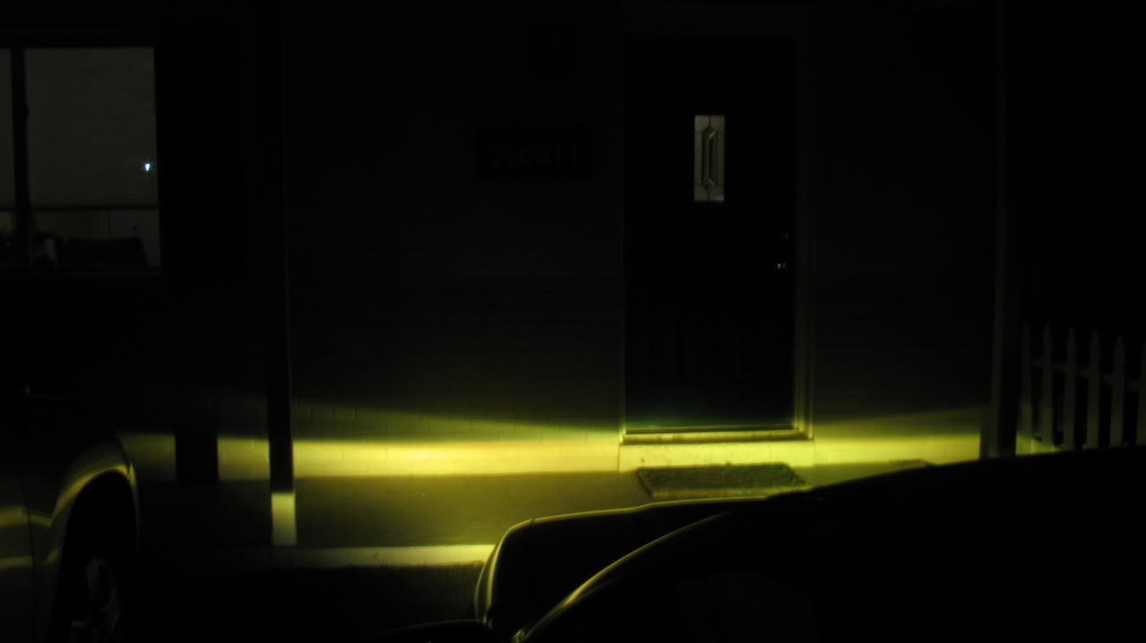

Headlights have never been the 4th gen’s strong suit, and they got much worse after installing non-OEM Cefiros. After baking in the sun for some eight years the plastic had started to fade, further reducing their measly output, so I decided to step up and get some real headlights in this car. I bought a new set of non-OEM Cefiros as well as new fog and corner lights, since my fogs had tons of rock chips and one of my corners was cracked.
I bought all my supplies from The Retrofit Source, and chose their FX-R kit with 4300 bulbs for the headlights and Blazers with 3000 bulbs for the fogs. I had ChrisMan287 do the retro work for me, and aside from the surrounds/bezels not turning out perfectly, I’m very pleased with how everything turned out. Chris also blacked out the rest of the Cefiros as well as the fogs and corners, and I think they look great together.
Attachment 53298
Attachment 53299
Patrick turned me on to TRS and their 25% off sale last fall and helped me with the install, but we ran into a few problems throughout the day. The first was the TRS had overnight shipped the wrong ballasts for the headlights, so while we were able to mount the relays and the fog ballasts, I had to wait to get the headlights working.
Attachment 53300
Attachment 53301
Attachment 53302
Attachment 53303

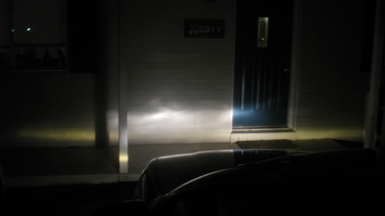

After the fogs were all wired up we tried to start them but had no luck. We checked all the connections, and even tried to see if the old stock bulbs would work, but somehow my fogs had just completely died. We checked the fuse; it was fine. On a whim I checked the fog relay and switched it with the corner light relay, and somehow that got the fogs to work (and the corners kept working as well). Due to the fogs having to go through the glass in the projector as well as the glass housing for the fog, the light output isn’t quite as yellow as I had hoped for, and the cutout isn’t 100% perfect, but it’s such an improvement over stock that I really shouldn’t complain. I think the fogs are also turning more yellow as I drive them more, so that’s a good thing.

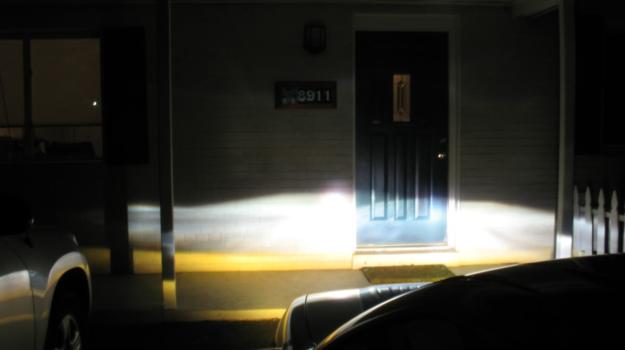

I finally got the new ballasts from TRS and got them wired up with the new headlights and have been blown away by their output. I still need to get them aimed properly, but the light in front of my car is comparable to driving in the middle of the day. It’s quite ridiculous. This whole ordeal wasn’t cheap, but I think it looks great and has greatly increased my safety and confidence while driving at night. I still need to fine tune their aim, as the pictures will demonstrate, but you get the idea. Try to ignore the dust on the lens of the camera, because I can't find a way to get rid of it (old Canon A630).
Attachment 53304
Attachment 53305
Attachment 53306
Attachment 53307
Low beams only
Attachment 53308
Low beams and fogs
Attachment 53309
High beams and fogs
Attachment 53310
Fogs only

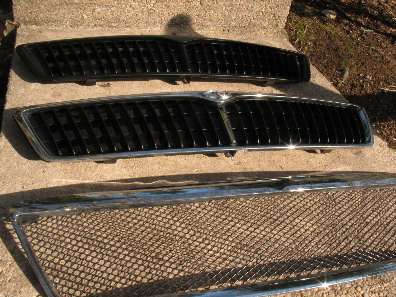

Grilles
6 Attachment(s)

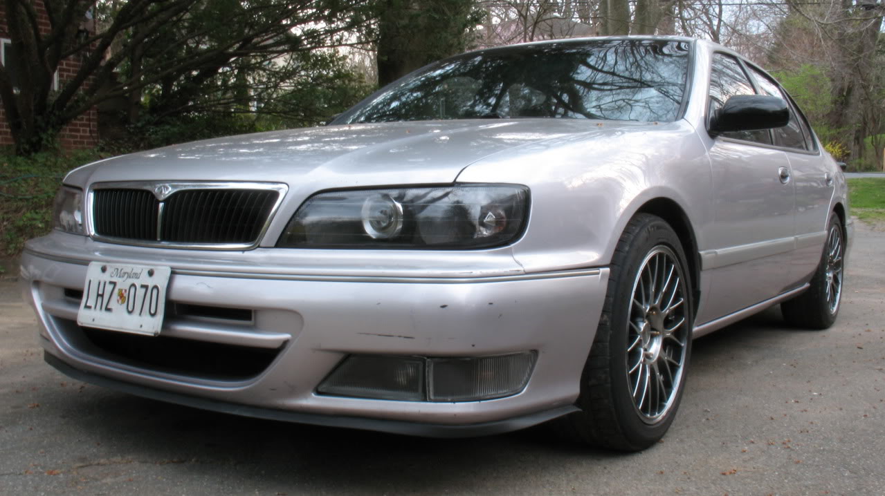

I’ve fooled around with different grilles over the years. After lots of back and forth I’m pretty sure my favorite is still the stock grille with the vertical slats painted black. Which is your favorite?
Attachment 53291

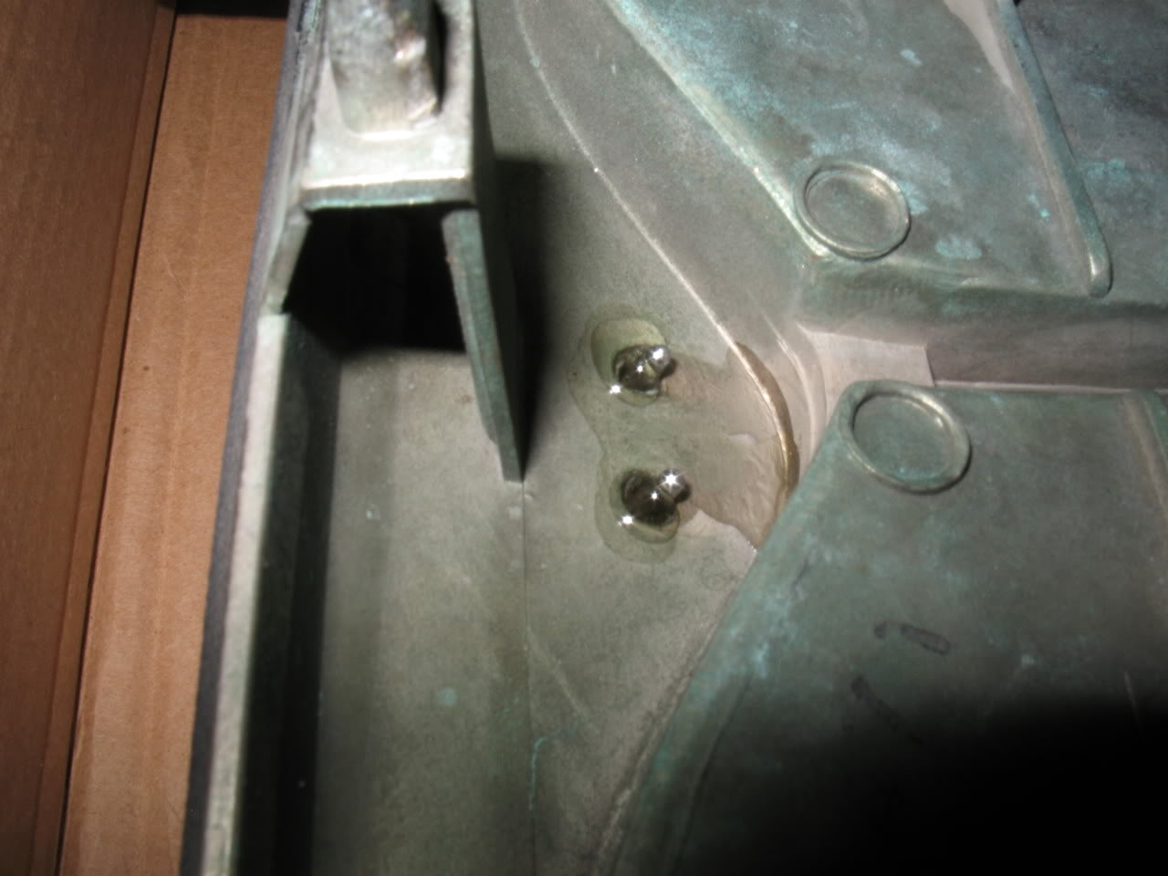

One day last fall I was cruising around when I noticed something small and silver fly up and hit my windshield. I had no idea what it was and didn’t really care since my windshield was fine. A few days later I was working on the car and realized the Infiniti emblem on the grill had fallen off, and was the UFO that struck my windshield. The sad part is that I was only going 35 mph when it happened :laugh: Now of course, you can’t just go and buy this emblem at the dealership, oh no. You need to buy a new grille. Did I mention the 'chrome' looked a little tired?
Attachment 53292
I did some searching around and found a used one for sale and picked it up. When I installed it, I was reminded of why I had blacked out the vertical bars on my earlier grilles. It might look ok on a stock car, but on my car with black accents everywhere, the stock chrome just looked awful. Thankfully, the 'chrome' looked almost new.
Attachment 53293
So I did my annual routine of sanding down and repainting the grill, except this year I actually tried to do a good job of taping off edges and the results are pretty good IMO. I then took the preventative step of rubber cementing the emblem on from the rear so I doesn’t try to leave me again. I think it’s a reoccurring problem as another grill I picked up was already missing it!
Attachment 53294
Attachment 53295
Attachment 53296

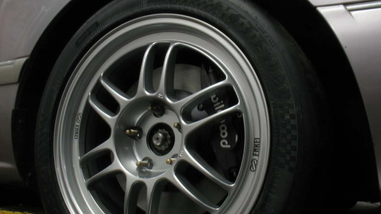

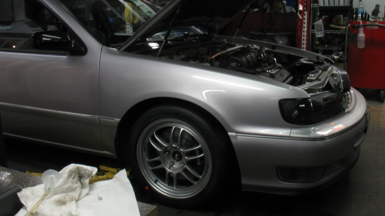

Enkei RPF1s and Hoosier A6s
9 Attachment(s)
When I decided I was going to step up and get some Hoosiers for this season, I had some catching up to do in terms of what size I could fit and the best offset for track wheels. I talked a lot with Joe (98SEBlackMax) and Joe at 2JRacing and ended up with some 245/40/17 Hoosier A6s. A6 sizes in 17” diameters are somewhat limited, so my choices were 225, 245 or 275. I went with the 245 because I was pretty sure they would fit in the wheel wells, even though the Hoosiers run very wide for their indicated size. After discussing my purchase with Brian, it sounds like the 225 might have been a better idea to run in the rear to help the car rotate, but it’s too late now and I will run the square setup for this season. Maybe next season I will try a 275f 225r setup :D
245/40/17 Hoosiers on left and 235/45/17 Michelin PS2 on right
Attachment 53282
Attachment 53283
Next up was choosing the right wheel. I’ve always loved the Enkei RPF1, but could never really afford them. At first, I wanted a 16” wheel/tire combo to save weight/money, but trying to fit a BBK under 16” wheels just wasn’t going to happen, so I stayed with the 17s. I know people have fit 9” wheels in a 4th gen, but the sales rep at Hoosier said an 8.5” wheel is perfect for the 245, so I went with a 17x8.5 RPF1. After some discussion with King at Enkei NA, I was able to secure a grassroots sponsorship and got a great price on the wheels!
I also had to choose between a +40 and +30 offset, and got conflicting opinions for various people. I already have my rear fenders rolled, but was wary of the front Hoosiers sticking out too far and getting chewed up by the front fenders when the suspension compressed. However, I was also nervous about rubbing the soon-to-be coilovers. In the end, I played it safe and went with the +40, because you can always space your wheels out, but you can never bring them back in! Luckily, the +40/Hoosiers even clear my Koni/Eibach setup, so I know they will be great with the BCs! Depending on how low the BCs get set, I may get some 5-10mm spacers to widen things up, but that can be decided later.
Attachment 53284
Attachment 53285
Attachment 53286
They even clear the stock-style Eibach springs!
Attachment 53287
Attachment 53288
Attachment 53289
Attachment 53290

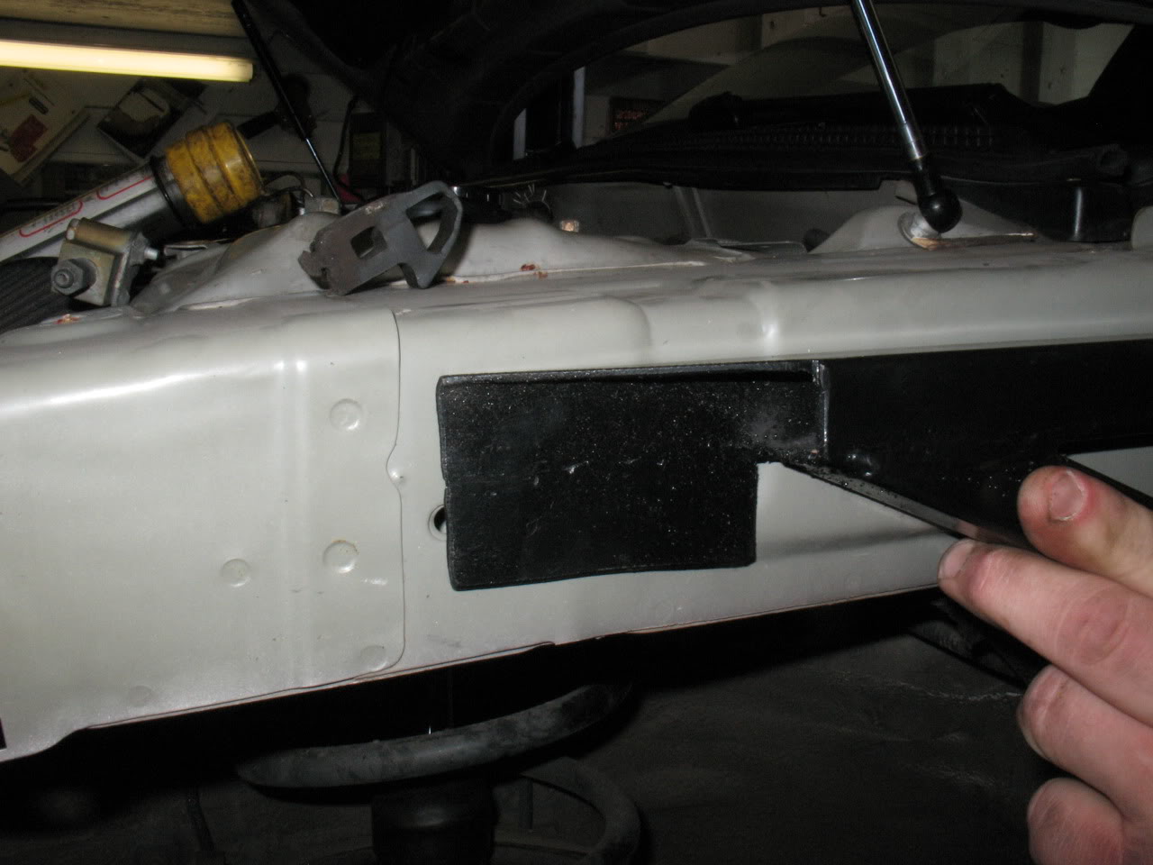

LTB effects
2 Attachment(s)
Ever since I started being somewhat serious about autocrossing my car, I’ve been annoyed with the steering response. This was magnified by driving my friend’s 97 SE (oTranscendental). We both were on stock-style shocks and lowering springs, but I had a LTB and SFCs and he didn’t. For the longest time I couldn’t figure out why his car had so much quicker steering. Heck, the first time I autocrossed with it I knocked over a couple cones in the slalom because I wasn’t expecting it to turn in so quickly. I wanted his steering badly.
The first step was to replace my steering rack with one from a 97-99 SE, since those racks are a little quicker than the one in all 95/96 and 97-99 non-SE cars. I installed a remanufactured rack and got some improvement, but it still wasn’t as quick as Darius’ car. His car was unfortunately in an accident and was totaled, but luckily he was unhurt (somehow!), and I was able to snag his steering rack before the car went to the junkyard! I felt an improvement over the reman rack, but something was still missing.
I had pretty much given up on having quick steering (even the 350mm Sparco wheel didn’t help very much), when I had to take off the LTB to get the headers to fit. Voila! All of a sudden I had the quick steering I had always desired! I realized that while the LTB had provided stability to the front end, that stability hampered response. I suppose it’s somewhat of an inverse relationship. I still have the LTB and am considering making it a stage 1 bar and seeing what that does, but for right now I’m leaving it off and seeing how the car behaves at the first couple events.

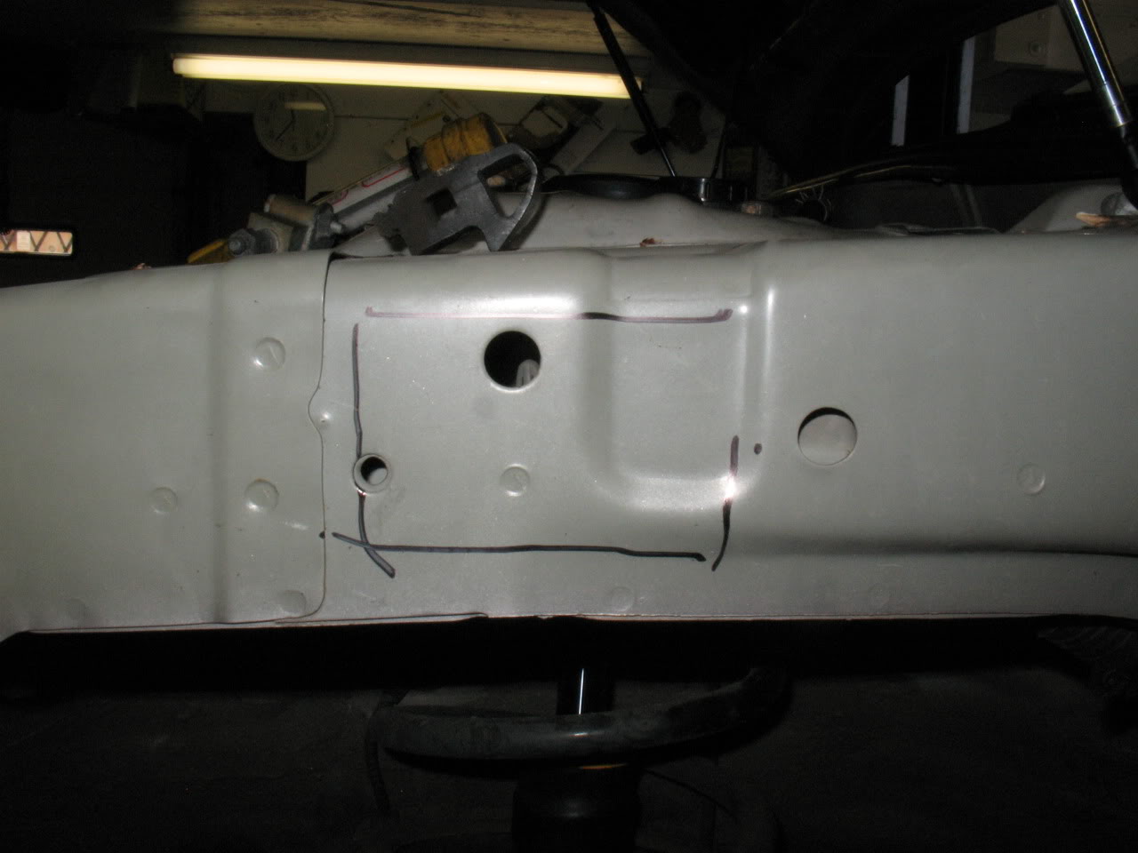

By removing the LTB, I was able to reinstall the OEM chassis plates (for lack of a better description) and install the last two delrin subframe spacers. You can see that the only way to use the chassis plates with the delrin subframe collars is to space out the plates with washers. I can’t say what installing these did, as the car changed so much by removing the LTB, but it’s nice to know they’re on the car.
Attachment 53280
Attachment 53281

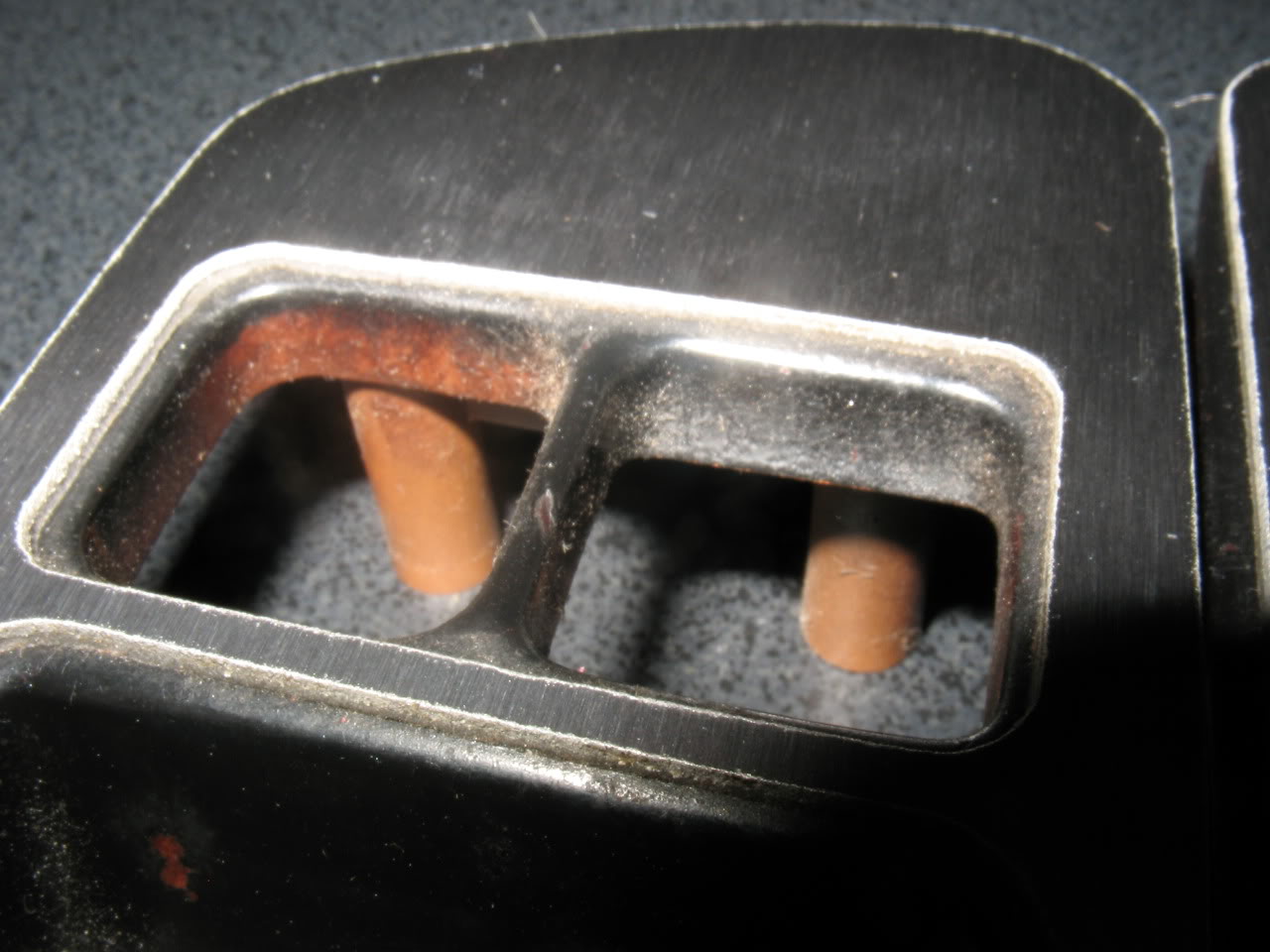

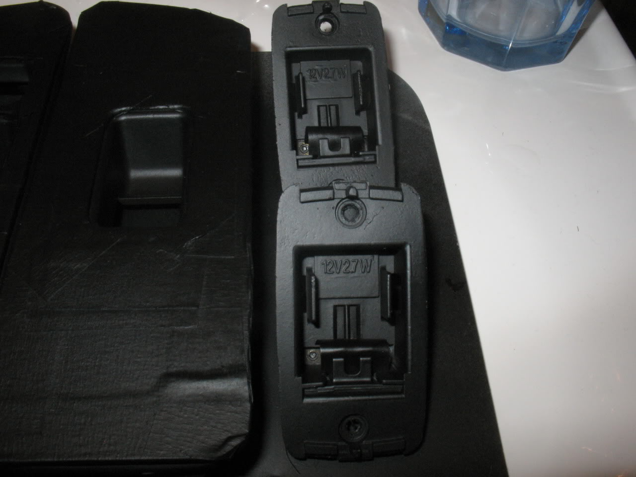

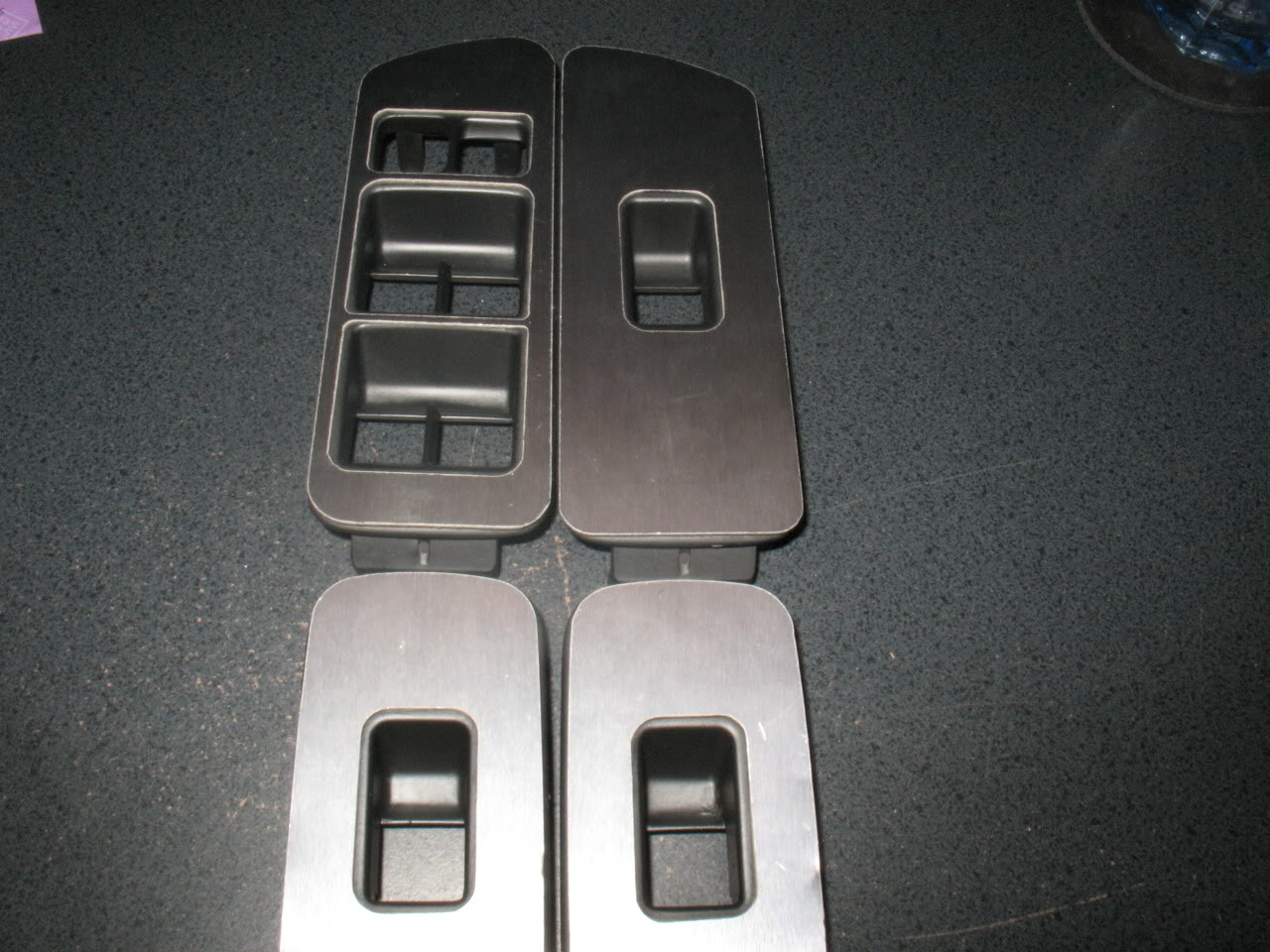

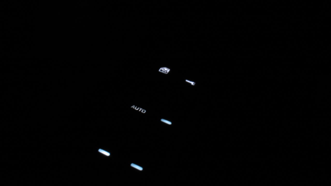

Window switches
12 Attachment(s)
When I first installed my aluminum dash kit, I was in a rush to get to the annual DC Maxima BBQ and IIRC also had a massive alcohol-induced headache. As such, the results of painting over my “wood” grain dash weren’t perfect, and after some eight years the paint had worn away in some spots and just generally looked sh!tty. While I had my door switches out for the LED work, I decided it would be a good time to revive my window switches. Since I wasn’t comfortable removing and reinstalling the thin aluminum (pretty sure I would have bent the crap out of it), I decided to paint around it. This was much harder than it sounds. Painting off all the edges of the trim took forever, and sanding it wasn’t very easy either. Thankfully, all the prep work paid off and the results are great. I also decided to black out the housings for the door lights while I was at it.
Attachment 53268
Attachment 53269
Attachment 53270
After sanding and rubbing alcohol:
Attachment 53271
Attachment 53272
And after painting:
Attachment 53273
Attachment 53274
Attachment 53275

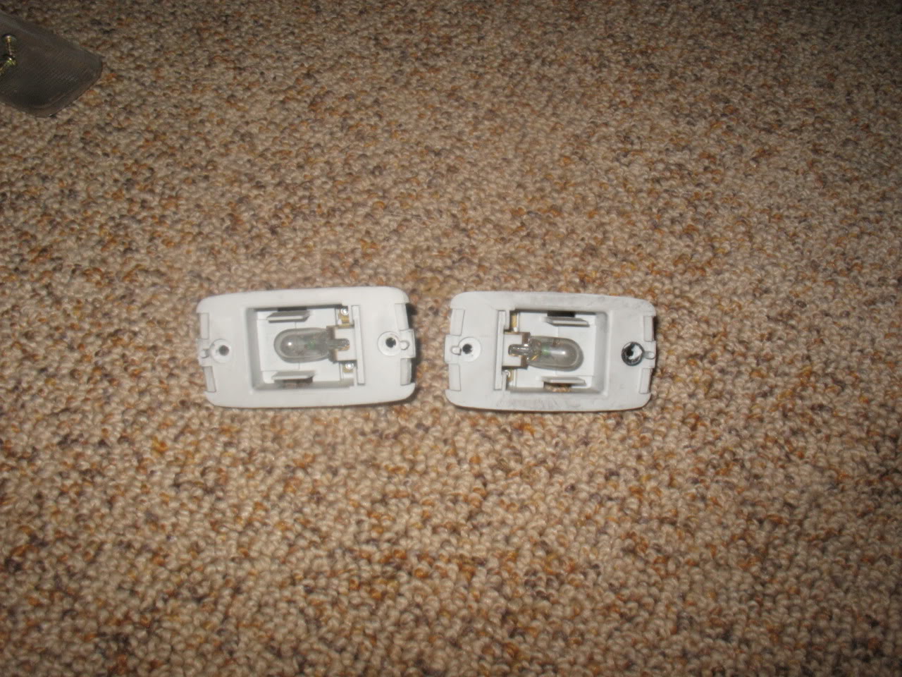

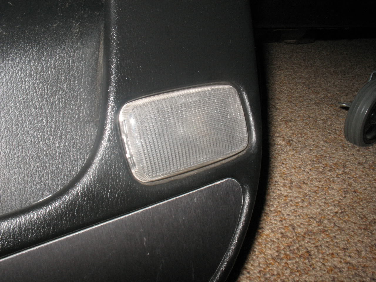

Door light before:
Attachment 53276
Door light after:
Attachment 53277
Before:
Attachment 53278
After:
Attachment 53279

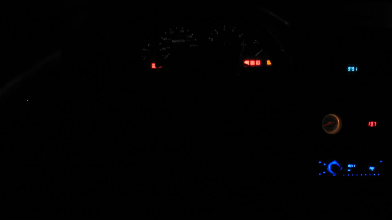

The LED overhaul was done by Matt (TunerMaxima3000). Most of the lights in my climate control had died, and I’ve been tired of that pale green of the stock bulbs, so I figured it would be a good time to upgrade and make everything match. All LEDs are white, although some appear bluish in pictures. I had red LEDs installed as the indicators for the front defrost, rear defrost and re-circulate buttons. Both the clock and ACC display are now white as well.
Before: (95/96 Maxima SE stock gauges)
Attachment 53262
After:
Attachment 53263
Before:
Attachment 53264
After:
Attachment 53265
Before:
Attachment 53266
After:
Attachment 53267
You can see that none of the lights for the ACC were working before, and now they all do! It's so nice to not have to guess which button I'm pressing at night. BTW, the door picture is a more accurate representation of the color of the LEDs than the gauge cluster picture.
We ran into problems during the process, mostly involving window switches no longer working and a hazard light that no longer engages after the installation of LEDs, but Matt has made an effort to get everything fixed for me. It has taken longer than I had hoped, but I think the results are worth it. I also wanted my turn signals and key ring to light up red, but after numerous different LEDs/turn signal housings/key ring harness, none of the LEDs work and now both key ring harnesses (I bought a spare to see if my stock one was the dead part) don’t work, so I’ve pretty much given up on those. The turn signals are still the stock green and the key ring doesn’t light up at all. At least it’s better than green ;)
BTW, that green display is my Techtom MDM-100. I usually have the top line displaying my speed in MPH since the small diameter Sparco wheel blocks most of my speedo and tach, but I've been monitoring IAT lately in preparation for another project :)

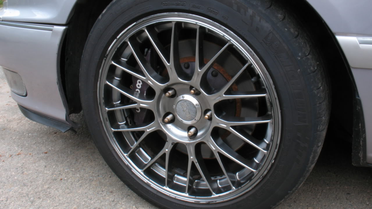

Wilwood 12.6" 2-piece rotors
1 Attachment(s)
I had installed my Cobra/Q45 brake setup around 2006 and was pleased with the results. I noticed improved pedal feel and much more resistance to fading. Even with Hawk HPS pads, they survived 20 minutes of WOT around Summit Point’s main circuit, hitting speeds up to 120 mph. Sure, there was fade by the end of the session and the pads were glazed over for the drive home, but all things considered, they held up remarkably well.
However, last year I really began to notice problems braking from low speeds. The ABS seemed to be overly active and the car always felt like it was on the verge of locking up. This sensation was made even clearer at the last BMW auto-x of the season in 2011. It was around freezing and was raining/sleeting pretty badly. We took some fun runs after we were done and I drove my buddy’s stock BMW 330 with the sport package. We are both on similar tires with same amounts of tread.
At the end of the course there was a section of heavy braking from about 30-40 mph. When we did this in my car, the brakes half locked up and my car skidded to a stop in something like 100 feet. The whole time the pedal was kicking ABS feedback at me and not really stopping the car. I then hopped in his car and did the same thing and the car just stopped like it was dry out. No ABS intervention, no drama, just a quick hard stop. I was blown away. His car stopped in less than half the distance my car took. I needed brakes like that.
It was then I decided I needed to get a real BBK on my car. I wasn’t yet sure if there was a problem with the Q45 calipers, or if this was normal for them, or if there was something amiss with the ABS system not getting along with the bigger setup. I knew that Wilwoods would be the only setup I could afford, and the only vendor I could find was FastBrakes, so I ordered their 12.9” 2-piece rotor kit with Superlite calipers. I initially thought about getting their 12.2” 2-piece rotors and Dynalite calipers to fit under 16” wheels, but it sounded like that just wasn’t enough material on the rotors to resist fade, so I went with the normal setup to fit under 17s. Just before they shipped, I found my buddy Albert selling his used 12.6” 2-piece Wilwood setup (from Josh’s old 5th gen) for a great price, so I picked them up off him and paid the restocking fee at FB.
The installation drama that ensued can be viewed here
It turns out both of my rear calipers had seized (A1 Cardone calipers suck!!), so I got some new rebuilt WBR calipers. These seemed to be nicer than the Cardones, and it’s nice to have a functioning e-brake again.
Attachment 53261
After doing some thinking, I believe there’s a good chance that part of my earlier braking problems (and also current) are attributable to a bad front brake bias. It probably didn’t help that my rear calipers were locked up, but even now that they’re working my braking doesn’t blow me away. Yes, the pedal feel is much improved over the Q45/Cobra setup, but I don’t think my stopping distance has really changed much at all. Enter the rear BBK........

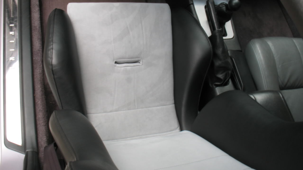

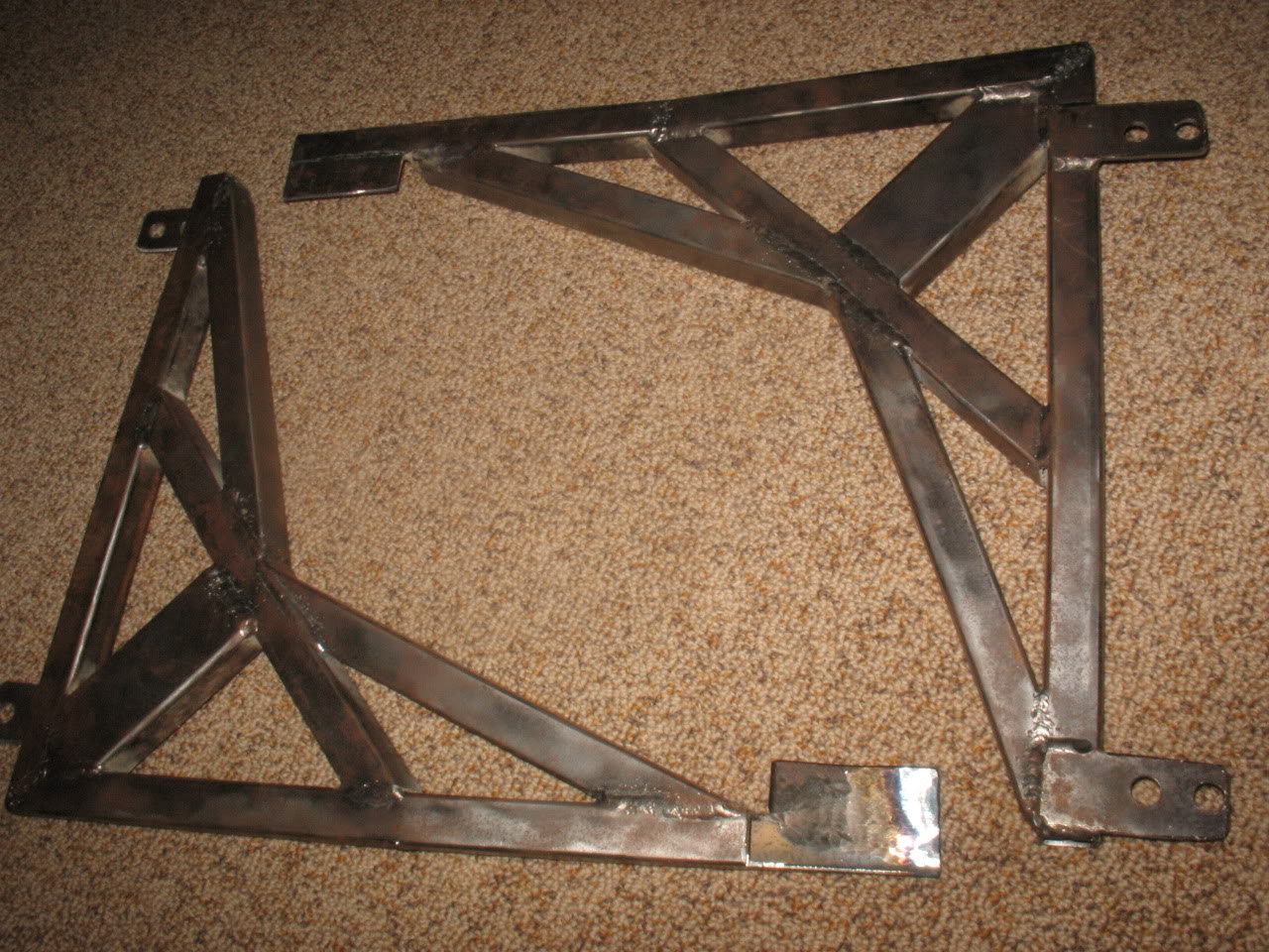

Recaro Speed seat
4 Attachment(s)
The seats in 4th gens are pretty terrible at holding you in place during hard driving, especially if they’re leather. After two days of SCCA driving schools my left knee was bruised from supporting my body against my door during hard turns. A CG Lock was a big help in keeping my torso in one place, but my extremities were still flopping all over the place when driving the car hard. Not to mention that when coming to a stop I could feel the seat rocking forward (maybe ¼”) then back when I was fully stopped. This was not a pleasant sensation, and from what I understand it’s not uncommon with Nissans. Still, for being some 17 years old, the stock seat was in remarkably good condition.
Enter the racing seat. I looked at Sparco, Recaro and Corbeau seats and found a couple that I thought looked promising on their websites. Actually sitting in the seats was a little more complicated. There are only one or two dealers for each vendor in the entire DC area, so one day I drove around to three shops and sat in all the seats.
First was the Recaro dealer, who happened to be a few miles from my house. The seat I initially thought I wanted (Sport Topline) wasn’t aggressive enough to justify its massive price. They did have a much more aggressive seat on display (the Speed), and it was somehow more comfortable than the other seat, but it was still expensive.
Next was Sparco. IIRC, they only had one or two reclining seats available, and neither was comfortable. I felt like the padding wasn’t in the right place and my thighs were pinched.
I then sat in three Corbeaus, but none of them were right. One felt cheap, one felt like you were sitting on the seat, rather than in it, and the other just wasn’t comfortable. I’m not a big guy (5’ 10”, ~160 pounds), so my size shouldn’t have been a limiting factor.
I then went back to sit in the aggressive Recaro Speed, and low and behold, it fit like a glove. I don’t know how the most aggressive seat I sat in was the most comfortable, but I wasn’t going to argue. I chose the black leather/gray suede option and waited the 4-6 weeks for it to show up.
Attachment 53257
The install wasn’t terrible, but the seat bracket was a very tight fit and I had to start the rear two bolts first, otherwise it wouldn’t line up properly. Going for a drive was a revelation; I could actually feel what the suspension was doing instead of being thrown half way across my car! Now I can go as fast as I like and remain calm and in control. I don’t have to have a death grip on the wheel or use my left knee as a brace against the door. It’s simply incredible. However, if any part of your body is much bigger than mine, this seat probably won’t be right for you. The biggest complaint friends have had is that the seat is too tight in the hip area. Now I’m kind of glad I didn’t buy two of them, because aside from breaking the bank, my passengers would all be riding in the back seat!

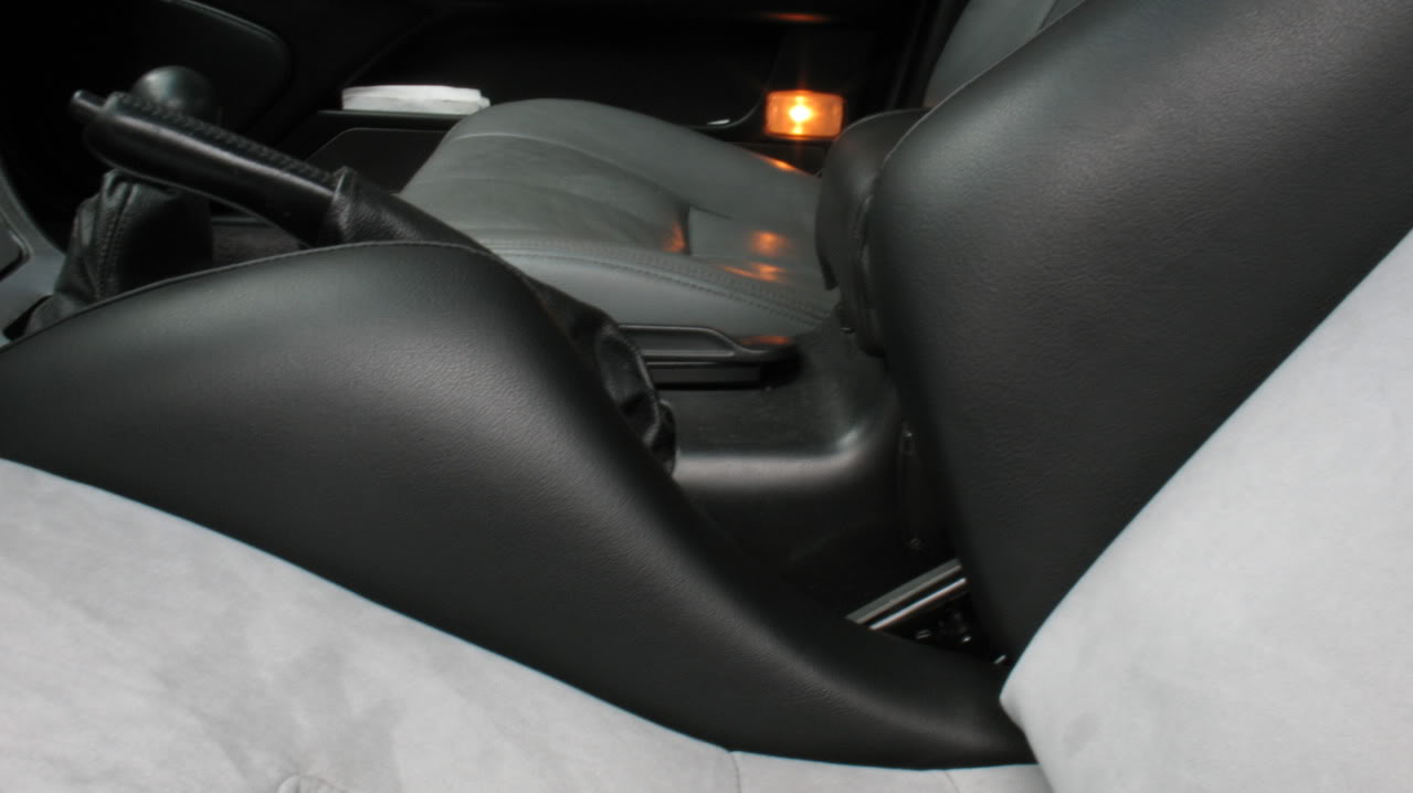

After a couple weeks with the new seat, I can honestly say there hasn't been an uncomfortable moment yet. I'm still blown away by the amount of support I have and by how much more fun and engaging the car is to drive. Between the seat and the CG Lock, I really don't think I need a 5-point harness! :o :wall:

the seat is pimp. on the grille's, i think if you paint the middle chrome strip that goes from the infiniti emblem to the bottom of the grille black would look good

Anyways I am surprised the Recaro Speed seats fit the A32 interior so well, I was about to pull the trigger on a pair of those a few years ago. Luckily I did not because my fat a$$ doesn't fit in those seats. But at least I know the dimensions and so now I can figure out what will work in a A32 interior. HMS Motorsports in Peabody has an amazing showroom with dozens of race seats setup for customers to try out. I found those Recaros do not work for me but the Cobra Imola GT seats fit nicely. :)
You might want to at least try a four point harness. If I upgrade to a 5 point I can send you the old four point harness I currently have if you want. I do not recall if you tried it when you drove my car but it made a huge difference for me compared to the CamLocks.

I prefer the OEM grill as well. I tired all the variants mesh, cefiro sport, cefiro brougham or something VIP style(terrible), but OEM ftw.

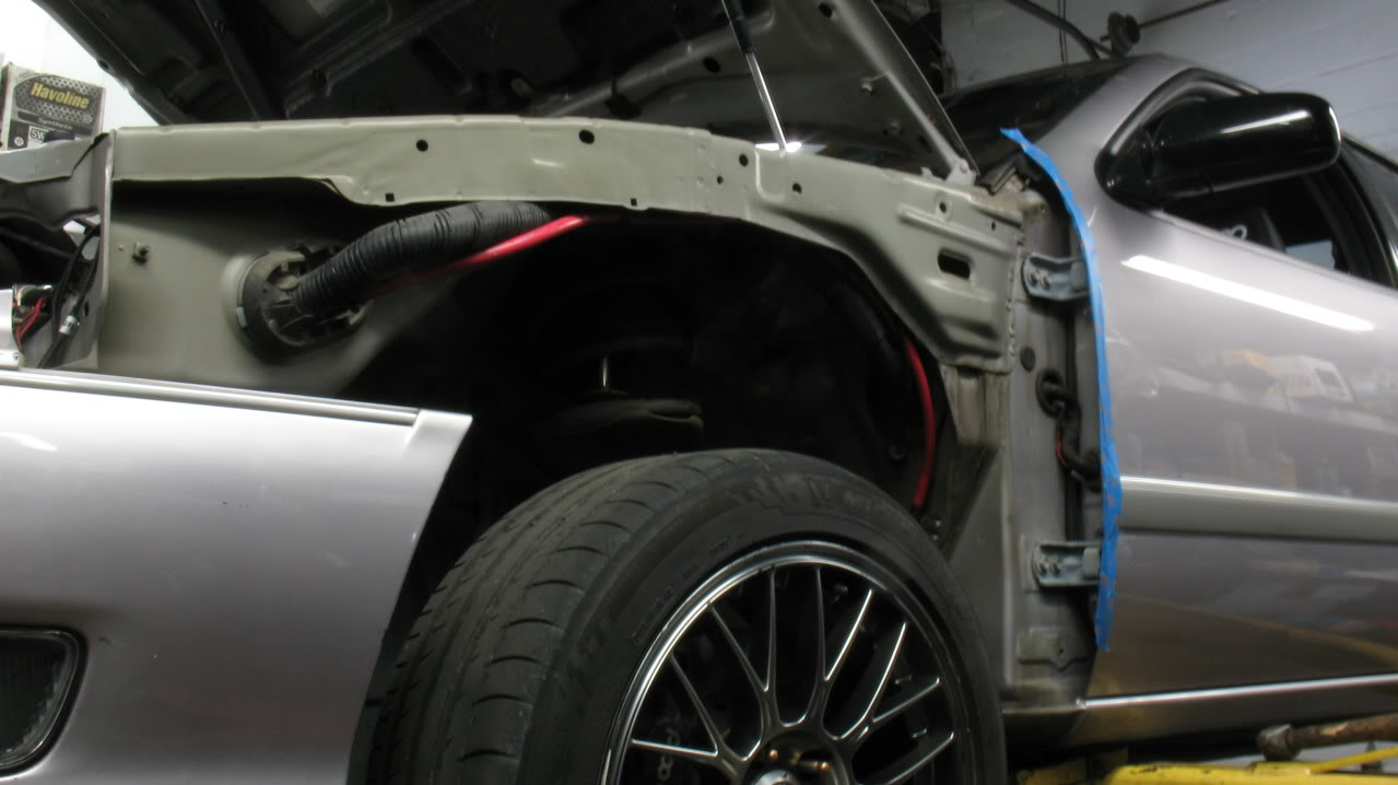

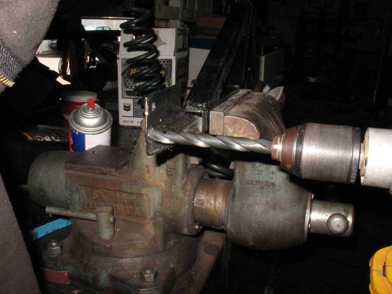

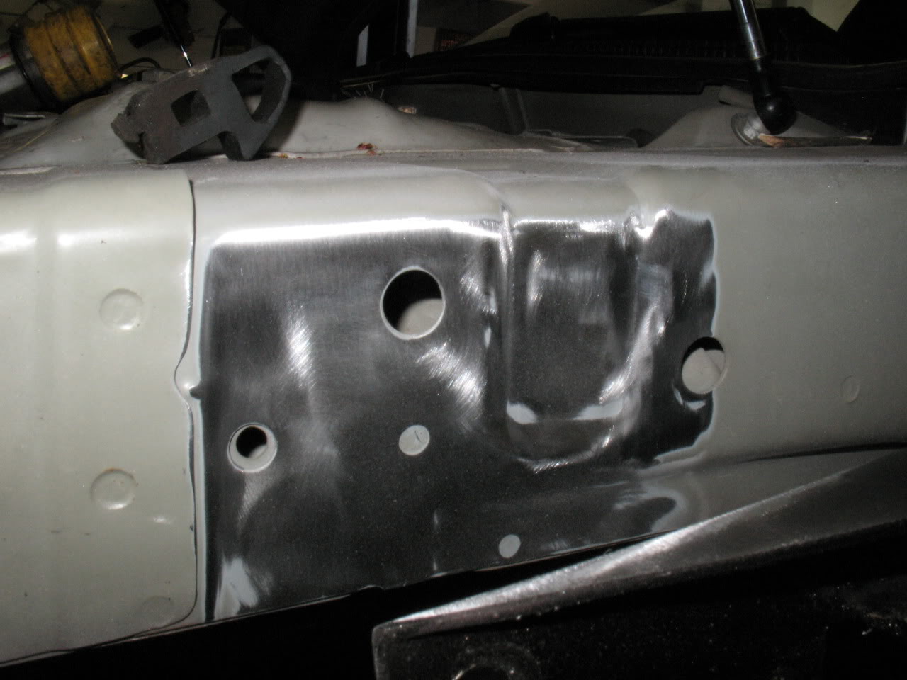

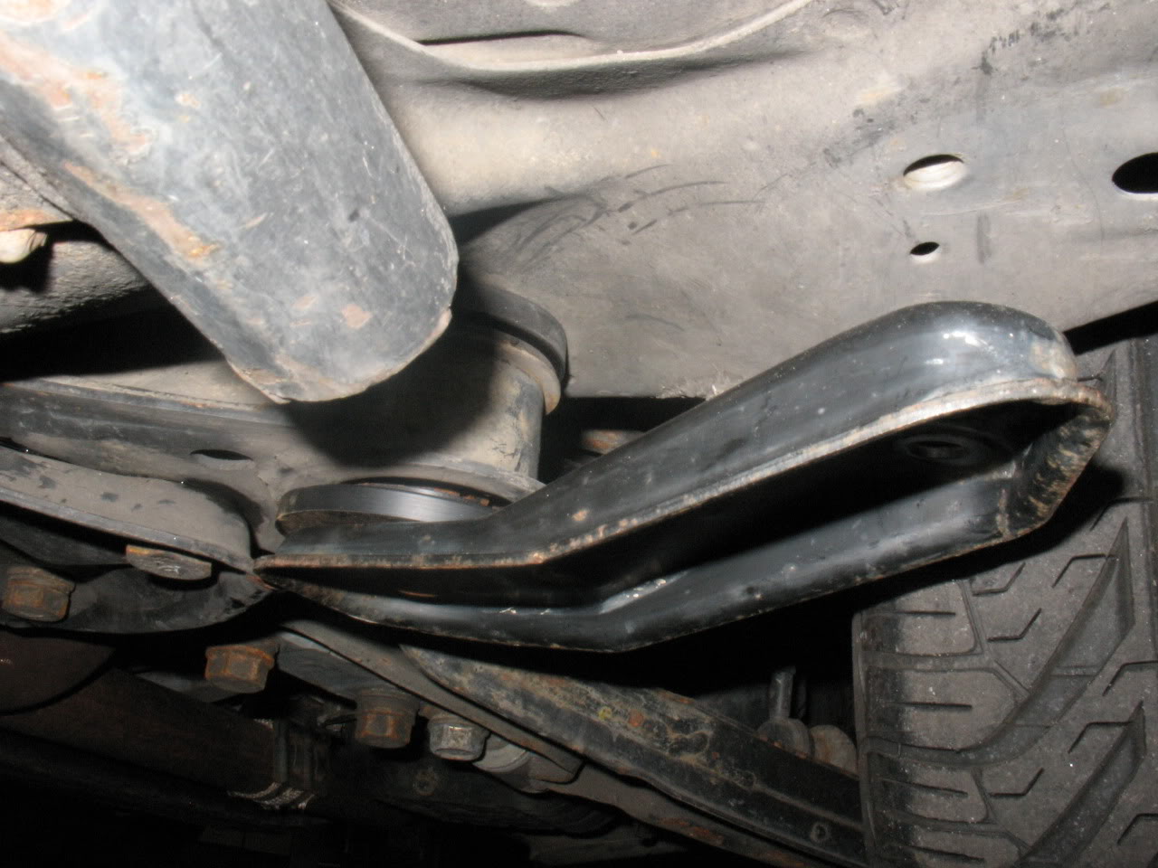

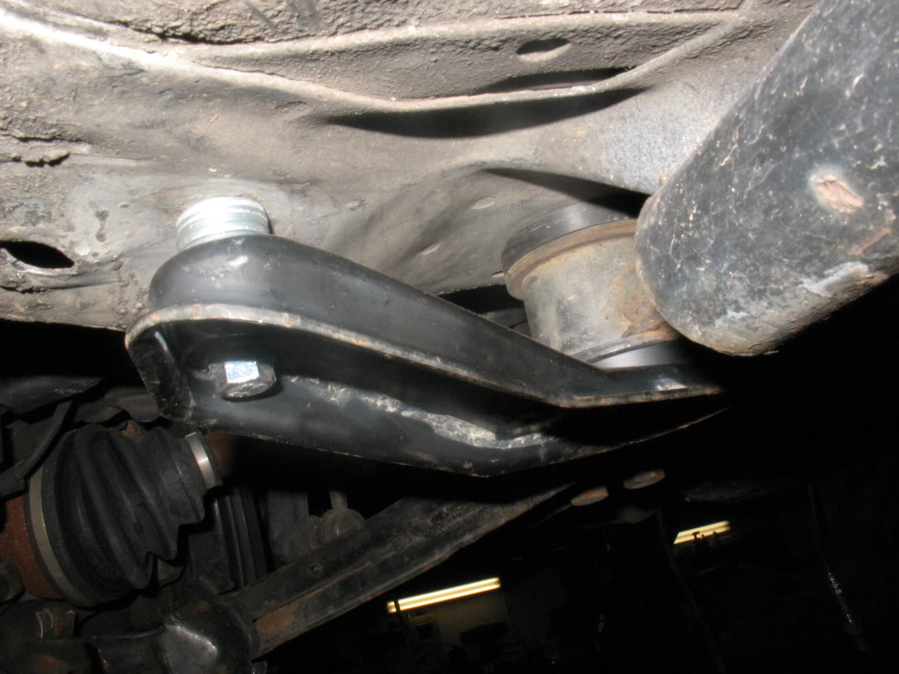

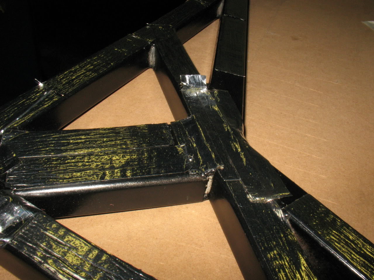

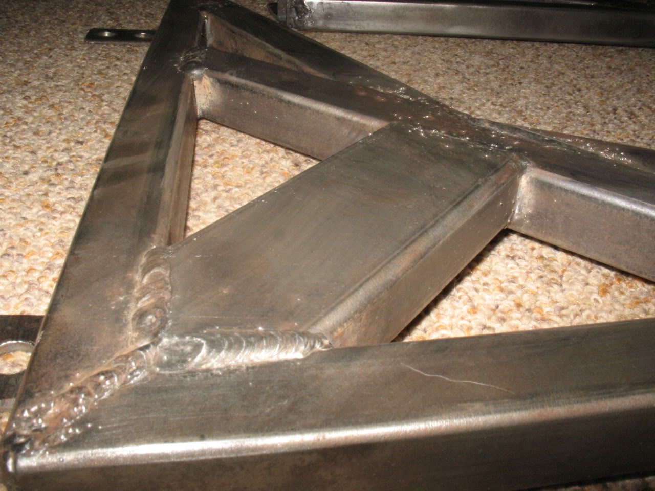

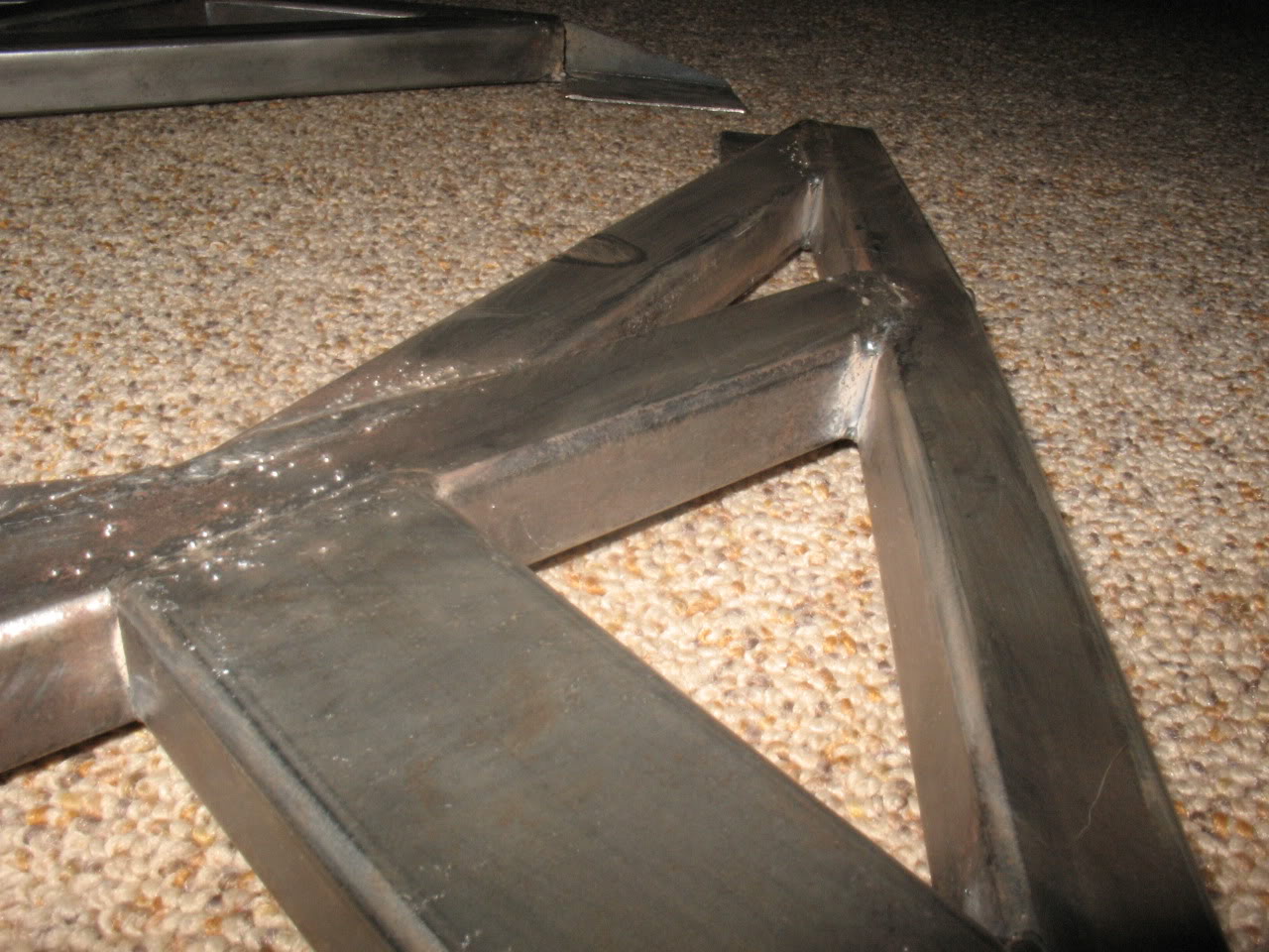

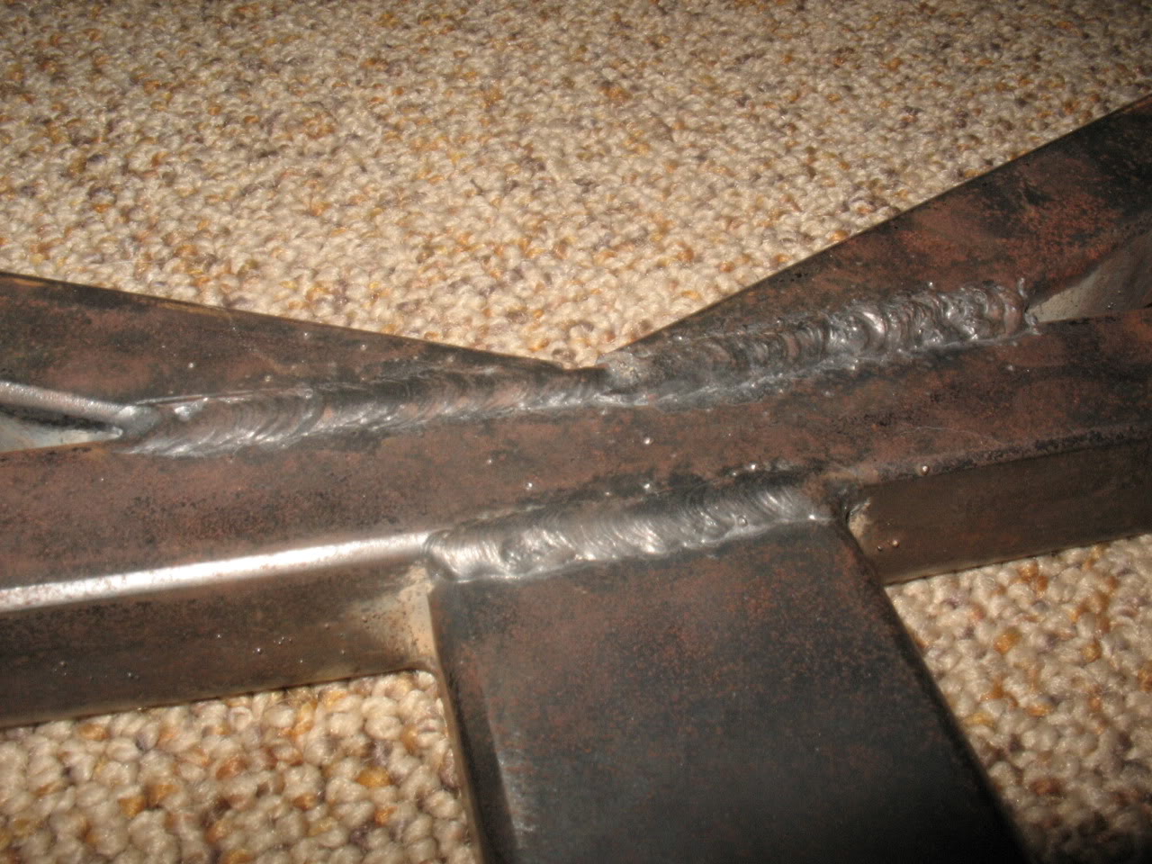

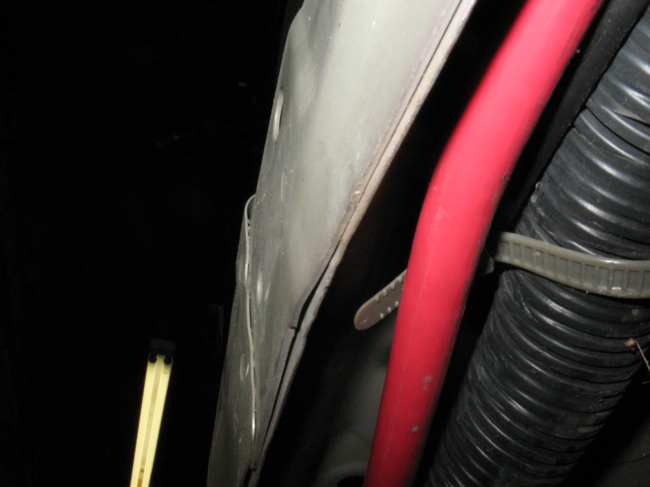

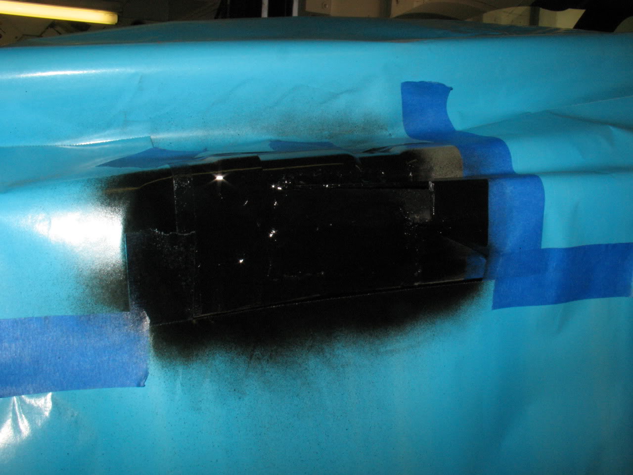

Fender braces
13 Attachment(s)
Over the years, reviews trickled in about people getting a set of fender braces installed on their Maxima, but sets were never mass produced and I could never secure a set for my car. Luckily, a member on here approached me about making a set after I had posted up a WTB, and after figuring out a design, he sent me these:
Attachment 53017
Attachment 53018
Attachment 53019
Attachment 53020
I would say each side weighs about 7-8 pounds, which I think is a fair trade-off. This how they turned out after sanding:
Attachment 53021
Attachment 53022
I then used some black VHT Epoxy Paint to keep surface rust at bay:
Attachment 53023
I went into the installation a little unsure of how I was going to mount the front portion to the car. When mowgli29 installed his a few years ago I believe he just drilled a hole in the fender and bolted the brace on that way. Looking at the thin fender material didn’t inspire confidence. We thought about using an existing hole, but it still would have only been one weak mounting point. Lucky for me, Eric is a decent welder and volunteered to weld them on. We drilled two holes in each mounting tab to use as rivets, and got to work. I went a little overboard with some sound deadening material on the back of the braces to make sure there is no metal-to-metal subbing when these are on the car.
Attachment 53024
Attachment 53025
Attachment 53026
Attachment 53027
Attachment 53028
Attachment 53029

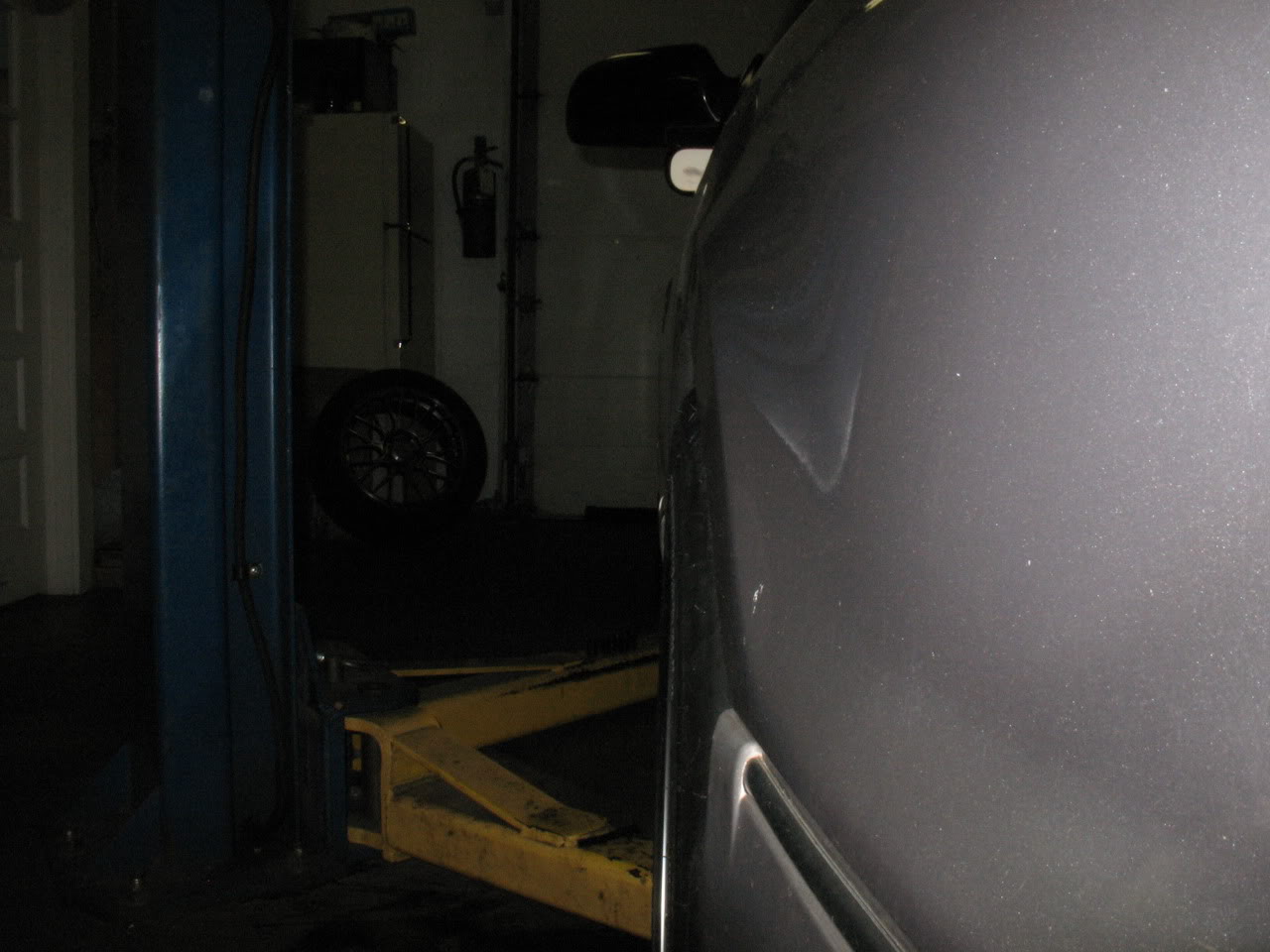

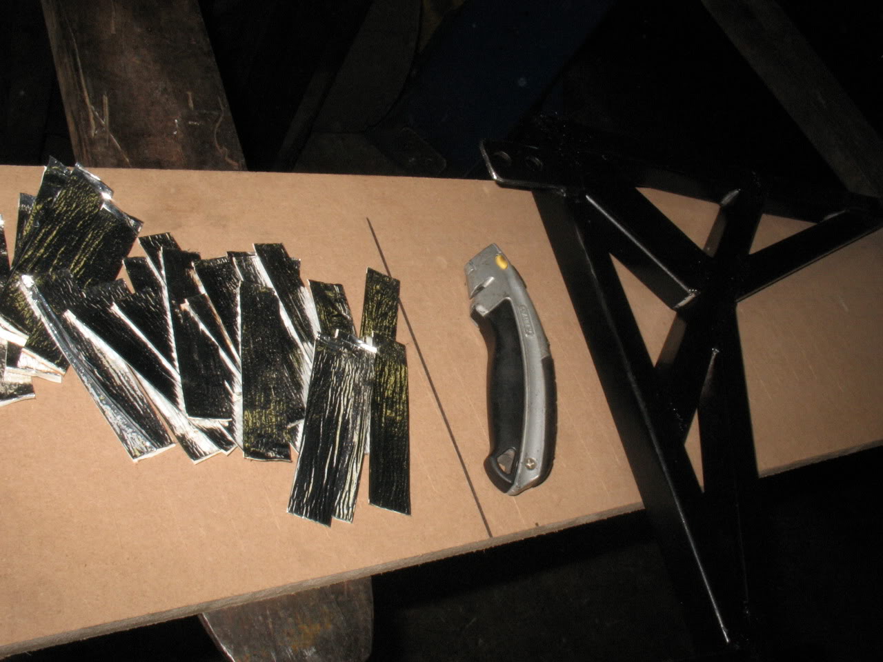

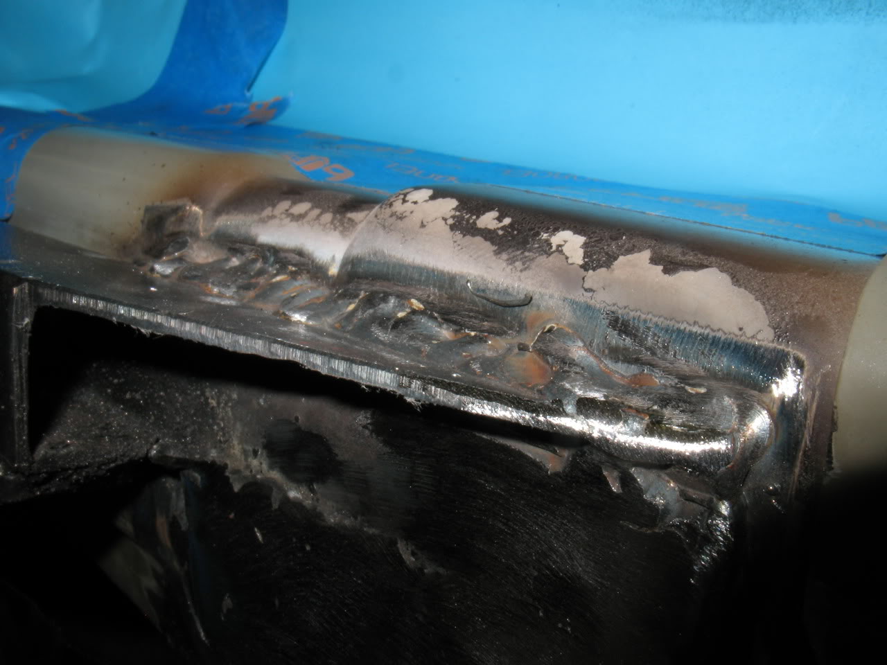

95maxrider 03-18-2012 09:36 AM

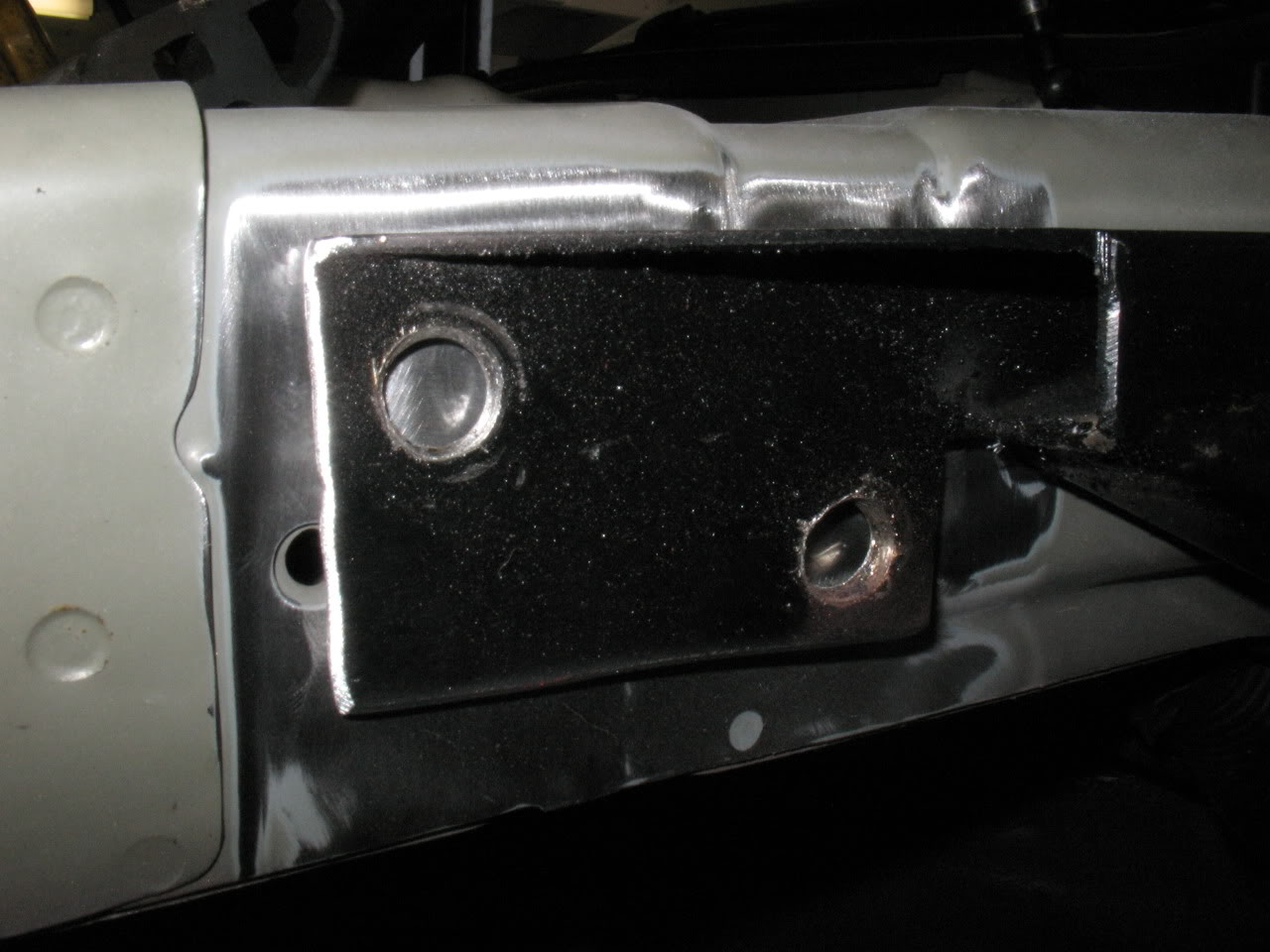

Fender braces continued
13 Attachment(s)
Attachment 52998
Attachment 52999
Attachment 53000
Attachment 53001
Attachment 53002
Attachment 53003
Attachment 53004
You can see where the two holes were filled up and then smoothed over. Once everything was cool I painted over them with the VHT paint.
Attachment 53005
Attachment 53006
Attachment 53007
Attachment 53008
We had to use new longer bolts to hold on the doors as we didn't think the old ones would be long enough to securely thread given the thickness of the fender brace mounting bracket.
Attachment 53009
Attachment 53010
I’ve only been able to put a few miles on the car so far, but I must say I’m very impressed. The front end feels much more solid when going over nasty bumps or potholes. Ride quality is much improved as well. I will update this section as I get more seat time!
