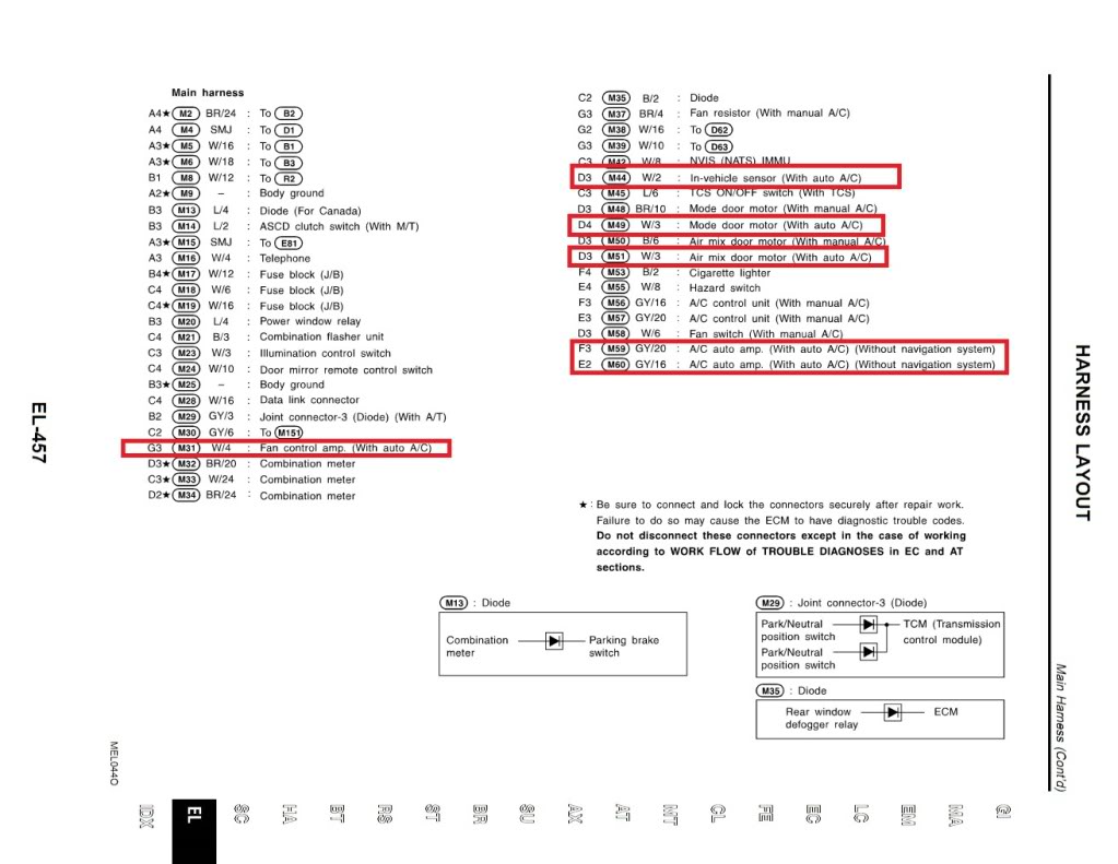

Sadly the car has a manual climate control and it bothers me. I KNOW that the question of whether it's possible or not to swap digital into a manual climate Max gets asked frequently so I took a different approach and hope this thread gets OK acceptance. I am trying to bring myself to swap climate controls after a buddy's intense persuasion and willingness to help. I have not done the swap (obviously) yet or ever but I just spent the last 45 minutes doing a bit of research with the FSM and have noted some stuff I'd like to share as well as perhaps get contribution on from members who are more knowledgeable than myself in this aspect. Please feel free to edit the images with paint and re-upload if you know something I don't or simply missed highlighting.

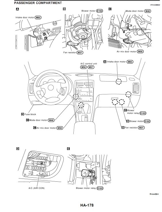

Components in Manual Climate Control equipped Maxima
Components in Digital Climate Control equipped Maxima

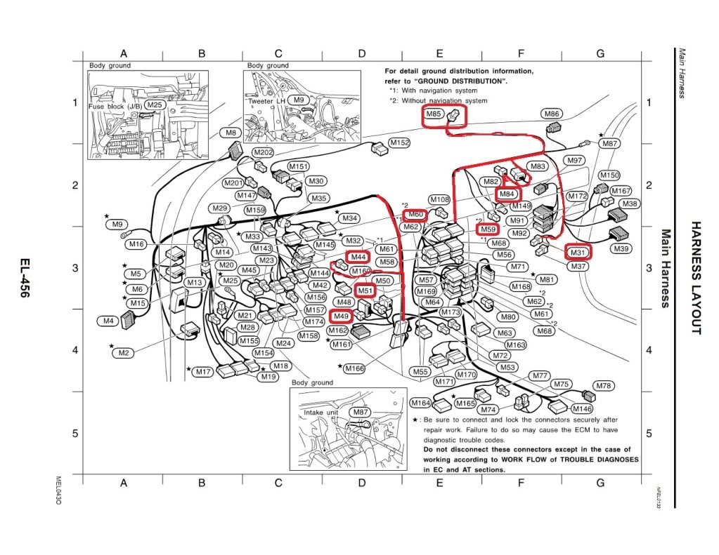

Harness List for non-navi equipped Maximas Name:  HarnessLabel.jpg
Old Jun 8, 2012 | 02:55 AM
ColombianMax's Avatar
Joined: Sep 2005
Posts: 4,945
From: Chicago

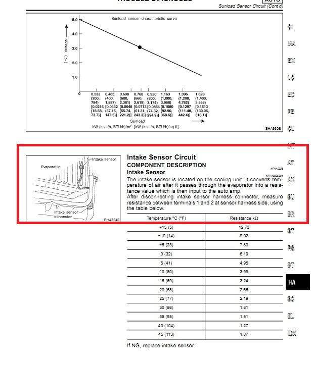

More "in-depth" sensor info

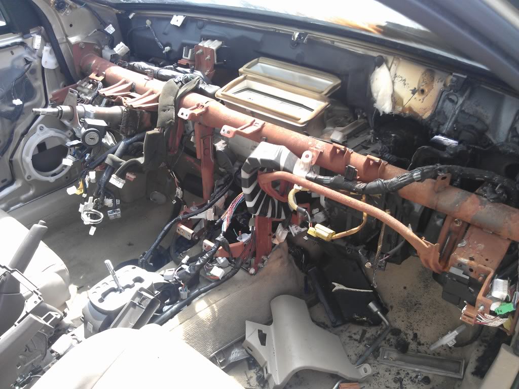

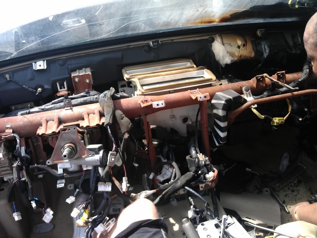

Small update for those of you who are actually interested. That same Saturday after posting the last message, I went to the junk yard with two fellow ORGers and dismantled the crap out of a 2002 Maxima that had an engine fire. I took some pictures and managed to get some of the stuff for the swap. Unfortunately the fire made it through the firewall and melted a lot of the wires under the dash on the passenger side I learned a lot since I've never taken a 5th gen apart. Next time I'll be able to dismantle that thing in a fraction of the time!
