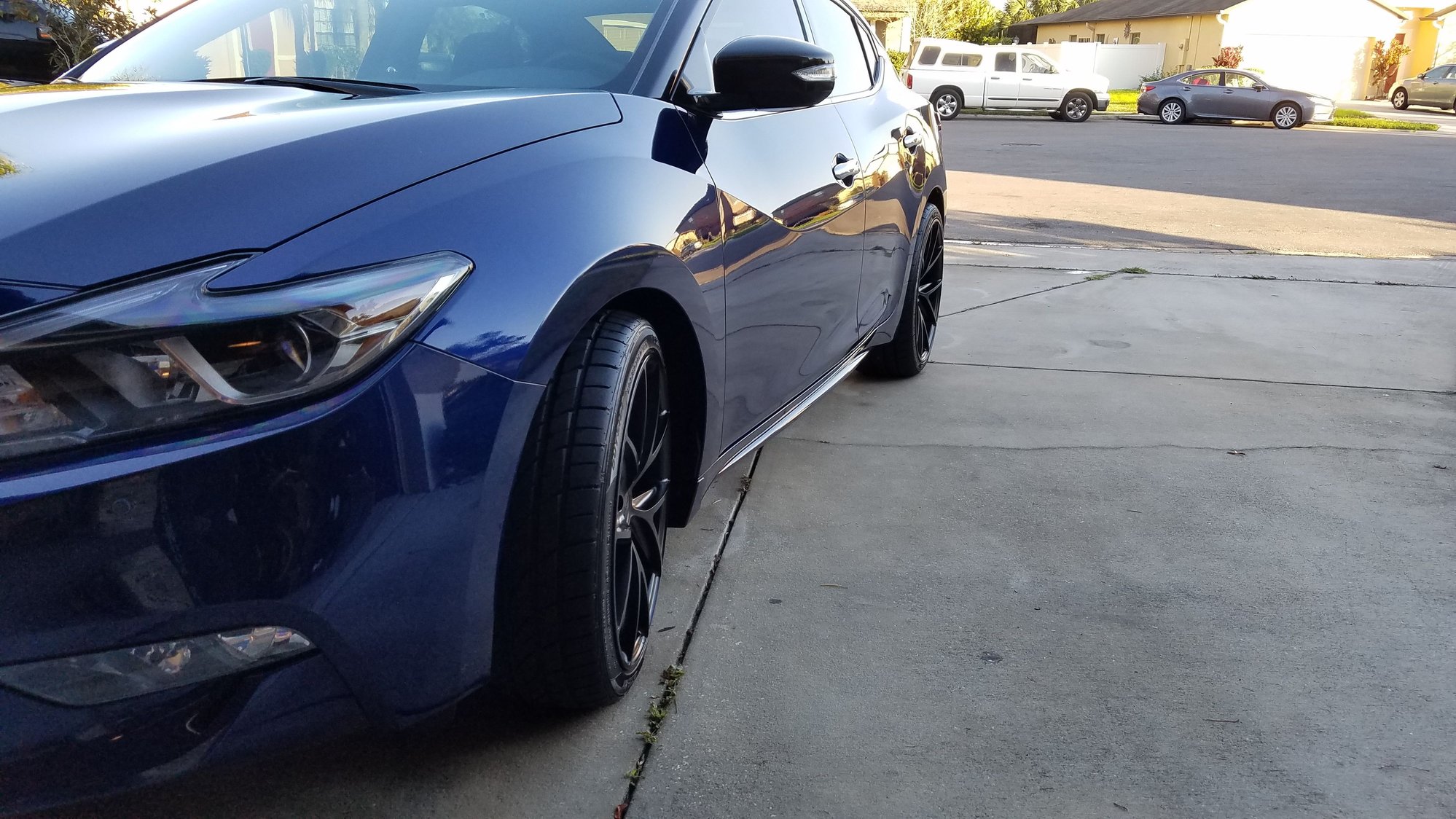

20" Asanti Adventus Wheels
20's and lowered.
xSoCALx is offline

20x8.5 all around, ET +38. Wheels line up perfectly with the fenders w/ no rubbing issues. Eibach Springs. Stillen front, Rear, Stillen Exhaust, Stillen Intake. ☺
xSoCALx is offline

Thank you. 245/35/20 Falken's.
xSoCALx is offline

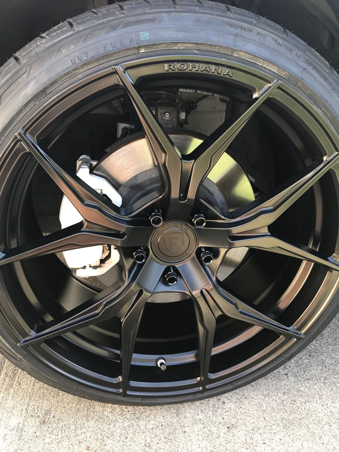

So after two different sets of wheels, finally foud a set that fit.
ROHANA RFX5 19x9.5 +38 NANKANGNS-20 245/35/19
bebanoscar1 is offline

The black wheels looked Soooo much better
whit is offline

bebanoscar1's Avatar
Join Date: Apr 2016
Posts: 38
I wasn't too fond of them, plus the rubbing issue was ridiculous. The original Niche Veronas wheels were the ones for me but would not look good in 20x9's.
I really like the new wheels. Plus they are a lot lighter and again no rubbing issues.

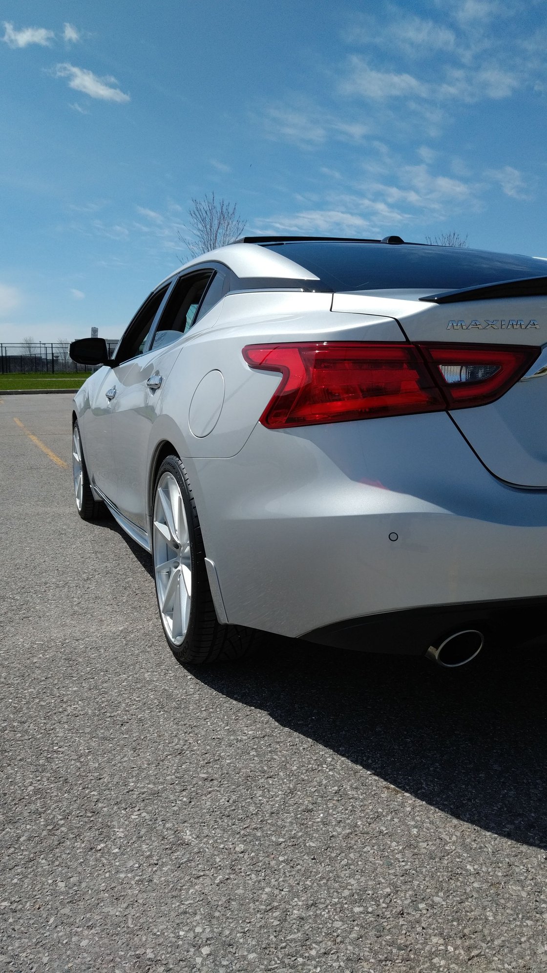

Vossen 20x8.5 with a 35 offset...sits perfectly...slight rubbing, no big deal, will have it fixed in the coming weeks
GeorgesMax888 is offline
