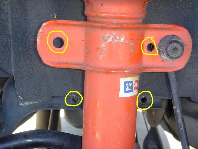

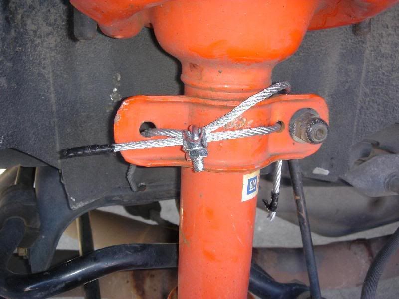

You use two cables to fully extend your rear shocks. This allows no weight transfer at all. The rear doesn't squat at all. This is a track only setup though. The rear will have no travel and rattle your teeth out if you drive on the street over bumps.
A lot of the grand prix/impala/regal guys do this and have reported some great increases in 60ft times!
Here is a how to (right off of clubgp):

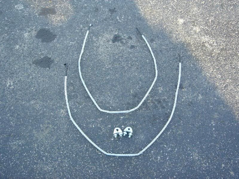

Here are the pictures for the rear suspension kit. Everything was bought at Home Depot for around $5. I bought 6' of steel cable and the cut it to measurement. Has extra left over and the two clamps. I don't remember the size of the cable. I think it was 3/16".
In one of the pics, two holes have to be drilled on the body frame and the the two on the strut. Then the cable comes up through under the car and then clamped tight.
Car must be jacked up.
