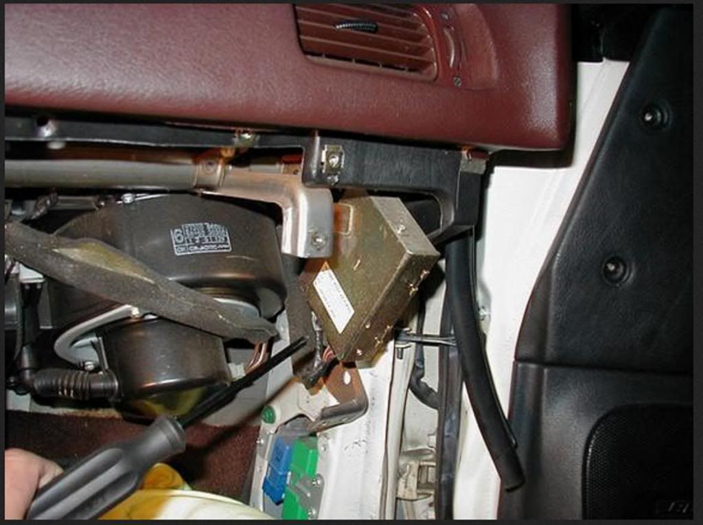

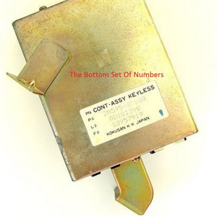

Okay I am Seeing a lot of problems how to reset the keypad, Well my part of the write up is to help those with some pics of the location of the security unit.
Get a flash light and move the passenger seat all the way back. and lay on your back facing up, head under the glove box where the passengers feet would be. now look up to your left... facing the door you will see a brass box with wires coming out of it.. locate the number starting with the letter "S" ex. S1329123..write those numbers down. IT SHOULD BE 7 DIGITS LONG!
Get out the max and and lock the doors. The Security light should come on the dash and then turn off. Press the St Button (last button to the left) Enter the digits you got from the box, after you enter it you hear beeping from the horn, at this time you must enter a new code with in 10 seconds. Pick a number that you can remember easily. The Code cannot be repeating Below is an example
Code consists in this pattern:

Get a flash light and move the passenger seat all the way back. and lay on your back facing uphead under the glove box where the passengers feet would be. now look up to your left... facing the door you will see a brass box with wires coming out of it.. locate the number starting with the lette "S" ex. S1329123..write those numbers down.
get out the max and and lock the doors.Enter the digits you got from the box, after you enter it you hear beeping, at this time you must enter a new code with in 5-10 seconds. Pick a number that you can remeber easly. The Code cannot be repeating Below is an example

I dont know my keyless entry code so I tried doing what your post said.
Well I tried entering the number after the "S" and nothing happened. I know you said to lock the doors and I tried that too and nothing. I got no beeping after the number at all, does it take a while until the beeping starts? I tried a few different combinations and nothing worked for me?

I hit ST to start then I start entering in the 8 digit code I have that starts with S. However, the keypad always stops beeping at the 7th digit. In other words I can't enter in the 8th digit.
I have to unlock, open the door and re-lock the door before I can enter the code in.
Anyone have any ideas as to what I'm doing wrong??
Oh and I'm not entering in the S before the number just the number.

I followed the howto exactly and i didnt have a problem I did have to remove the box with the sticker on it and open it up to get the code though and it worked for me I dont know why yours wont work are you sure you go the right code?

I'm going to look again. I say on this website:
http://groups.google.com/group/alt.a...11163595506455
that the code should only be 7 digits long and can also be found on the engine side of the firewall! Anyway I got eight digits after the S so I'll have to find 7 digits somewhere!

ok if you look for a box near the glove compartment it should have a sticker on it with two sets of numbers on it one of those is the 7 digit code you need mine was faded so i had to remove the glove comparment and take that box out. I had to open it and take the lil circuit board out carefully and flip it over to see the sticker on the inside which had the code on it. I put everthing back and then i was able to enter the code and reprogam the key code and now its working and I use it all the time.

I couldn't find the code on the firewall but I found I had written down the number on the box wrong. I had to count digits to make sure I had 7.
So for anyone who reads this, the number of digits should be 7 exactly, not 8 like I had written down

I looked for that box once before until my neck hurt! Your excellent photos led me right to it.

I tried looking under the passenger side for mine but i couldnt see it.
i was just about to take the dash apart when i caught a glimpse of the box through the small space where the glove box slides in. Was WAY easier than taking the dash apart.
