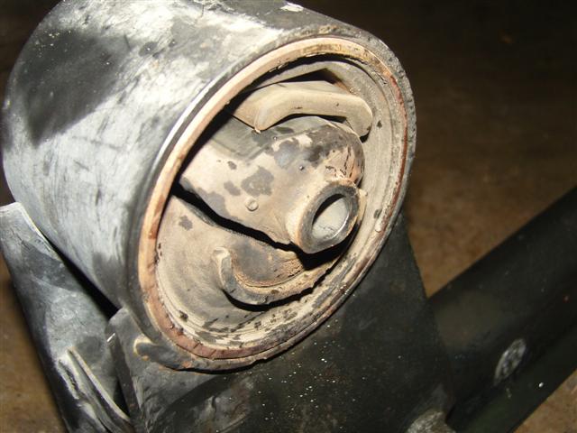

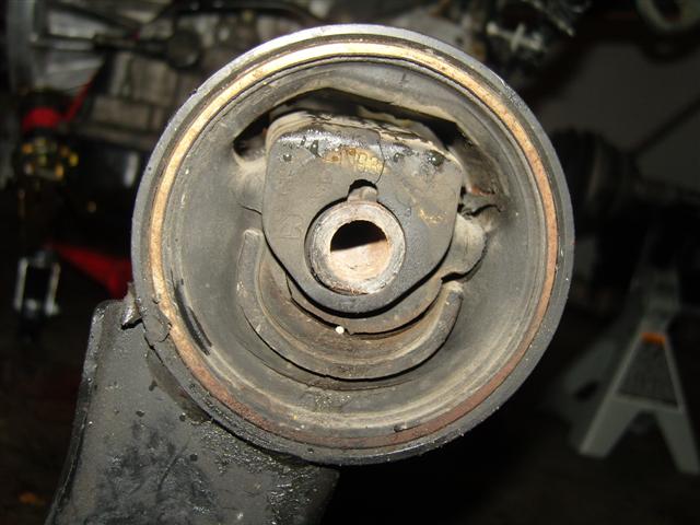

Bad news though... the engine mounts are so destroyed they might as well not even be there. The front-most tranny mount is in really bad shape too, not broken, but it has a crack and the rubber part is loose from the metal. I didnt check the rear tranny mount, but I suspect its in bad shape as well. This is getting more expensive then I expected...
The engine is still in the car, but just hanging on chains though. Tomorrow I'll lift it out and place it on a stand to start cleaning and repair. I know I'm going slow, but whatever...

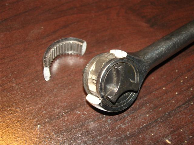

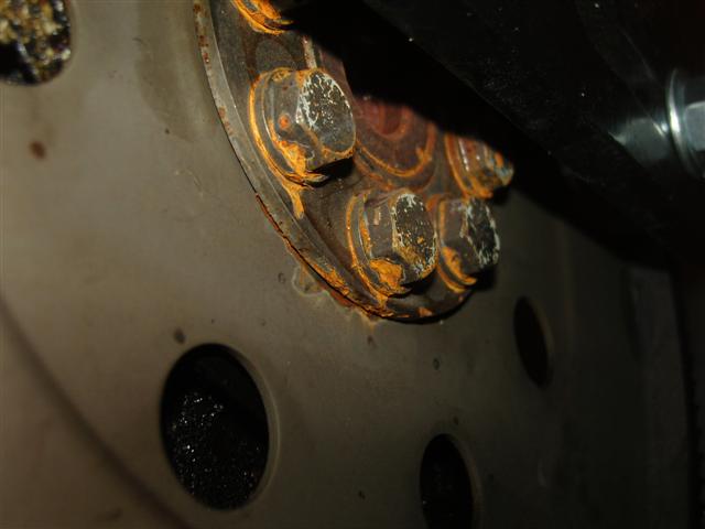

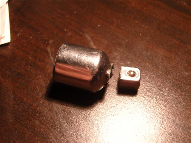

There were some casualties though:

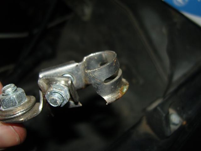

Also found more handywork from the flood:

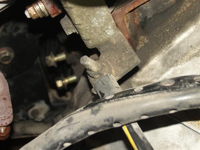

Dirty, dirty ground
+ connector broke somehow, that was random

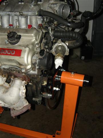

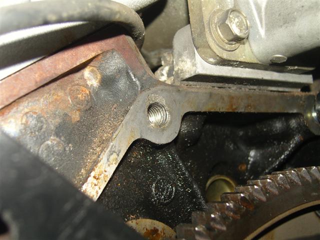

Unwelcome news
Not sure how this happened, but there is damage on the outside, and a few of the threads dont look quite right, this will need careful attention

run a 10mm tap through that bellhousing bolt hole and you'll be fine.
the rest of it is normal stuff for a 13 year old car. all needs to be fixed, but none are a big deal.

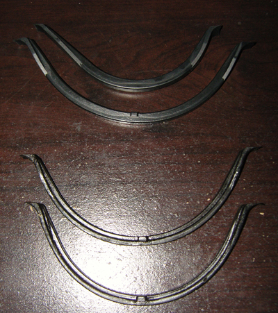

How about this crap, Courtesy sent me two different oil pan gaskets! I just discovered this as I was about to put the oil pan back on. There are supposed to be 2 identical large gaskets, but I have a large one and a small one. They gave me 11121-14Y10 and 11121-14Y00. I dont even know which is which anymore.
Unless a local dealer has one (or Matt discovers he has a spare), I have to wait until Monday at the earliest to even put the engine back together. Talk about a setback, I planned to have the whole car assembled tomorrow.

Here are the seals btw, old on bottom new on top:

one more (of the million already) point against Courtesy. This is why I quit using them years ago.
Check with Tom Peacock and Sterling McCall Nissan for the seals.
If all else fails, clean up an old one really well and coat both sides with a thin layer of RTV. I've reused them before but only when I had to.

http://blehmco.com/pics/car/engine/100_1227.jpg
only thing I can guess is that maybe it got stuck between the crank girdle and the crank's counterweights.
there's not enough room between the two so if the dipstick gets moved behind the girdle, the counterweight will hit it and rip it apart.
also note in this pic there's a small "tube" welded to the inside of the oil pan. I'm pretty sure that's for the dipstick.
