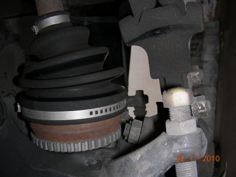

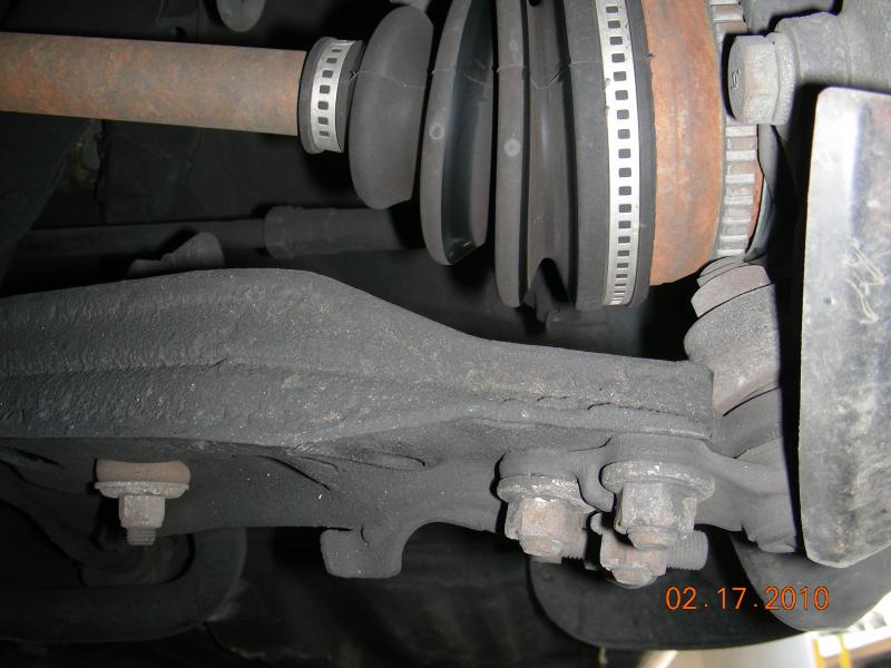

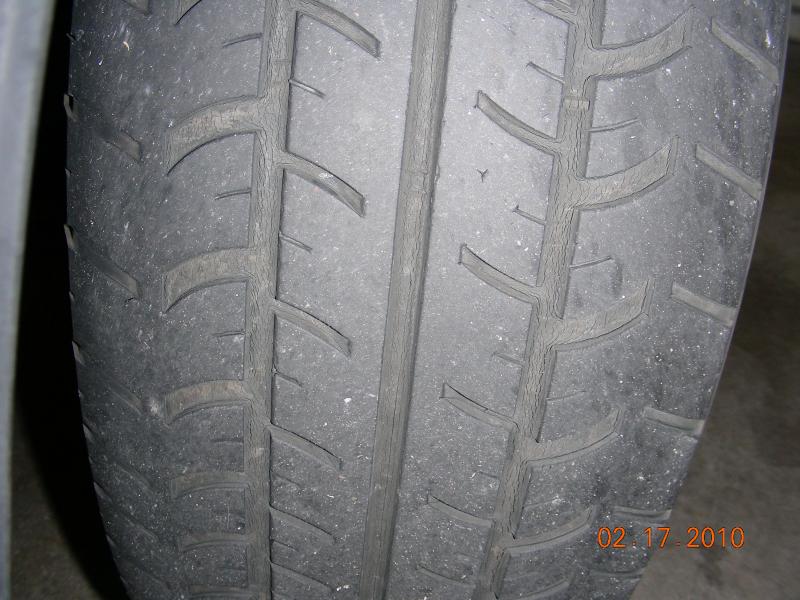

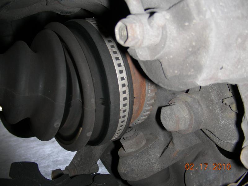

Here I add a couple of pictures, the first one is the driver side, I think the passenger side is not that bad, the one have me worried is the driver side tire, you can see the wires
ya those are not as bad as mine were just put the rears on the front and the fronts on the rear they should be fine untill you get some new tires but get it alligned right after you switch them or the same thing will happen again.... its probably just the allignment although i would check your ball joints cause thats what caused mine to get out of allignment in the first palce made the front end loose which in the end screwed my allignment.... lucky you noticed at such an early stage in your tires mine were much worse lol
take that wheel off (the corded one) and take pics of the ball joint and the control arm bushings.
also, when the steering wheel is straight, does the top of the tire lean a bit toward the body? or does the front of the tire seem to point away from the body?
Honestly, it seems straight without any lean, but if I'm very picky i would say just a little bit toward the body, also when driving in a straight road and put the wheel straight and let it go, the car turns it self to the right, I was told this is sign of the alignment needed, but not sure if that could mean something else.
it's where the control arm attaches to the body. one is a rubber thing held on by a u-shaped strap, the other is behind the big 22mm nut just underneath the frame by the axle shaft (forward facing)
You have several problems going, all typical of an older car in need of maintenance.
First.. Notice how it looks like the inner edge of the tire is "shaved" at an angle? That's indicative of a toe (alignment) problem. with the inside edge being worn, that means your wheels are toed-out. i.e. the tires are pointing away from each other while you're going forward.
that causes the tire to pull toward the outside of the car and the tread rolls this way. since the tread blocks are then not flush with the road surface, you scrub the inside edge off and it creates a bit of an angle.
That can USUALLY be fixed be getting an alignment, but it can also be caused by many worn out suspension components. ball joints and tie rod ends are often the culprit, but control arm bushings on our cars are also very common to die- as all previous posters have mentioned.
The second problem I see is that the outside edge is worn as well, while the center of the tires isn't worn as much. this is a tell-tale sign of low tire pressure. air up them tires and you'll get better gas mileage! 30psi is 'about right' for these cars. factory says like 27psi, but that's a bit low. I usually use about 30. If you wear the outside edges of the tires, then pressure is too low. if you see the middle of the tread wearing and the edges are fine, then air pressure is too high.
Third, those tires are dry-rotted and need to be replaced. See the tiny cracks on the surface? Rubber does that with age and exposure to oxygen and UV light. they simply dry out and shrivel up. They can eventually crack all the way through and begin to leak air, or they can catastrophically fail while you're on the highway and blow out.
Running dried-out tires low on pressure is one of the leading causes of highway blowouts-- so make sure you keep an eye on tire pressures. (check them at least once a month. I usually do it about every other time I get gas. just set the pump to go and walk aorund and check your tires while you're waiting for the tank to fill.)
As for a recommended course of action.
First. BUY NEW TIRES. replace those two. As has been said, the one showing cords is unsafe and could blow at any minute.
even if you have to drive on a bad alignment for a while until you can afford to get the car fixed, you NEED new tires! Driving a week or three won't ruin the tires- you'll wear off a bit more rubber than you want, but they won't just wear out in a matter of weeks.
second. get the suspension checked by a qualified suspension/alignment shop. depending on the tire shop, they can often look at the car and give you an estimate of repairs. Places like Discount Tire don't do alignments, but there's usually someone in the area.
third. examine your rear tires. if they're dry and cracked like your fronts- even if they have plenty of tread- then you need to replace them as well. I know you're tight on money, but it's a safety issue and you should get them replaced as quickly as you can afford to. make sure they're up to the proper pressure and you should be okay until you can afford to replace them.
At the end of the day, this is nothing too drastic- just get your front tires replaced ASAP and then work on the rest as time/money allows.

ok I took a lot of pictures but not sure which ones will show better the ball joints or control arm bushings (don't know what they look like)
If you need to replace those bushings you can go two ways. Order the whole lower control arm assembly as they will include both bushings, but a little expensive. The other is to order only the two bushings and replace them yourself or someone else does it for you. That's the cheapest route but the downside is front bushing will not be easy to take off.
EDIT: Ball joint is #40160, next to the lower control arm

The shoulder wear can also be caused by aggressive driving and/or worn struts and driving on lots of curvy roads. i.e. the car leans too much in turns and with hard driving, the tire's sidewall rolls over and you use more of the edge of the tire than the center.
Based on your previous comments, I'd assumed you weren't that aggressive of a driver.. point being, the harder you drive, the more of the edge of the tire you'll use.
