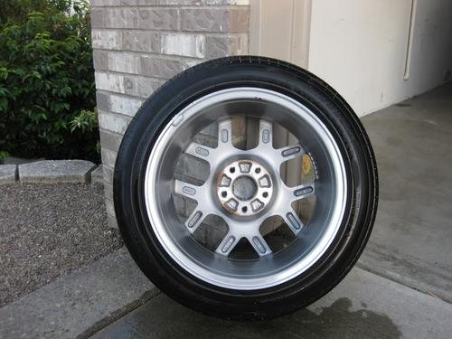

Originally Posted by cardana24
so according to the washers I need about 3/8", 10mm more clearance to get the tires off of the struts in the rear. So, do I need stud in spacer, wheels spacers or do I need a 10mm wheel spacer and longer wheel studs. Is there a standard lengnth longer wheel stud? Is it about 10mm longer than stock? Any good spots to buy them? Thanks for the advice.
i have seen stud-in 10mm spacers, BUT.. they will only work if your wheel has empty space where the studs and nuts can go up into them since they will not be flush with the face of the spacer. if your wheels do have them then you should be ok.

Since I am not infront of my wheels right now, I googled imaged some pictures. I am pretty sure I do not have that space. I am going home to pull out a stud, then I will just order the nismo studs from the dealer. I will still need to pick up a 5x114.3 10mm hub centric spacer though, so I am open to suggestions.
those g35 wheels?
Old Apr 6, 2010 | 07:59 PM
CapedCadaver's Avatar
Call me Wookiee Goldberg
Joined: Feb 2007
Posts: 43,322
From: Central NC
Originally Posted by Hatmanafro
those g35 wheels?
not that i'm aware of.. probably mustang wheels or something. i just found it on google.
edit:
TL type-S wheels http://acurazine.com/forums/showthread.php?t=735118
