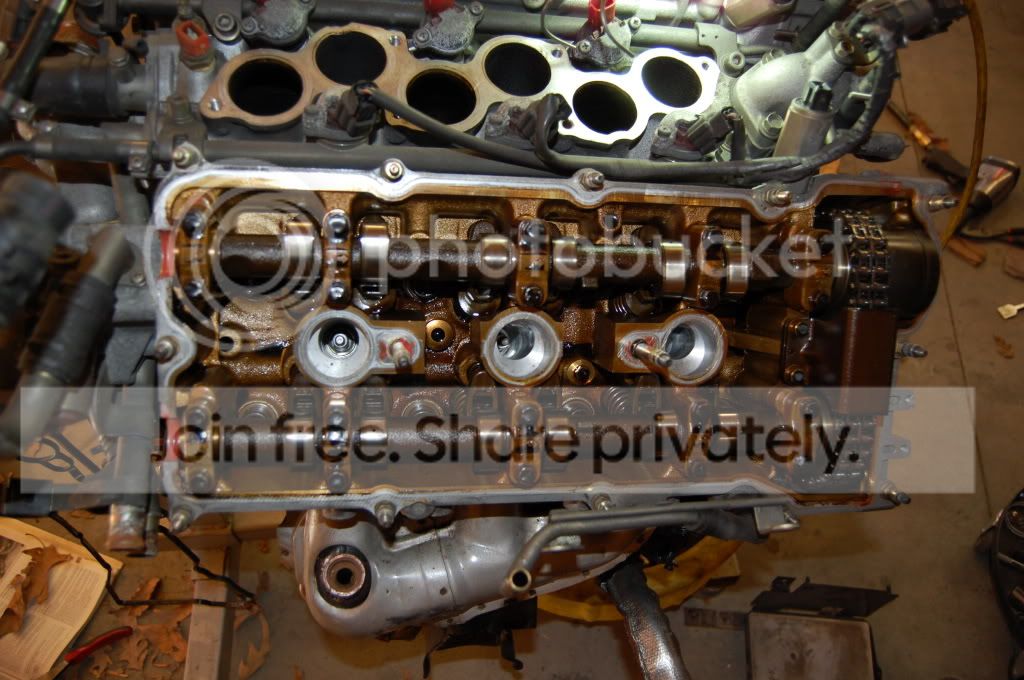

I got a question. Does the VE30de use spark plug tubes and isn't the gasket a part of the valve cover gasket?
I think your right..
Originally Posted by VEvolution
I think he may be on to something here... dang VEs have to be so darn different! VQ30DE use tube seals while the VE apparently has it as one full gasket! Kind of convenient actually...

Old May 12, 2010 | 04:08 AM
Augustus Maximus's Avatar
Joined: May 2009
Posts: 1,004
From: Connecticut
Snatched this from Cardana24 engine swap thread. Here's what we she looks like under the cover.

Thanks for the link mang. Nice price. Looking at the picture of the engine layout, it looks like it's for the front.
Originally Posted by Hectic
Correct location, wrong emblem.
It's more of an inside joke thing between me and my friend rather then anything else. And also many Maxima enthusiasts will know what that means. Should probably put an italic red 5 there too hehe
Wow sweet pic.. Always wanted to know what the VE cams look like. V6's are so cute and compact. This is what I have to deal with..
