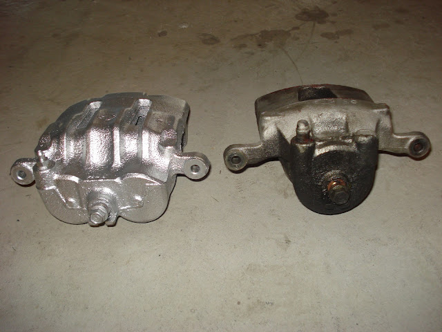

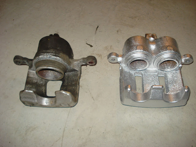

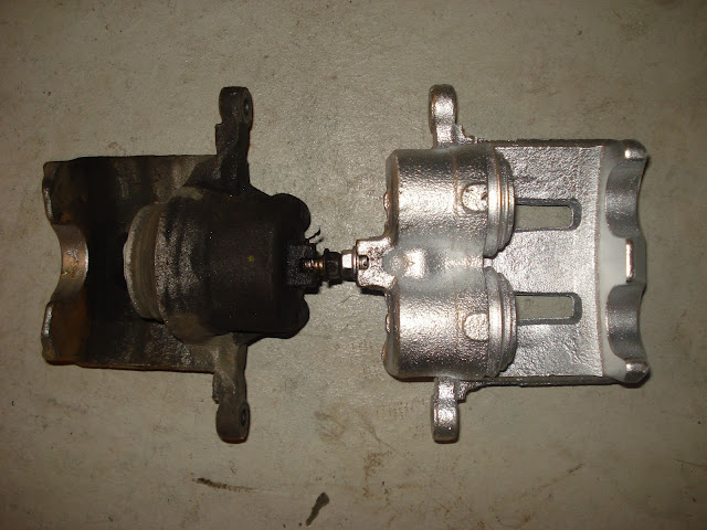

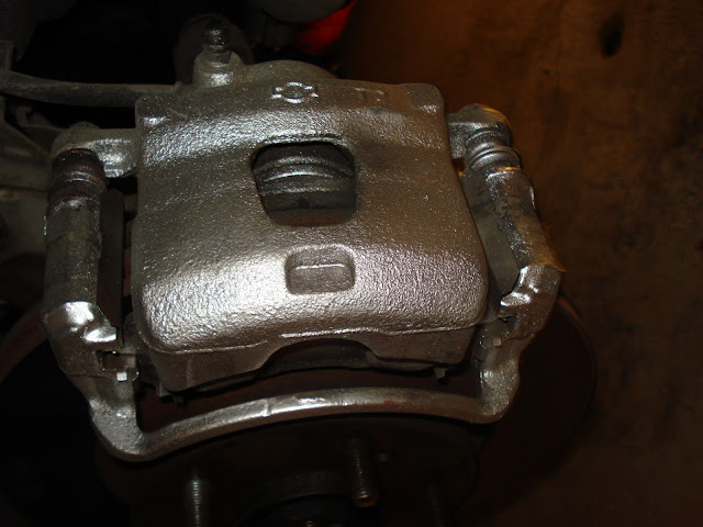

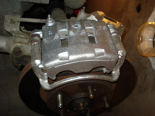

I just installed front rotors from a 95 Mazda Millenia on my 3rd gen with a J30 dual piston caliper. Clearance is close but it clears with a 2mm washer between the torque member and the knuckle. The center bore of the rotor is bigger and gives about .5mm or so of play when on the studs. The rotor is 274mm vs 280mm for the Z32. They are both 28mm thick. These rotors with a washer save the trouble of having to mill off 3mm of radius on the Z32 rotors. They also clear the dust shields. I assume fitment is the same for Q45 calipers. The rotors should also work with a Z32 caliper but I'm unsure of the fitment with the pads. Someone try it and find out.
I had a couple of issues one being the one shown with the outside pad. The grinder took care of that pretty quick. The other was the hardware that holds the pad rubbed the outside of the rotor. I bent the tabs back and forth like a paper clip until they broke. Hopefully they wont move left and right too much. I made a few laps around the block to bed the pads and all feels good. After tweaking the hardware on each side there is no more rubbing or grinding noises.
There is a considerable difference in stopping between these and my stock setup. All in all it was a great upgrade for little money. If you do this when in need of pads and rotors the only thing extra are the J30 calipers.
cliffs: 95-96 Mazda Millenia rotors work with J30, Q45 calipers with slight modification to the pads and hardware and using a 2mm washer between the torque member and knuckle.
Pad before grinding:
Pad after grinding:
Fitment:
Modified hardware left, OEM right:

Cool, good job. What is that.. about 10 3/4" rotor?
This is interesting. I may consider this for my black VE. What did it cost you total?
10.79".
My total cost was about $130. I got calipers at the wrecking yard for $20 and rebuilt them. Pads and rotors were ~$95. I needed pads and rotors anyways so I consider it a $35 upgrade. Rockauto has some good deals on the calipers and pads now.
Originally Posted by ColombianMax
Thanks! btw how did you discover this setup?
I searched through the Brembo catalog until I found a 274mm rotor with a 5 X 114.3 bolt pattern.

What's the difference between the J30 and Q45 calipers?

sweet find, but i wanna know how well it works being non hub-centric.
Works great. There is maybe .5mm of play in the rotor. See my 3rd pic which shows it sitting on a stud. Not much room to move. Maybe the cobra rotors take bigger studs so there is more play. In any case, I cant notice anything out of balance or any negative effects. If I do, Ill update this thread.
That's a very good point. Now that I look, it appears the Millenia rotors sit tight around the Maxima studs.
The holes on the Cobra rotors are quite a bit larger than the thickness of the Maxima studs which allows the Cobra rotor to move quite a bit.
