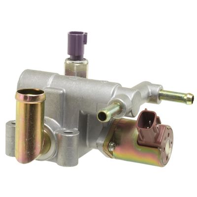

You are looking at the IACV's for two different engines, hence the confusion...
First off, a little schooling about the year model differences..
89-91 SE and GXE models had the sohc VG30E engine...
From 92-94 the SE model changed to a DOHC VE30DE engine
While the GXE model continued with the sohc VG30E engine up through 94.
The IACV is the same on all sohc VG30E engines from 89-94
While the IACV is different on the dohc VE30DE engine...
VG30E IACV...
VE30DE IACV...
