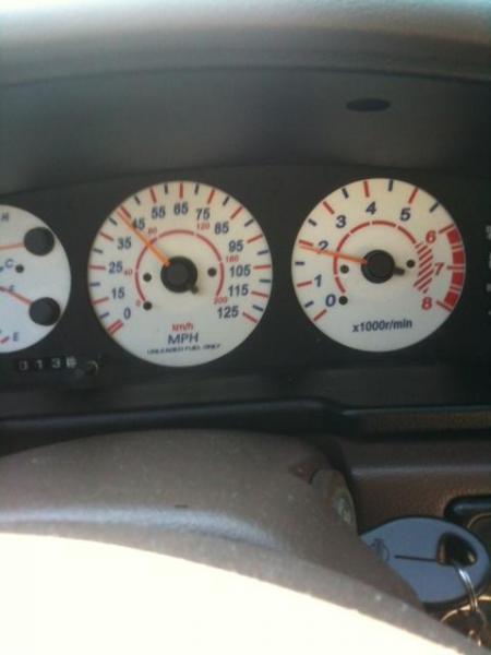

Update:
The RPM drops alittle below 2000 RPM at 45mph when i enable cruise control.
Edit:
Here's a pic with cruise control on.

Originally Posted by khemraj1999
Update:
Edit:
Extrapolating from that pic:
(44/1900) x 2500 = only 58 mph@2500rpm ................so some thing's funky. Post the same pic @ 75mph (TC and overdrive MUST be working there when box is hot - perhaps 45 is too low)
Do you have a GPS or mobile with GPS functionality that independently can confirm the speed seen on the dash?
