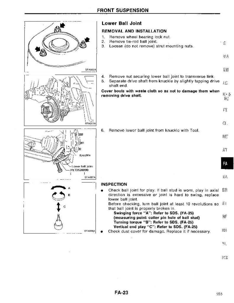

Go to harbor freight and purchase the ball joint separator tool http://www.harborfreight.com/3-4-qua...tor-99849.html
you can use it for tie rods too. It's pretty good for $20 and I also used it to remove my wheel studs to replace them too
Here's the page from the FSM.
