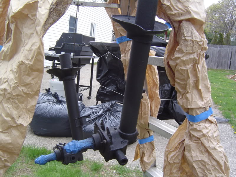

this is the rear strut....it's a tube that's basically fused into the rear spindle. there's pretty much 0 chance a coil over will work here unless someone wants to try and cut the tube and weld some kind of bracket. KYB and whatever aftermarket is left just uses an insert that goes into the tube as the replacement for stock unit.
pic courtesy of maximan190

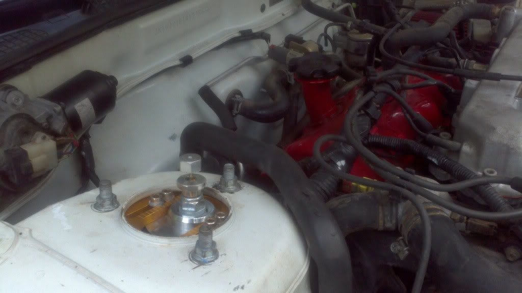

Right now i'm on Powered By Max coilovers for an s13. I'm still trying to get the rears perfect. It required some cutting/grinding and two 21mm x 80mm(IIRC) high grade bolts. I'll do a write-up when I double check all the measurements and take pics, but right now the car's on jackstands to have the oil pan shortened and motor/trans raised

Old Aug 2, 2012 | 05:04 PM
milkwasabadchoice's Avatar
Joined: Mar 2010
Posts: 35
From: Murfreesboro/Adamsville, Tn
This'll have to do for now. Front is on jack stands and I don't really feel like pulling a wheel off

Well its obvious you have coilovers but the area that everyone wants see if the rears. Fronts can be done the rears is where we meet problems.
