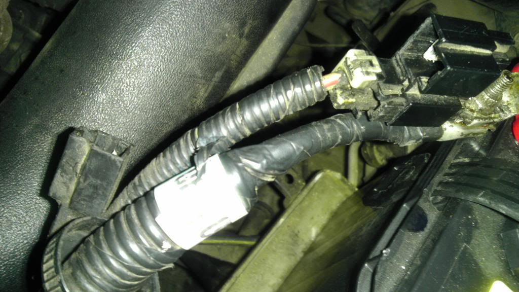

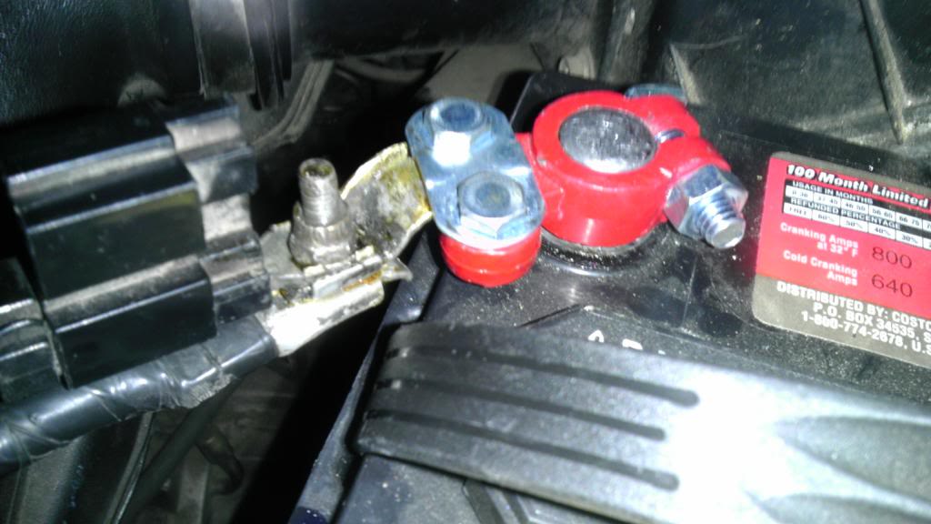

I gotta take a pic here soon of those wires, the ignition wire and battery wire are booked up but the white going to the alternator is not, its missing a short cable in between the clips, I imagine that should have had an impact before all this not after? I remember when I disconnected the positive to shut the alarm off I hooked it back on and the alarm came back on for a second or two and the turned off, so I assumed it did the trick

The white wire to the alternator has\had a fusible link between the battery terminal and the wire. Since you think this was not hooked up and everything worked I wonder if someone added a new wire and ran it somewhere else like from alternator output to the starter terminal where the battery cable hooks up? If the White\Red is attached to the battery terminal and has a good connection so that 12v can be measured in it by piercing the insulation with a pin or needle then, the next stop for this wire is the fusible link box. make sure all the fuses and links in this box have 12v to them and through them. After it leaves the fusible link box it goes straight to the ignition switch, headlamp system, and anti theft system. Drop the trim from around the steering column and find the harness going to the ignition switch. With the key off is there power on the White\Red wire there? If not, find the wire that does have 12v at the switch connector with the key off and let me know what color\terminal it is.

so here's a pic of the missing link, I really couldnt see any wires that looked like they were modified, I guess the next step is to test those wires for the 12v? Does that imply testing between the wire and the terminal?

Alright. Exactly what I pictured. It looks like the terminal where the Alternator output belongs has corrosion on it. At this stage, unplug the White\Red and see what condition the spade it connects to is in. This is where co rrosion builds up and breaks the connection. This is also where people (me) usually cut this connector block out, crimp eyelets onto the wires and put those under the nut that is holding the connector block. If you find corrosion at the White\Red terminal, clean it or just do what most do and get rid of the connector and install eyelets. While those wires are disconnected, put your voltmeter in the range to measure 12v. put the negative lead on the battery negative and check the disconnected wires for 12v. There should be no voltage on either. If there is, then someone most likely added wiring somewhere else in the system to bypass this connection at the battery because they didn't understand. Something else I would be interested in knowing is if the white\red has power on it when disconnected but with the key on. That could indicate that an accessory or added circuit is indeed feeding back through the ignition switch. If everything checks out good here. Reconnect the White\Red, and move over to the fusible link box. With the voltmeter on 12v or a 12v test light, see if the 2 15amp fuses have power on both sides by touching the exposed metal points on top of the fuse. The fusible links are the larger amperage 'fuses' the three most forward (Sometimes just 2) are in the White\Red circuit. Remove them and check that one terminal in each location has 12v. Put your meter in Ohms and measure across the spade connectors of each fusible link, any that does not have continuity replace. If everything is OK here, move on to the igniton switch as outlined in post #32.
I will also mention here that the unattached white wire also feeds, power windows, power locks, automatic seat belts, trunk opener, sun roof and, shift interlock system.
Edit: I just went out to my car and was filming how to check this stuff out. I left the white wire disconnected like you say yours is and It duplicated your problem on my car. So, I seem to be partly wrong about the White\Red but not wrong about they need to be attached.
Last edited by PsychGen; Jan 10, 2013 at 01:38 PM. Reason: added photo. edit 2, noticed something else. I just experimented on my car.

You are right PsychGen, it was that wire. And my alternator tested dead so I replaced that too. Now everything is back to normal, I hope haha. Thanks so much everyone!!! You guys are all great!!!
