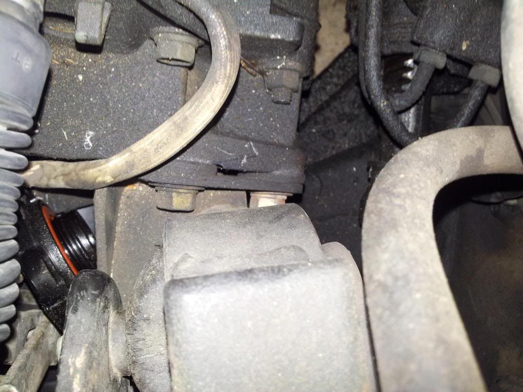

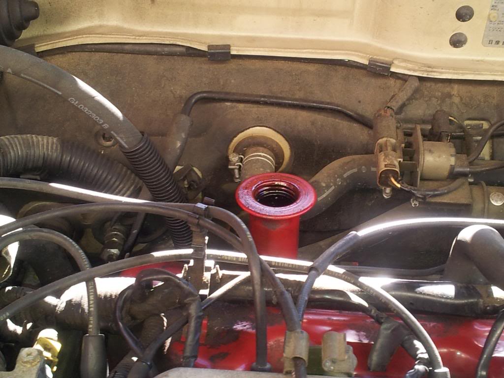

I opened the hood and noticed the oil cap was missing. I could not tell how that could cause the problem with the shifter. I went back to the mechanic and he said there was no way and he bought me a new oil cap.
When Danny suggested checking the shift linkage, I looked closely and guess what, I saw the missing oil cap had lodged itself between the gap and was blocking the linkage from moving.
What probably happened is the guy did not replace the oil cap and when I parked the car after driving home from the oil change is that the oil cap somehow slipped into the gap.
I was able to remove it after a little effort and all is good. Needless to say I didnt imagine a simple oil change could do this. Thanks again to all
