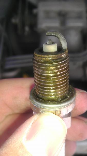

Ok, Battery was very old and when I brought it in for a load test it first tested 73% then 40% basically not hold a charge, and it was bulging at one side, had to replace it. That part had to be fixed.
I did however rev the engine and apparently it was backfiring a few times, half the tank is still 87 octane and this problem never presented itself when I had a higher octane in the tank due to adding lucus injector cleaner. I swear I also heard it coming out the intake as well but it might of just been echoing, not sure.
The spark plugs were replaced 23000 miles ago, Denso brand.
If it were a timing issue, wouldn't my gas economy be going down, and wouldn't it be doing it regardless of the engines RPM?
It seems that sometimes after a backfire the engine runs ok, then the issue might return when idling.
The issue does seem to be affected by the octane.
I did take a picture of the spark plug, does seem to be minor buildup on it.

I'm telling you man, I'm strongly leaning toward the lower octane fuel being the cause, especially nowadays with regular unleaded gas having so much ethanol in it. Start running mid-grade or premium which at many stations, (at least here in WA) has less, or no ethanol content. You said it yourself - the problem doesn't manifest with increased octane.
Thats where I'd start, personally. Its a cheap potential to rule out, worst case scenario you filled up on higher octane gas and it cost you an extra 3 or 4 bucks at the pump when you'd have already needed to fill up anyways. At the very least it rules out fuel, and as suggested by another member, try filling up at a different station as well if you haven't already, he posed the idea that it may be bad gas - a valid theory indeed.
All of that aside, if you still insist on running regular, check your knock sensor - mayhaps it is failing and is therefore unable to consistently prevent knocking caused by the lower octane fuel.
EDIT: and your spark plug electrode looks iffy, probably wouldn't hurt to replace all six. They're usually fairly squared off, yours looks worn out, being shaped like a dome. Get NGK platinums, the OEM replacement. These cars don't tend to like non-OEM plugs, so the general consensus goes. Also, check your spark plug wires too, I had an intermittent misfire that would only manifest when it was raining or otherwise humid out caused by voltage leaking past the boots.

NGK copper plugs are the OEM plugs BKR6ES-11. the VG30E never ran plat plugs as OEM/factory. the VE30DE had plat plugs but they also have coil over plug ignition set up and not the dist cap and wires of the VG.

- check the timing with a timing light..yes it's old school but these cars are old and they will need you to set the correct timing otherwise the ECU will do weird things.
- swap out the denso plats for NGK or denso copper plugs. copper plugs have less resistance and will fire easier.
- best thing to do is do a full tune up if you haven't done so already. new cap, rotor, wires, pcv, fuel filter, air filter, etc.
once that's done report back how it runs.
Your totally right, sorry, had my cars mixed up. Derp, I had no real excuse there LOL I just replaced my own plugs last weekend with NGK coppers.

the only real benefit of running plats is longer service life...otherwise coppers are good for me..esp with boost. so easy to change them on the VG.

thats the thing alot of people forget, they didnt have platinum plugs decades ago. usually better to use copper
also yeah try to run 91 or higher octane, many places dont put ethanol in their 91. ethanol chews up the O-rings on old Nissan injectors
