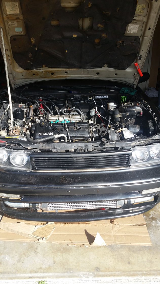

So today i will attempt to replace the entire timing chain and etc....
Bought new exhaust studs, knock sensor, thermostat.
Wish me luck.
Any pointers on this repair

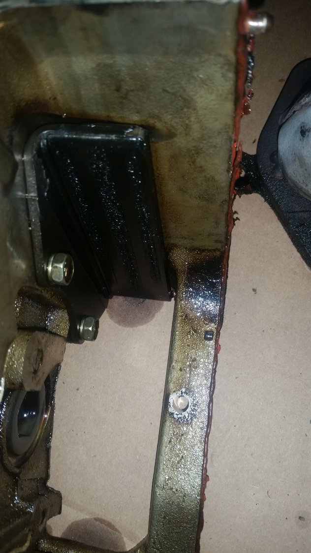

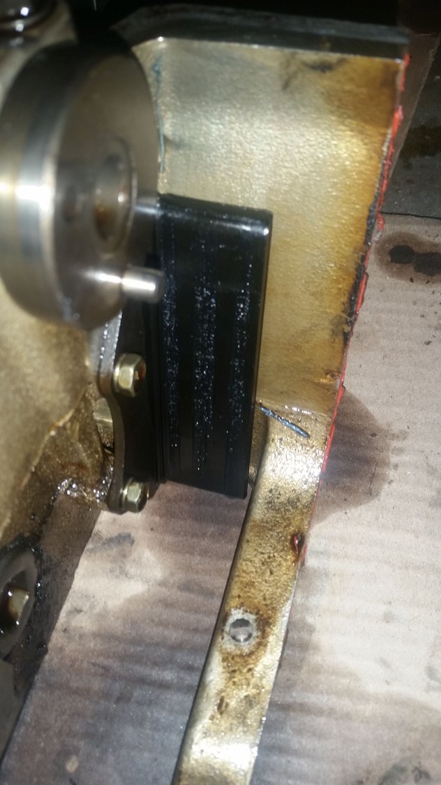

Ill finish tomorrow
In this picture you notice broken piece of timing chain guides that are made of plastic smh. This is why my car wouldnt start. It was off timing.

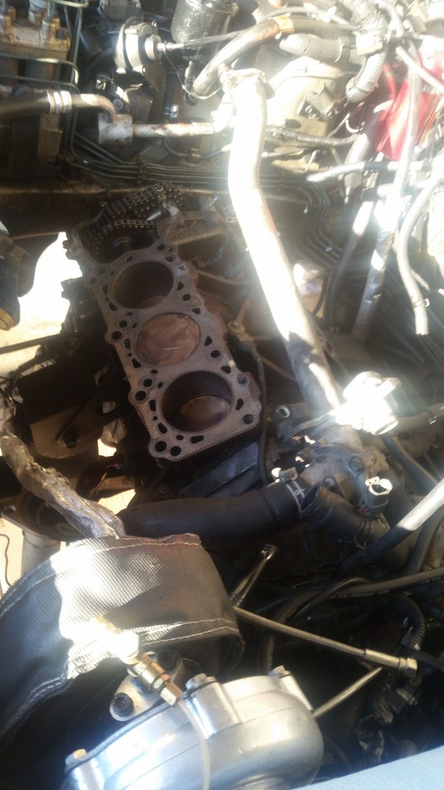

Pretty much what i had plan was to take it all off but ill make sure crank is at tdc. Then install chain n 2 upper chain then turn 120* when installing the cams. I'm going off the fsm
https://i.imgur.com/YTgA3Jq.jpg

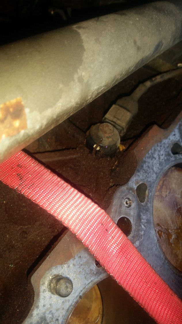

Here the old guide wear out on left cyclinder head.
Here the right cyclinder head
Here a crack knock sensor

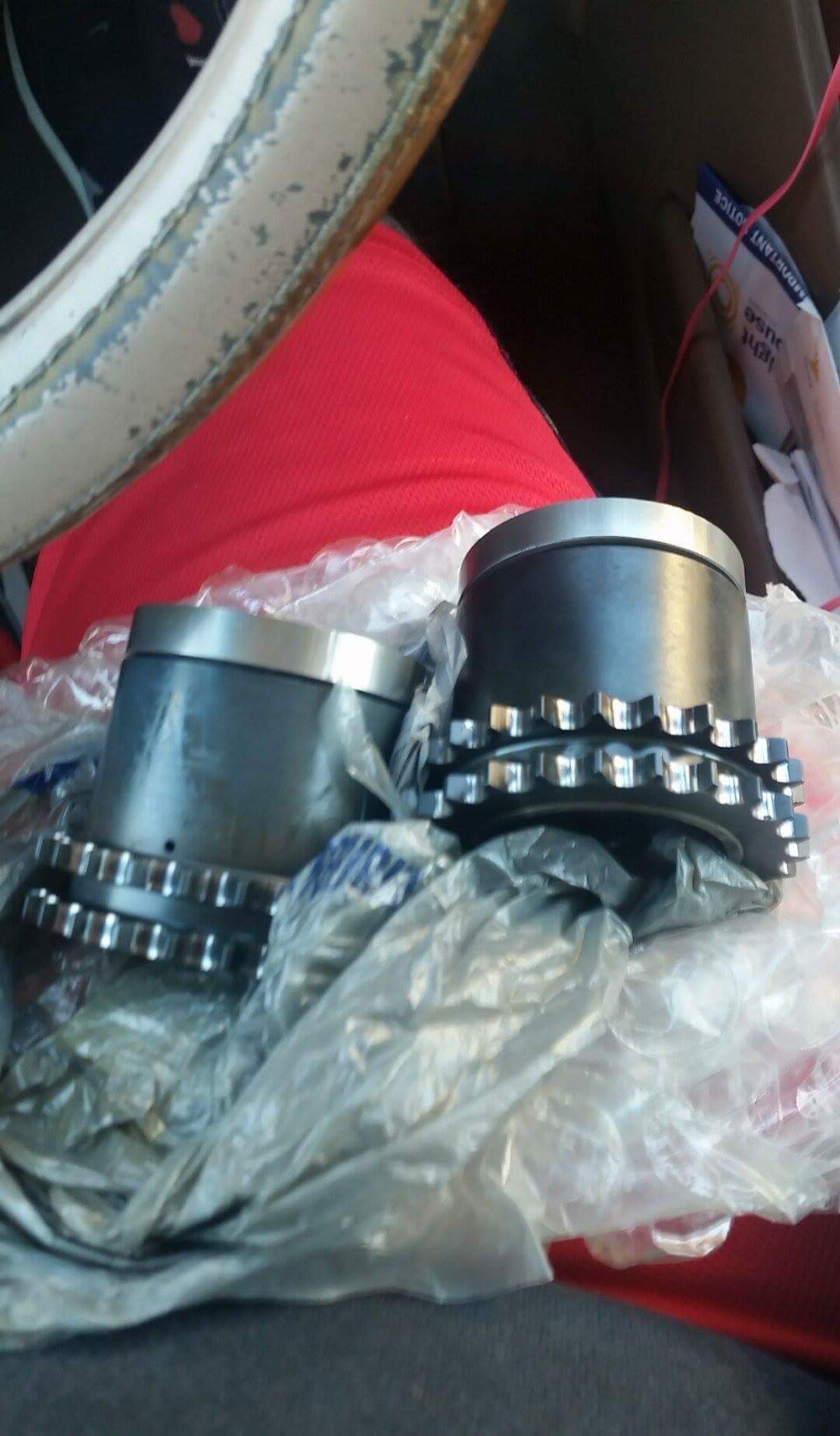

Rebuild vtc by jeff. Ready to install

Tony, You mentioned in your last post your running q45 370cc injectors? Why are you still using those injectors on a stock ecu? Might a good idea be to go back to the stock injectors? Sounds like maybe when you pull the fuel pump fuse and crank it your ridding excess fuel thats probably been dumped in by those large injectors then putting the fuse back in it starts and idles for a little then the injectors are dumping too much fuel in the cylinders causing it stall out again. Maybe try going back to the stock injectors. Keep your rail with the larger injectors for later when your ready and pull the rail complete with injectors off the scrap ve you were pulling parts from . Just a thought.
Old Mar 25, 2016 | 10:54 PM
TonyJr's Avatar
Joined: Sep 2011
Posts: 1,048
Im planning on taking the fuel pressure regulator and injectors from ve at the junkyard. My car ran good with the 370cc for about a week before the timing chain went to crap on me.
I installed the 370cc with stock ecu cuz i was heading to the shop dyno to get tune with the nistune. I was going to swap ecu at the shop. With my luck the power steering went out that day so i replace it. After installing pump i was driving to shop and timing chain went to ****. Smh bad luck
But you guys are right. I believe whats happening is 370cc are flooding the engine. That's why when i release fuel pressure and crank it again it starts up. I guess ill put back stock ve until i get to the dyno then switch it at the shop
Old Mar 27, 2016 | 12:08 AM
Maxpwer's Avatar
No turbo, no care!
Joined: Oct 2001
Posts: 760
From: Chicagoland
I'm surprised your car ran at all with 370cc injectors and the stock ECU. I would swap back to your stock injectors and change your oil as you've likely "washed" your cylinders.
Old Mar 27, 2016 | 02:44 PM
TonyJr's Avatar
Joined: Sep 2011
Posts: 1,048
installed stock injectors today and car started up. doesn't hold idle tho. I crank it once more and engine lockup i crank it once more and engine spin once and lockup again. im lucky that engine wasn't running when it lock up (a starter does create enough force to bent a rod or crack a piston). smh due to oil fill up with gas. I changed the oil and it was literally liquid thin. I left engine with spark plugs off and will let it sit for a day or 2. let gas evaporate. before I crank it again I will pour oil in spark plug holes and crank engine with disable spark and fuel a few times before I start it with spark and fuel. at first I though my starter was going bad but I notice oil wasn't oil no more when I was in the middle of changing the oil.
Old Mar 27, 2016 | 05:53 PM
Tiniform's Avatar
Joined: Nov 2012
Posts: 249
From: Fl, USA
Jy engine only has 95k, you may want to consider getting it.
