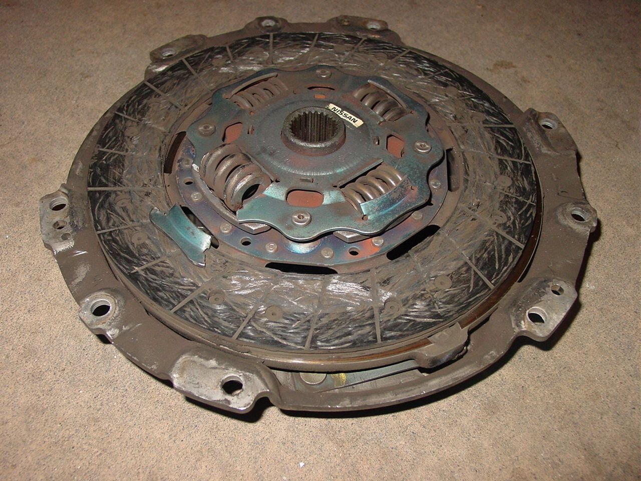

Hey what's up man, still got that max? I ended up dropping the transmission because I spent more than enough time bleeding the system, I even swapped slaves with a spare that I had on hand. Both gave me the same result. So it was pretty apparent that the hydraulics were not the issue. I didn't even have to take the clutch housing off to see the problem.
So the displaced spring was jammed in the diaphragm keeping pressure against the flywheel. Thankfully I had a Valeo clutch kit that I bought probably 8 years ago for $30 from some local guy. I wish it were OEM, hopefully it doesn't feel much different than what I'm used to. Took the opportunity to replace my steering rack as well which I needed to do for a long time but was dreading. Not too much room to work there when the transmission is installed.

The broken off tab feels like under-engineered compared to the springs.

It's kind of skimpy, but it did last 26 years (155k). I may have initiated the damage a few months ago, when I tortured the clutch a couple times. Felt different for at least a few days, or maybe I just got used to it.

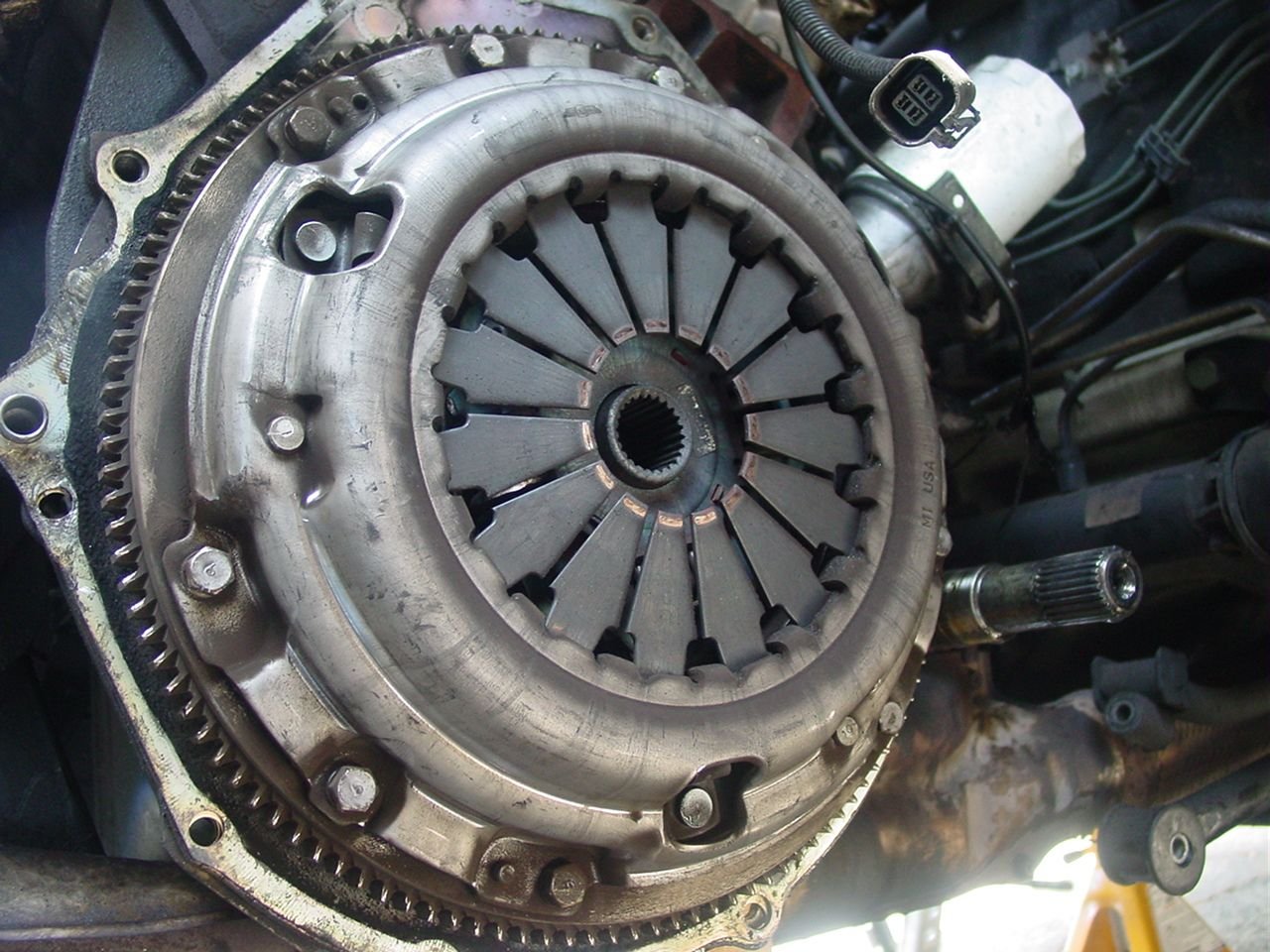

Got a good shot here of the new clutch with the starter, radiator and condenser out.
