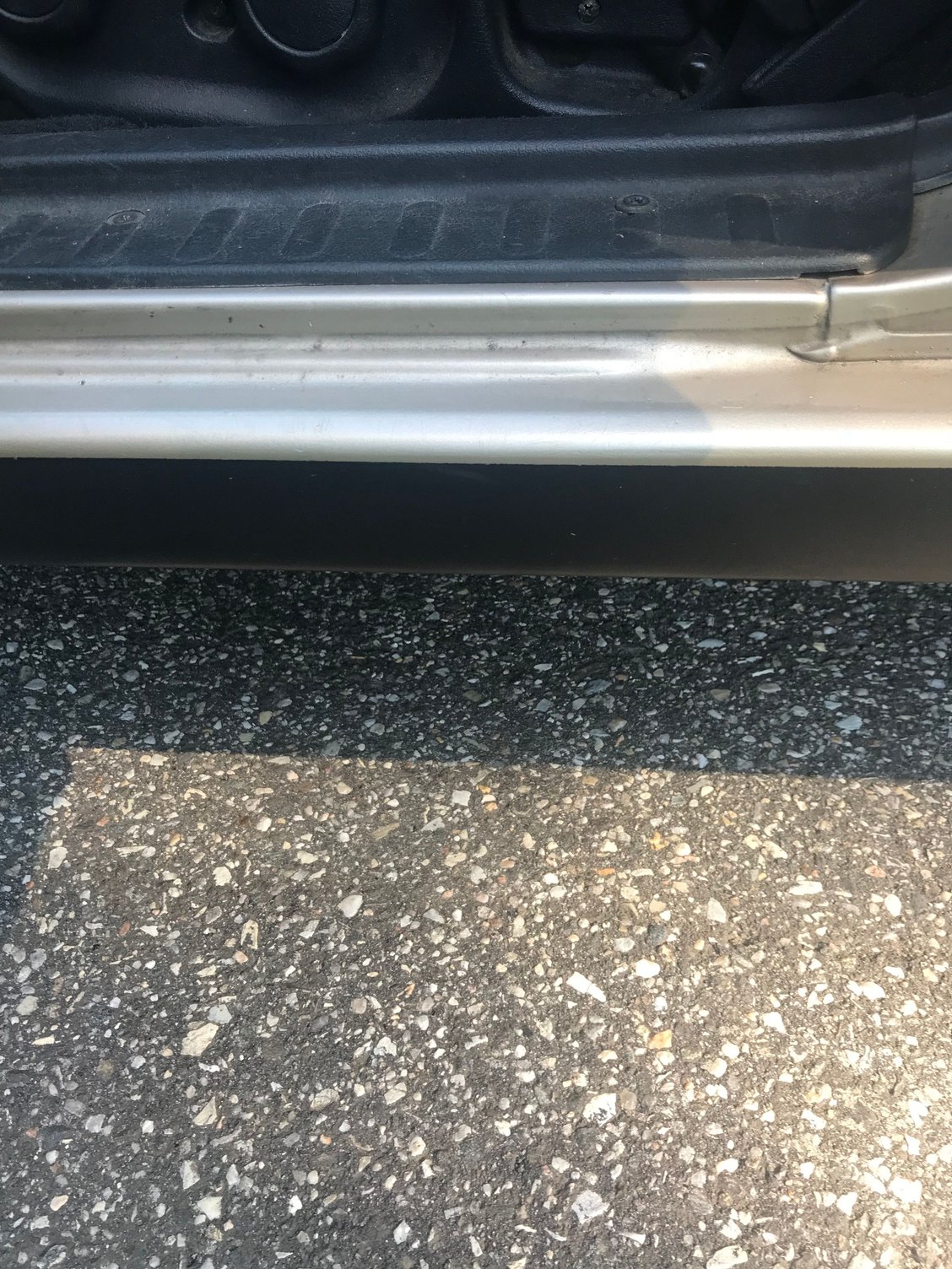

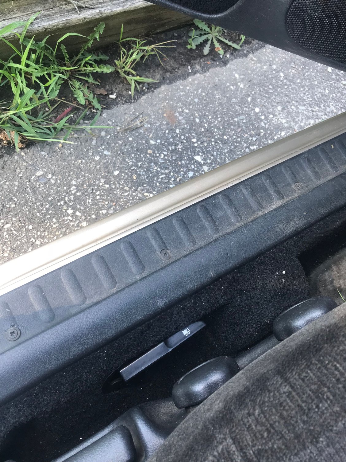

im having a problem with my 1993 se whenever it rains. My door jambs on the driver side get full of water whenever it rains and I’m not sure where the water is coming in from.

Well if you want to get technical the pic you posted is of your rocker panels and the same principle would apply. If need be just drill a couple small holes for drainage. It's not rocket science and there's no need to be rude to people who are only trying to help.
