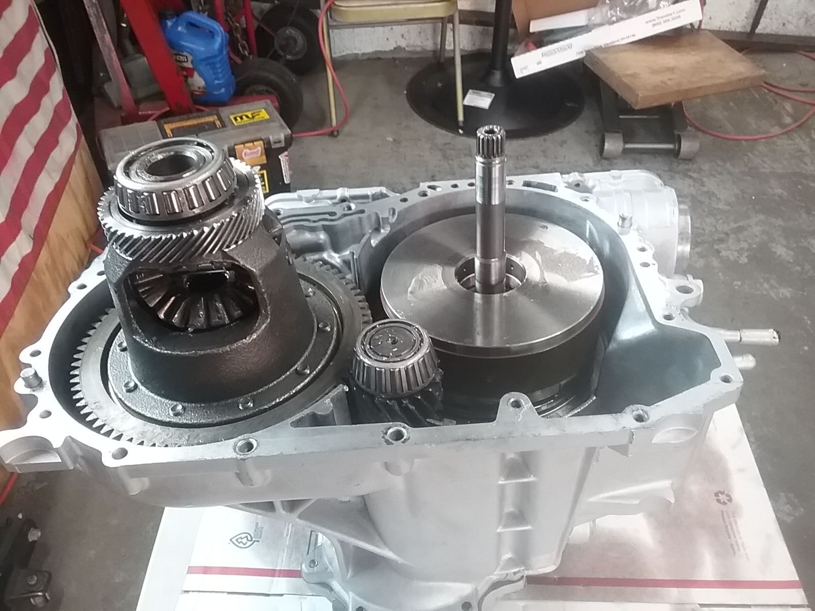

...did a couple more hrs on it today...the two half cases are stripped of all parts To base now...bought a large plastic storage container and filled it with cleaning solution and soaked both parts in Purplepower and hot water..used a brush to clean to tough spots...looks decent....im seeing some excess wear behind the oil pump on the casting...looks like high milage grooves cut into the aluminum...I saw a video on the tube and he mentions taking it to a machinist and cutting it flat to ensure pump pressure doesnt bleed off.....I 'll price around and see what that will cost or see if a new bell houseing is available..doubt it....tomorrow I'll test the solinoids for functioning.

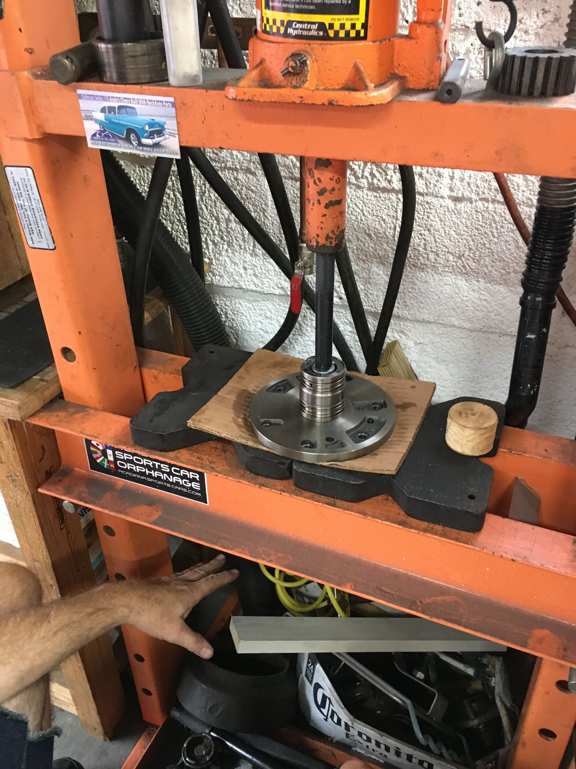

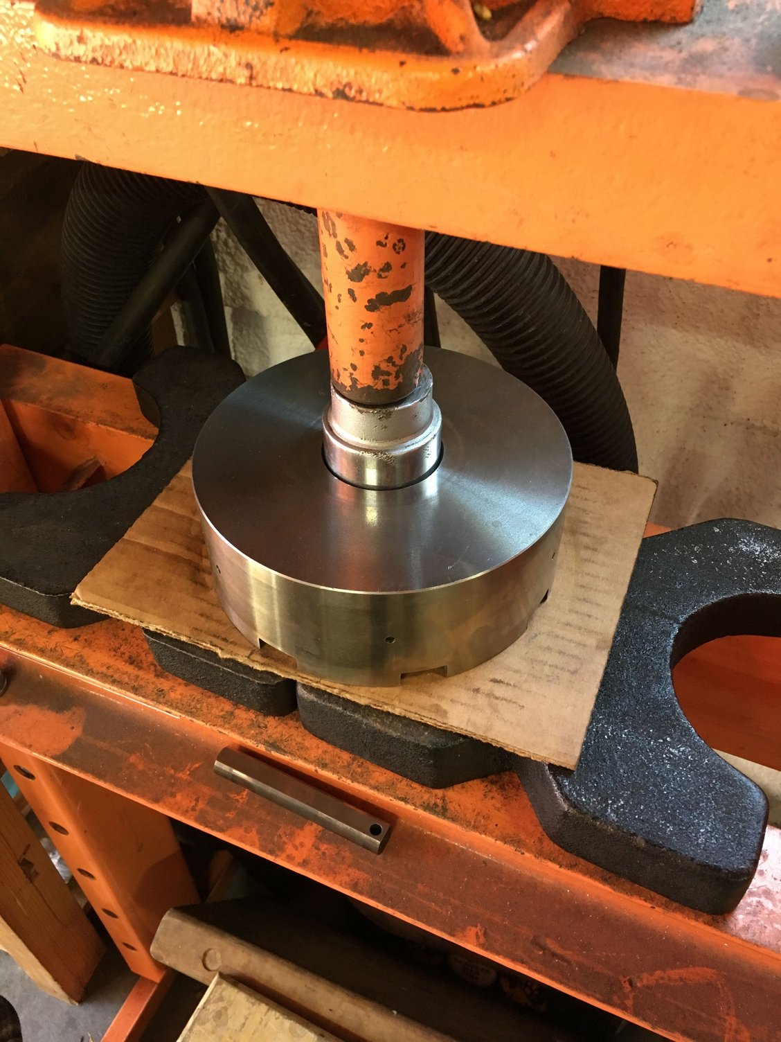

...overhauled the oil pump!....I had to buy a blind hole bushing remover (Harbor Freight) to extract these parts...I used my press to carefully press the new replacements to the proper depth and oil feed location.

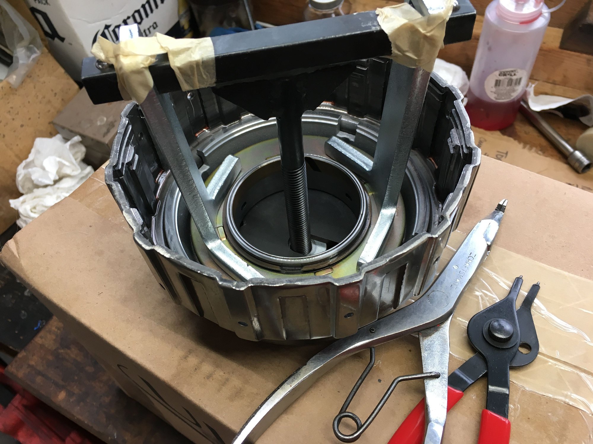

...overhauled the high clutch assembly...New seals, frictions, and steels...I was able to add a extra steel by carefully scrapping/sanding off the clutch material on a old clutch piece and reinstalling...it allowed it to be set in the lower end of the specified clearance range of .055 - .071"....also air checked the assembly and the seals are not leaking...not a easy task getting those to install.

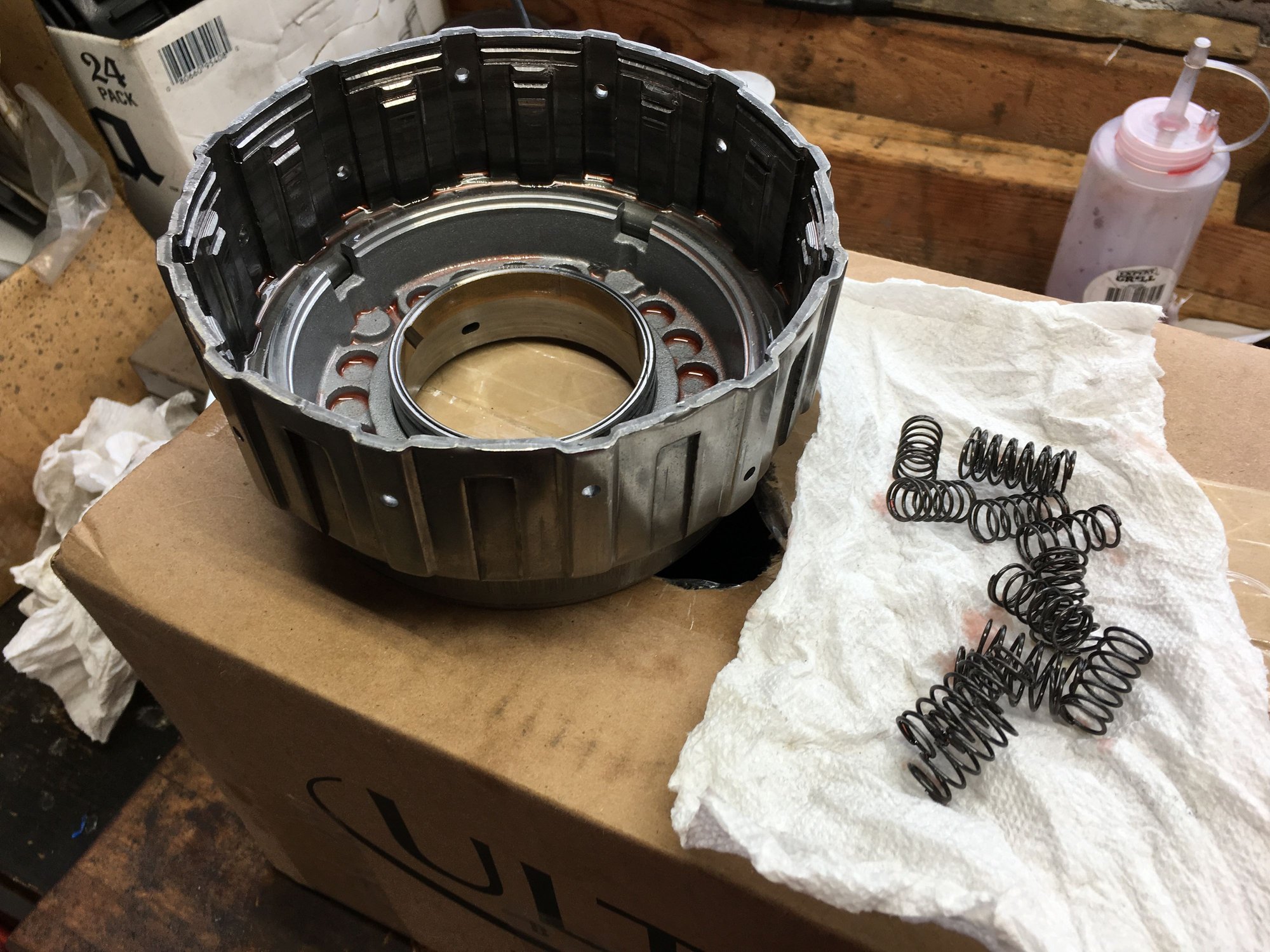

...more progress on the rebuild...overhauled the reverse drum with new bushing, seals and frictions/seals...also started adding the recommended parts from the TransGo kit.

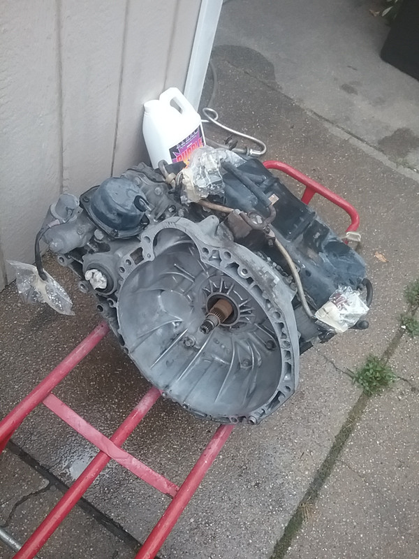

update...I bought a rebuilt torque convertor from PhoenixTrans on EBay for $130 shipped and a rebuilt Rostra valvebody with all solinoids for $240...rear main seal was $8.00...2 gallons of Wal-Mart Dex3 fluid.($20.00)

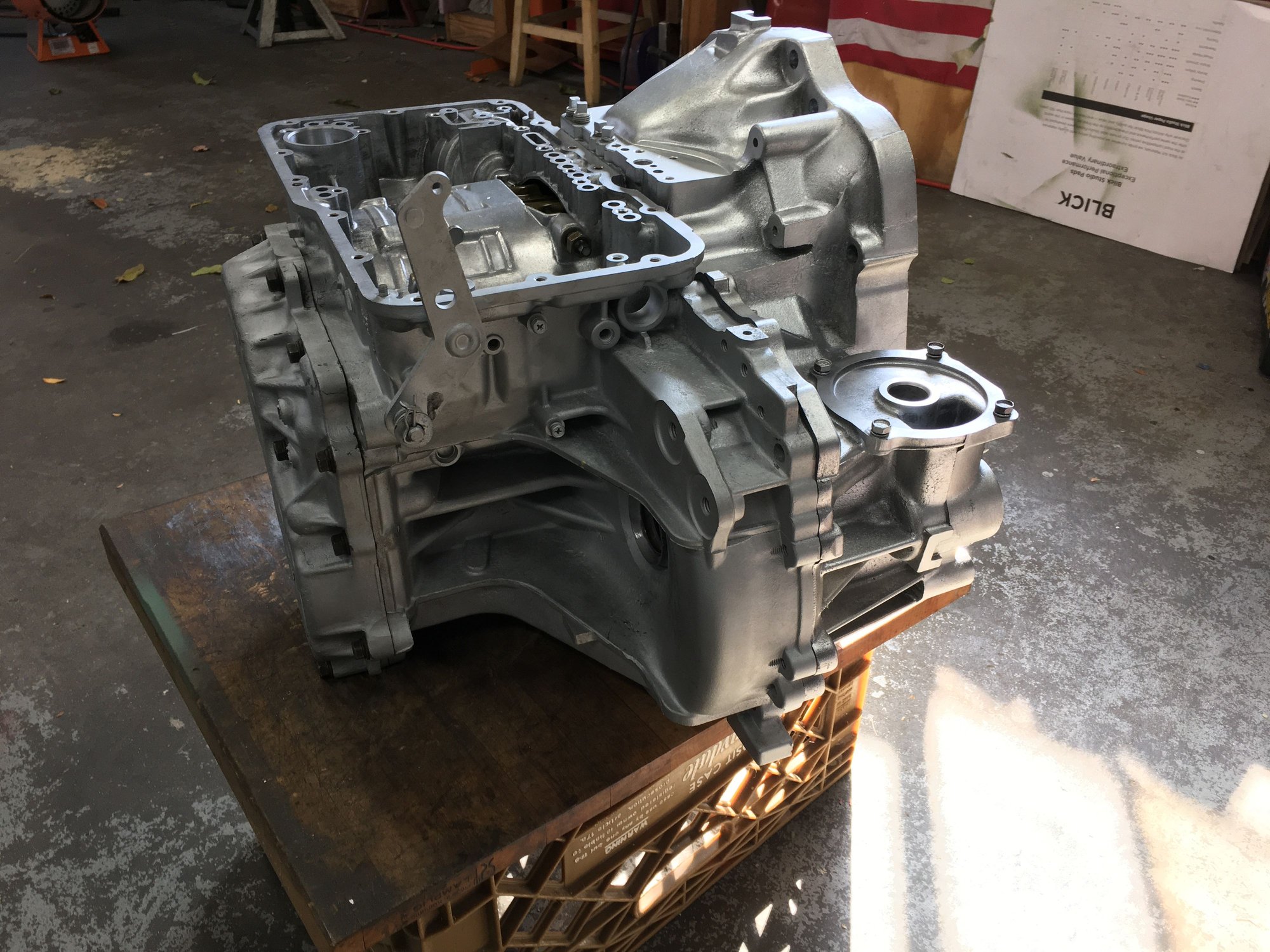

...installed the low clutch /reverse brake assembly in the bottom of case today...really sucks to get the new seals on the piston to drop into the case, but its done...tested it with compressed air and it snaps into operation...ve

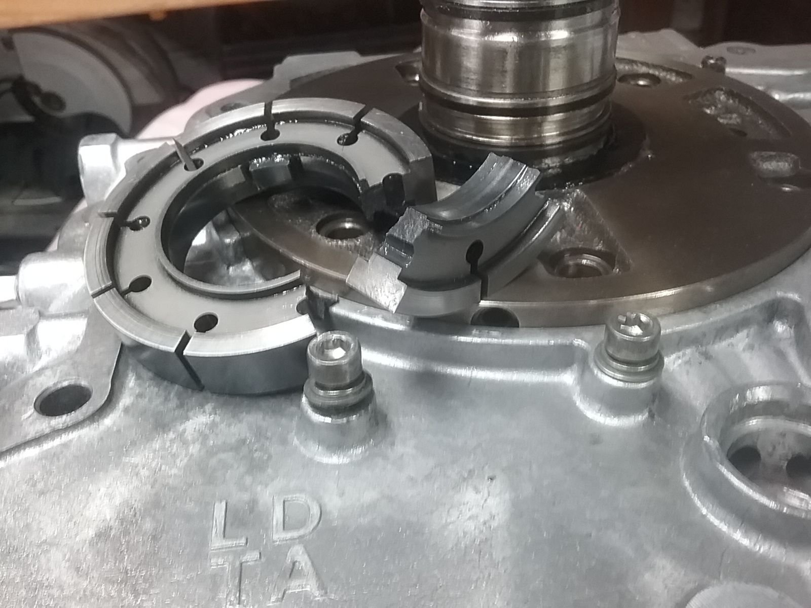

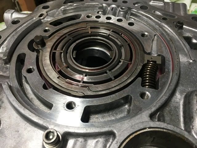

...damaged the oil pump on reassembly by cracking the vane retainer..stupid mistake....if someone has a spare they want to sell please send a message.thanks.

Did you find a replacement for this? Really sucks to see that broken. How'd you break it? Is it a press-in part and just cracked it?

James....I'm thinking one of the pump rotors slipped out of position and was actually under the retainer as I was tightening in a cross cross manner......I suppose that caused the split...frustrating ,as it was assembled a few times already...the pump retainer or pump is not available anymore, I have searched high and low....project has been stalled in the garage....can you help locate one? LOL

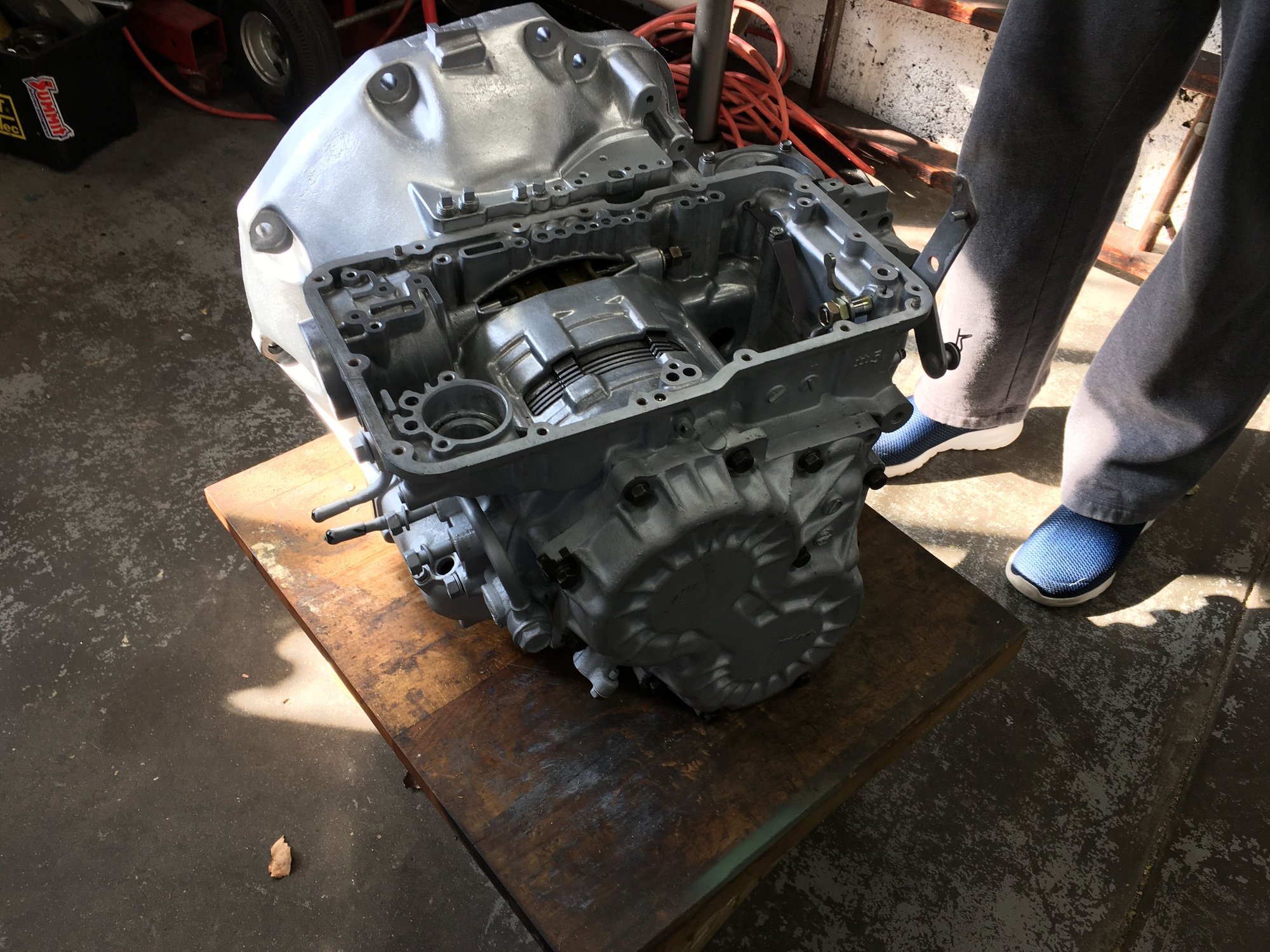

...installed the oil filter ...than the paper gasket and placed the converter housing onto the case and carefully lowered into position..rtv on the bolt threads that enter the oil passages, anti seize on the others and torqued it down to spec...installed a cv axle and spun it and it seems good...no binding.

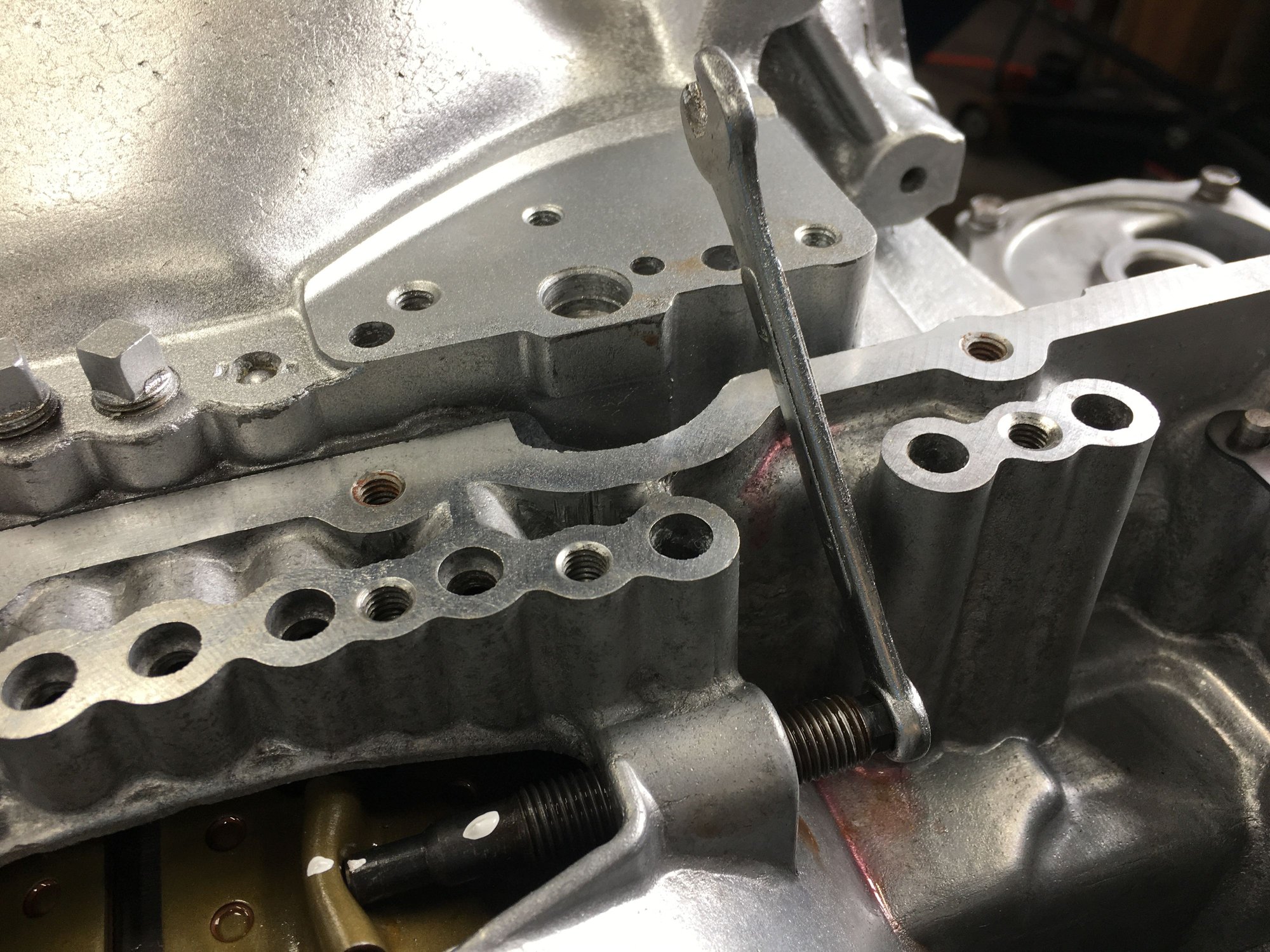

...set the brake band at four turns from snug by following the tip in the TransGo kit...btw, factory is set at 5.25 turns...I painted a white line to count the revolutions.

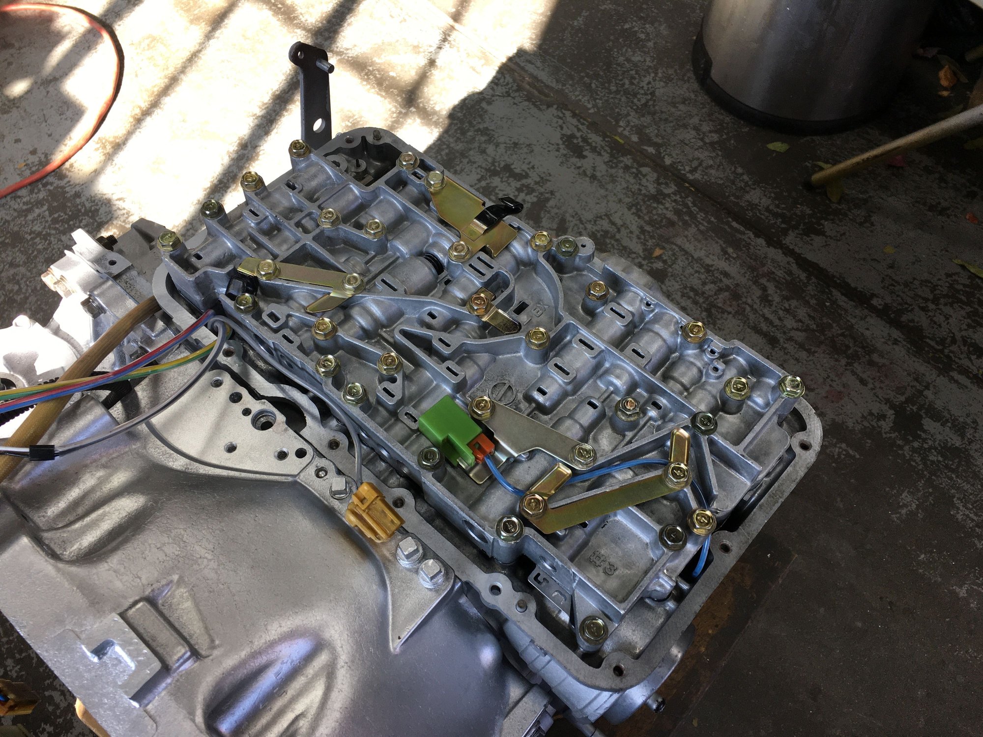

...disassembled the valve body to install the Transgo "white" spring in the pressure regulator channel and also to drill a .0775" hole in the separator plate...it's ready to be mounted on the case tomorrow.

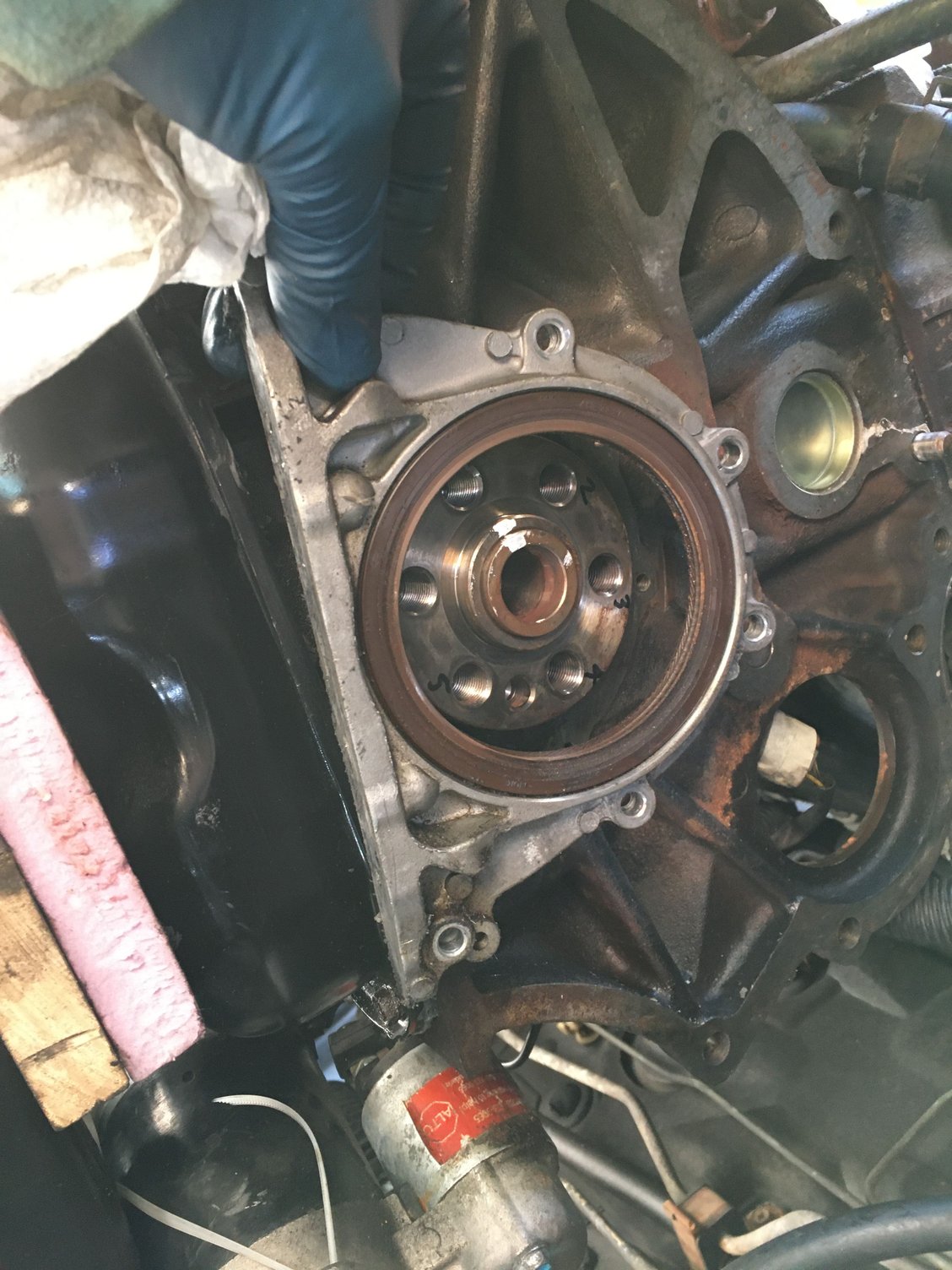

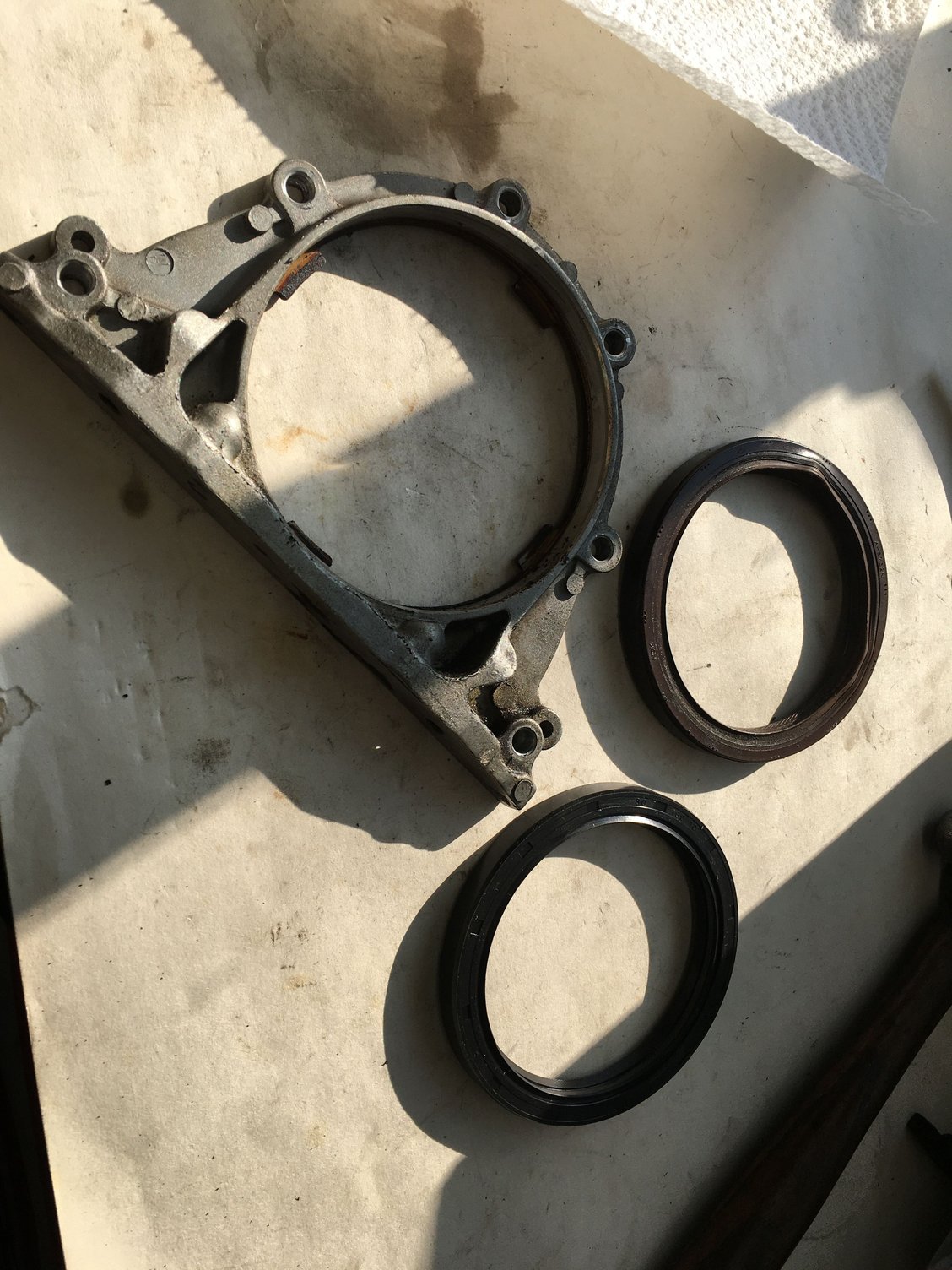

...decided to replace the rear main seal while I had easy access.

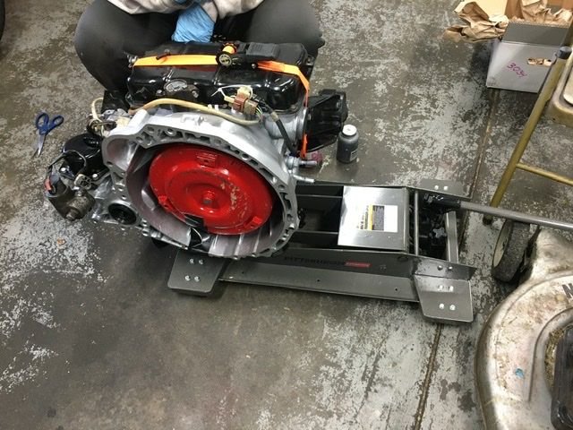

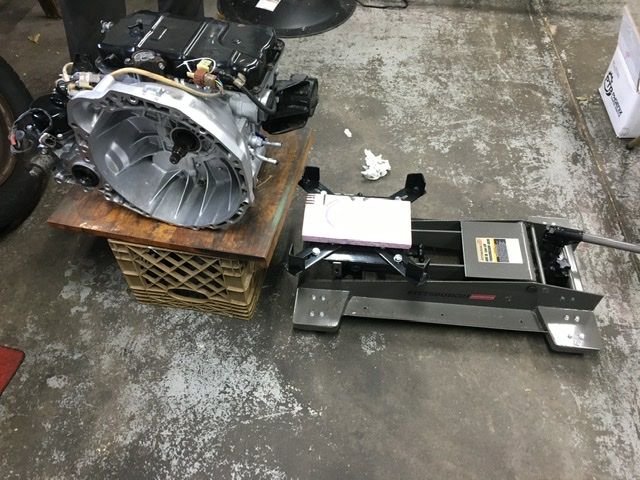

Thanks James...I went to Harbor Freight with a 20% off coupon and bought a decent trans jack...no way I was using the floor jack to get this back into the car..I also ordered a rebuilt steering rack and hoses to replace since it’s a breeze to get at everything.

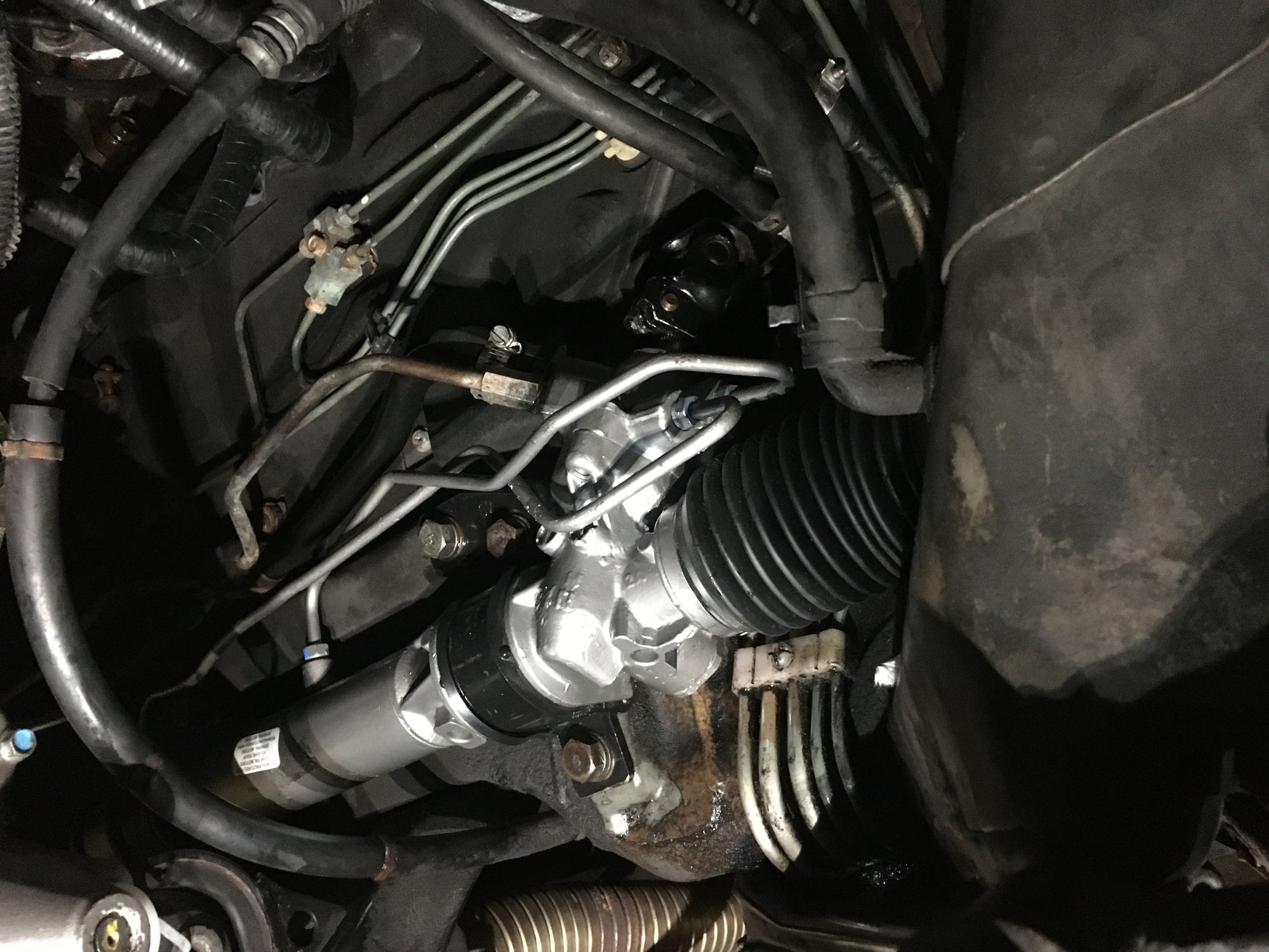

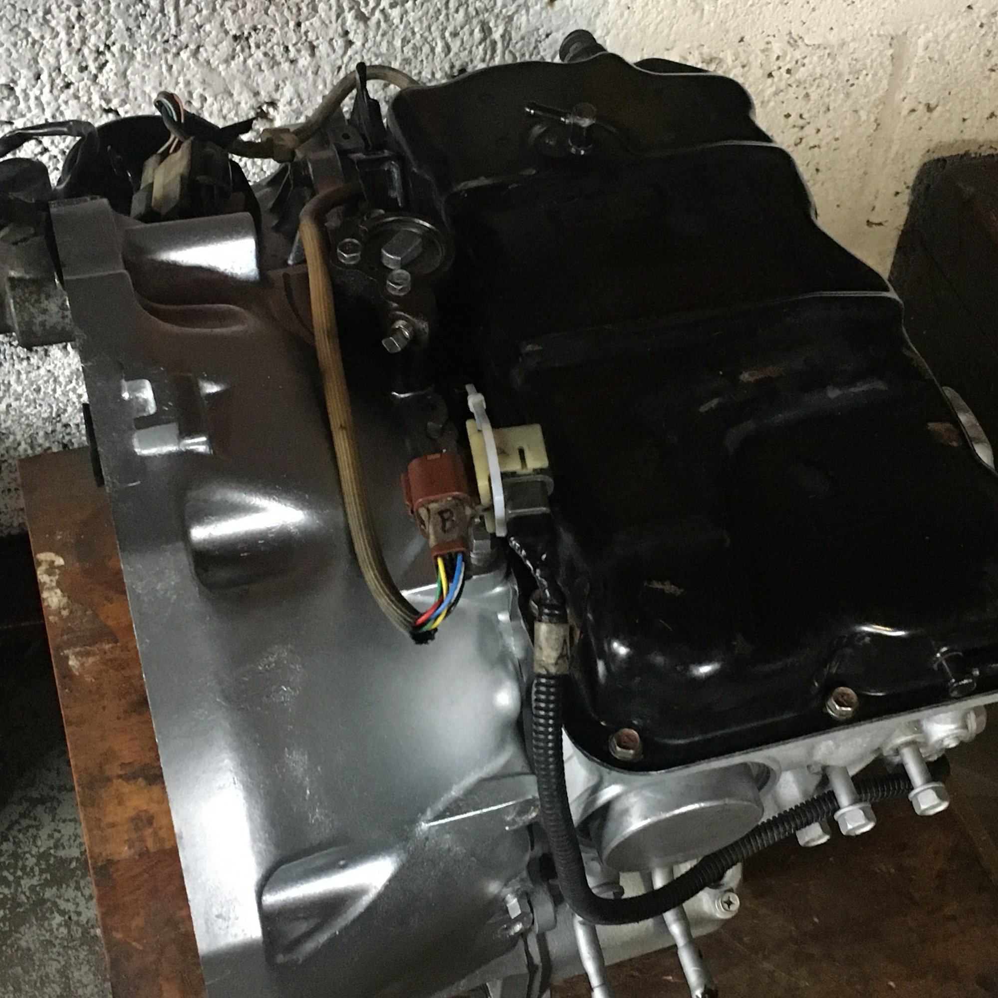

...installed the rebuilt steering rack today.

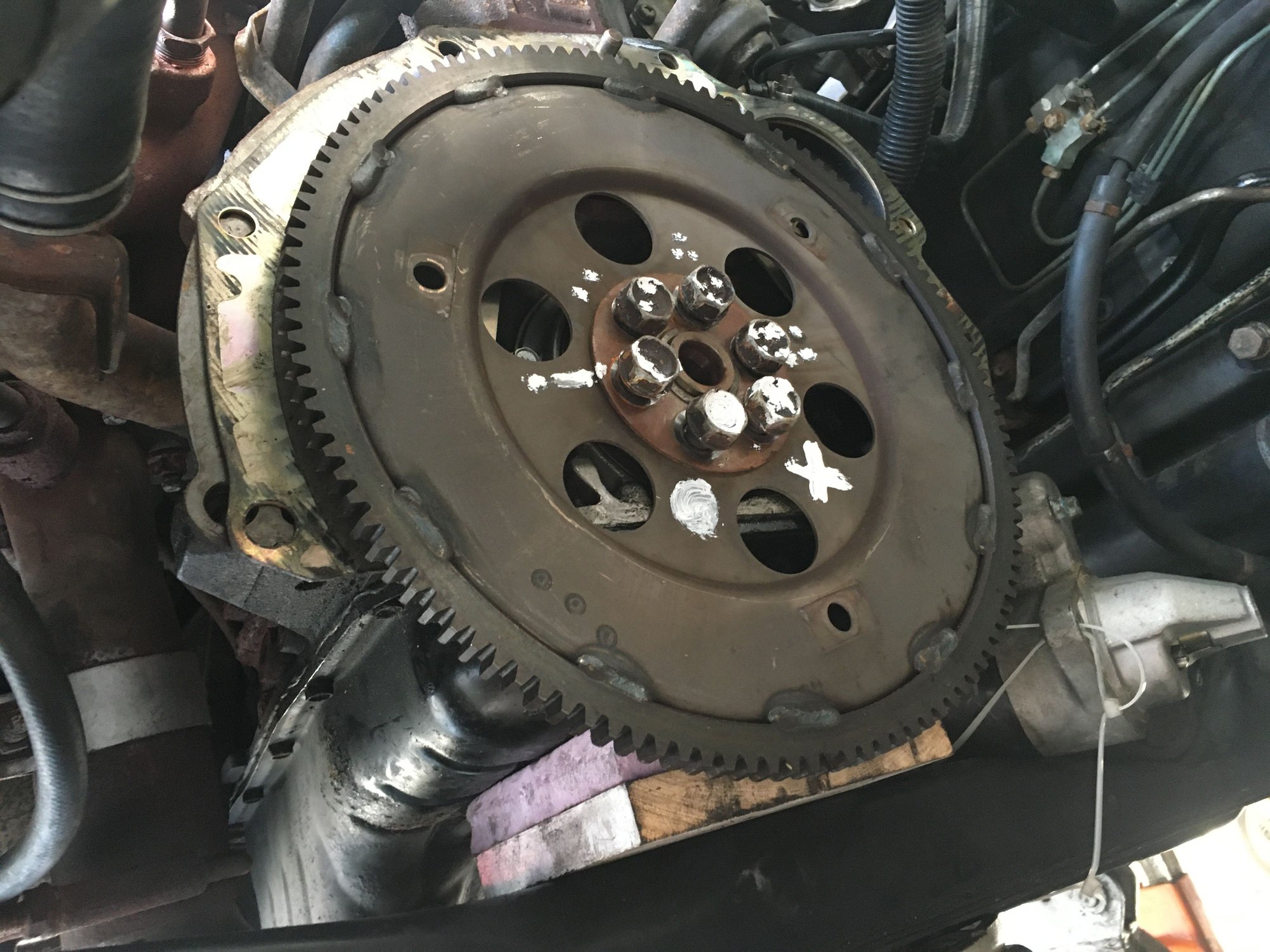

...started the reinstall and it’s attached to engine and one tranny mount...tomorrow will be the second mount and the assorted electrical connections, cv axles, etc.

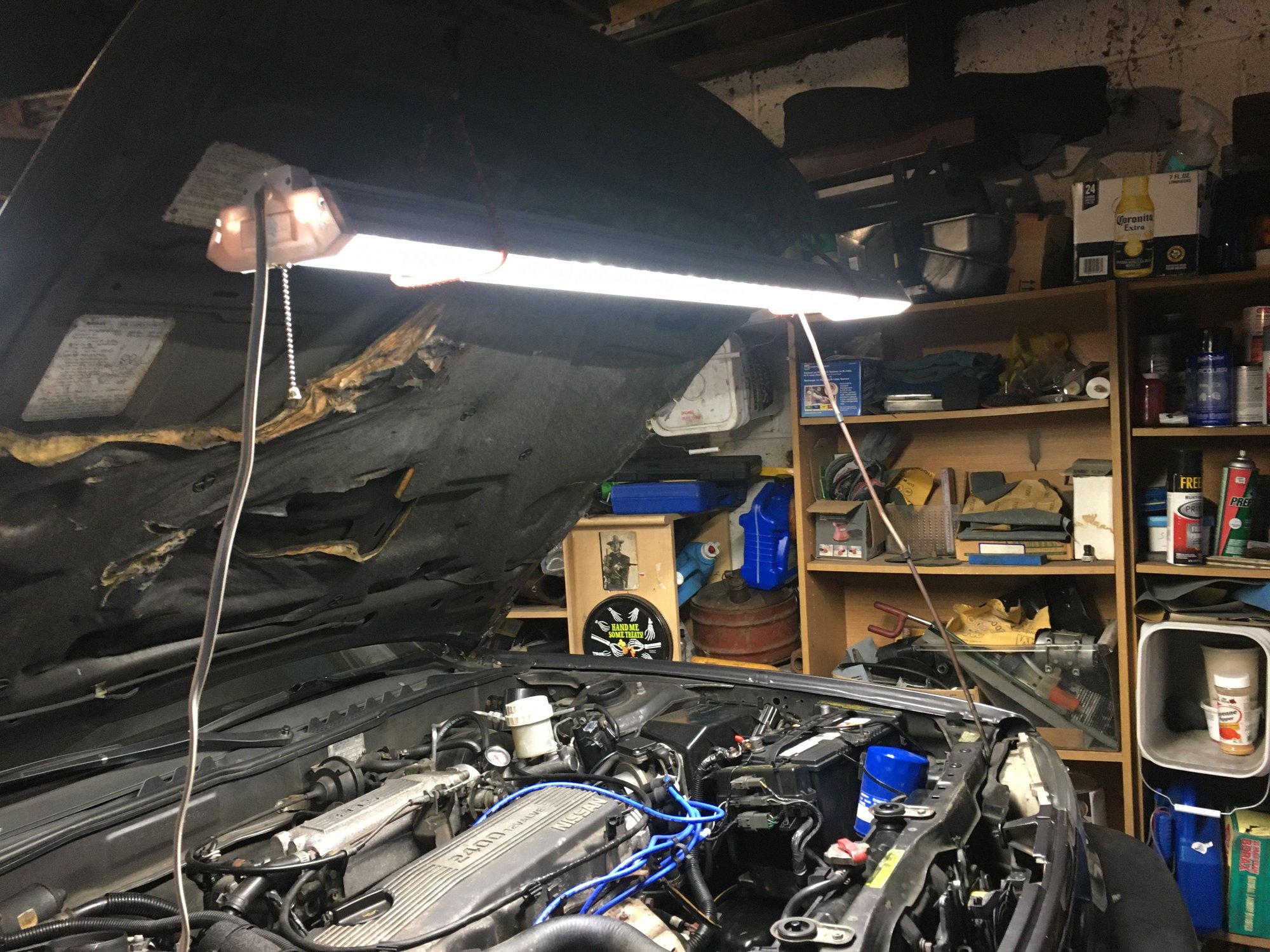

...Harbor Freight light and bungee cords.

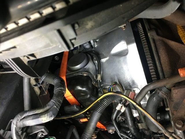

...getting closer to wrapping this up! Installed pass cv axle, elect connections, shifter cable , dip stick.
