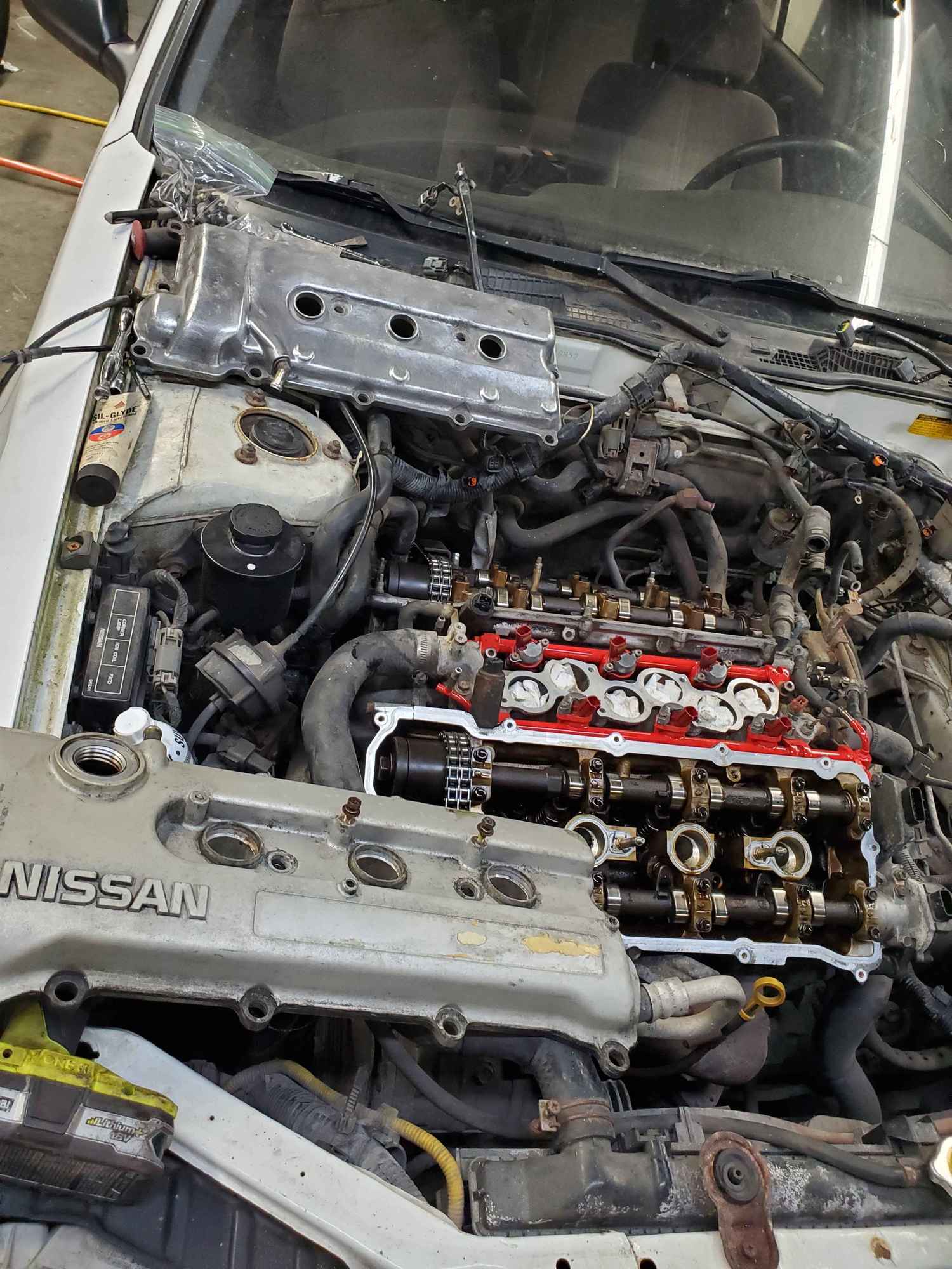

It's home. (= The frame and body are actually in pretty good shape. I thought there would be a lot of rust. Here's what I have found so far.
The middle fuel injectors don't seem to be doing anything. I'm going to try to probe them in the garage to find out why, but it seems to be a common problem. There's a random unknown wire with (I think) 12v coming out of it. I cut the end, but I don't know why it's there. It's a bodge or bypass of some kind. *shrug*
Also, after idling for a little while, all of a sudden it had valvetrain sound on the back. If the RPM's go really low (500-ish), the rattle stops, so I kinda suspect bad lifters.

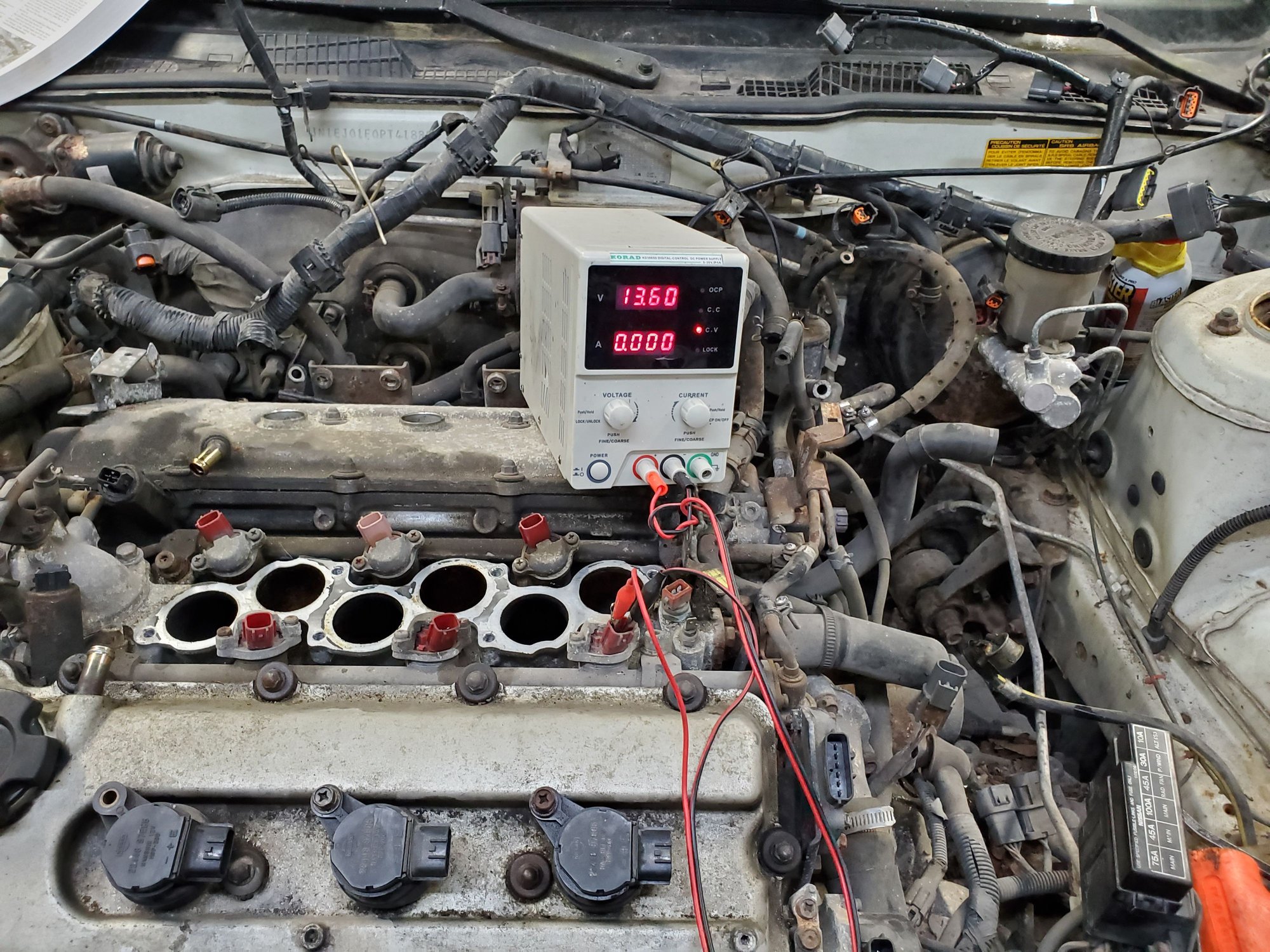

I'm going to take back what I said above. My first step was going to be to backprobe for signal from the ECM to the injectors, but there are several connectors on the engine that merely *touching* causes changes in behavior. My first step is going to be to CLEAN as much as I can of the engine wiring harness. Many of the connectors are toast. I may need to source some new connectors.

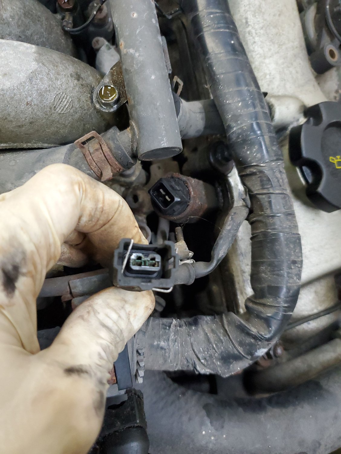

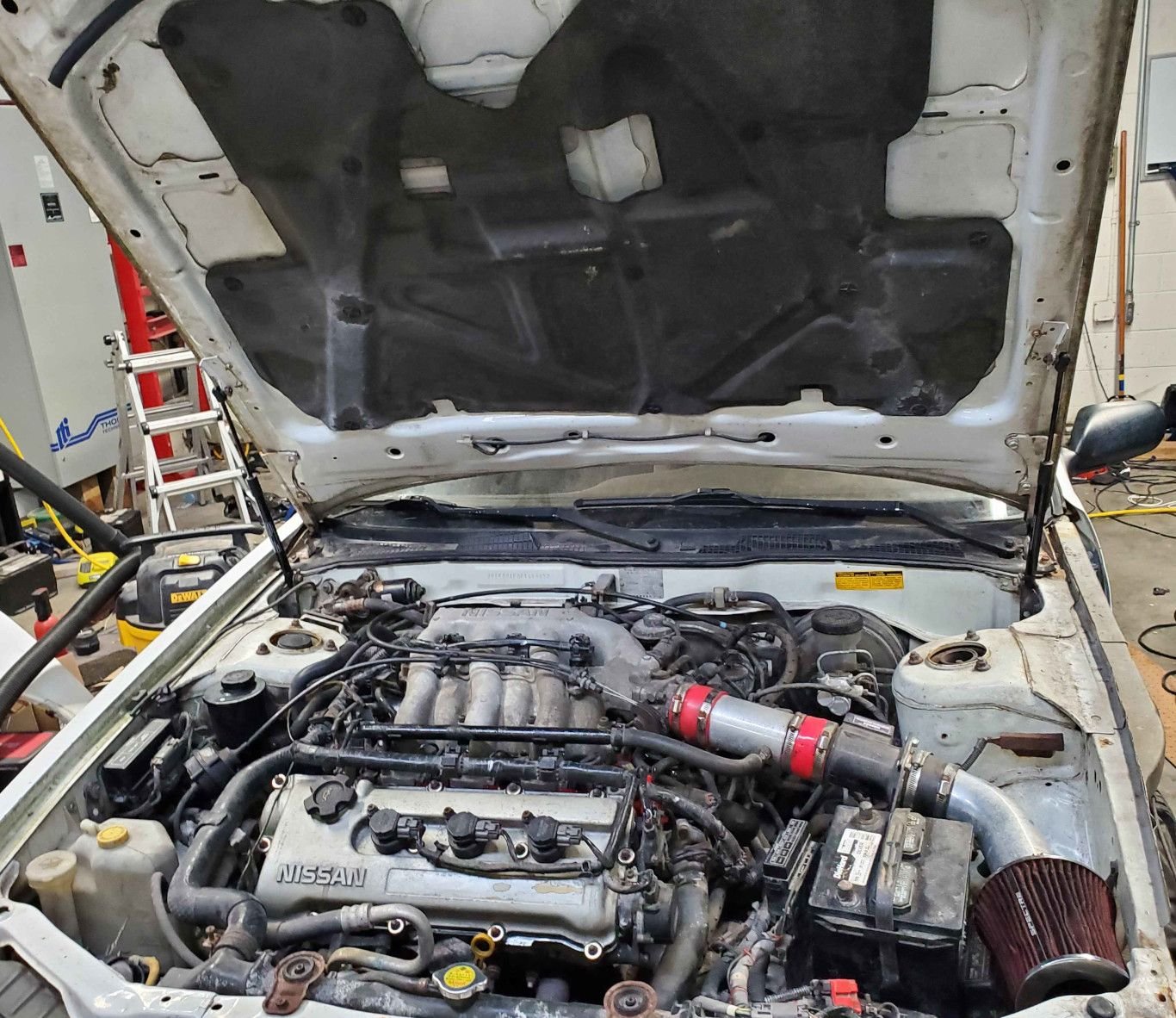

I yoinked the hood off for quick access. What a difference it makes.
Many of the connectors look like this. I don't think anything is shorted, but it's going to need some major Deox-It and scrubbing. I hate these connectors...
Aaaand guess why I'm running on 3 cylinders. :-D I'm really happy to have a positive diagnostic for my problem. Three injectors don't draw any power. Three draw 3 watts and work fine. Fortunately, it doesn't seem that any of them have been shorted, so the ECM *should* be fine.
Time to order some parts and supplies. I'm going to start editing the first post with my project checklist, too.

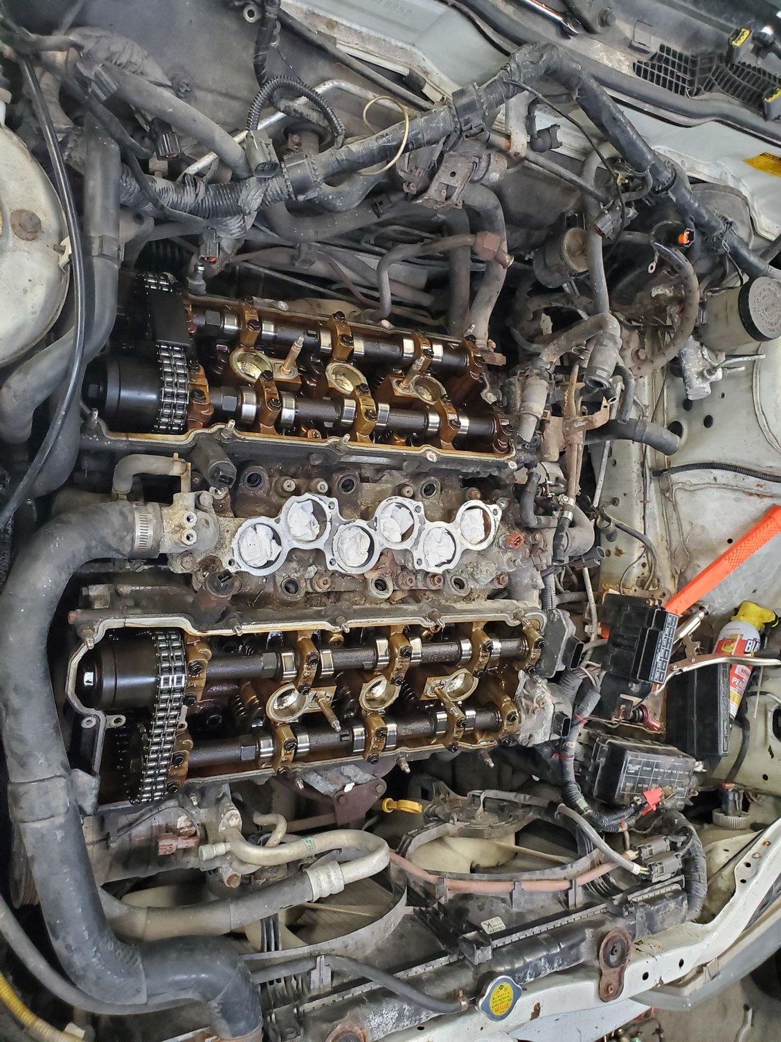

I'm not familiar with this car, so it's taking me a little longer to take my time and make sure I do it right. So far I'm not really having any major problems with the rusty bolts, except one fuel injector screw head is completely stripped, and one ignition coil bolt is snapped off in the valve cover. I'm not totally sure how to get that one out. I could try welding a nut to the top of the stud, but I'm afraid the welder would mess up the aluminum around it. I could put it in the drill press and try to drill the hold out, but I imagine I'm going to mess up the threads. There's just barely not enough of the stud left to grab with anything.
New injectors and gaskets are due in next week, so I'm going to start working on other parts of the car and other cars. The speakers are completely blown out, and the rear doors are extremely sticky. I soaked the hinges and hold bars with white lithium WD-40, and it helped a little bit, but they're still do tough that my kids probably couldn't open and close them.

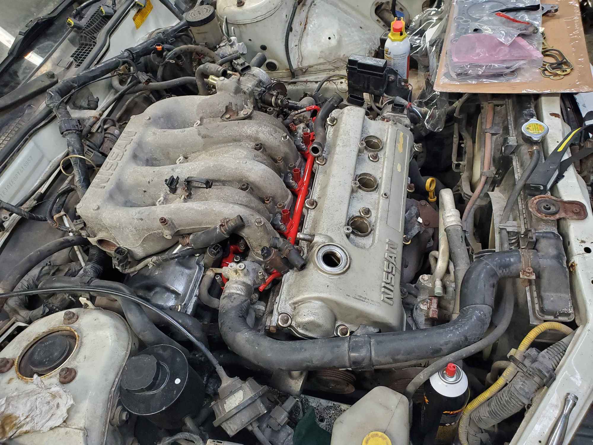

Good thing I didn't have to do head gaskets, since the package was FOLDED! It sure includes a lot, though. They threw in valve cover mounting grommets, fuel injector O-rings, and even a full size tube or RTV ultra gray! I do wish it had the fuel rail grommets, but I washed mine and cleaned the holes pretty well.
The fuel rail anodized zinc coating was coming off, so I etched them pretty well and coated them in "No More Drama" red. The fuel rail never gets hot enough to need VHT, so I went with a gloss enamel. I wire brushed the fuel injector caps. They're aluminum, so they're fine as brushed aluminum.
The rear valve cover is also just aluminum, so I'm brushing it. The front valve cover appears to be lacquered or similar. The badge came off alright. I'm not entirely sure what I want to do with it, but I'm leaning towards stripping it with B12 and brushing it to match. Fortunately that's really easy to figure out at a later date.
Work kicked my butt, so I didn't get terribly far, but here's my progress.

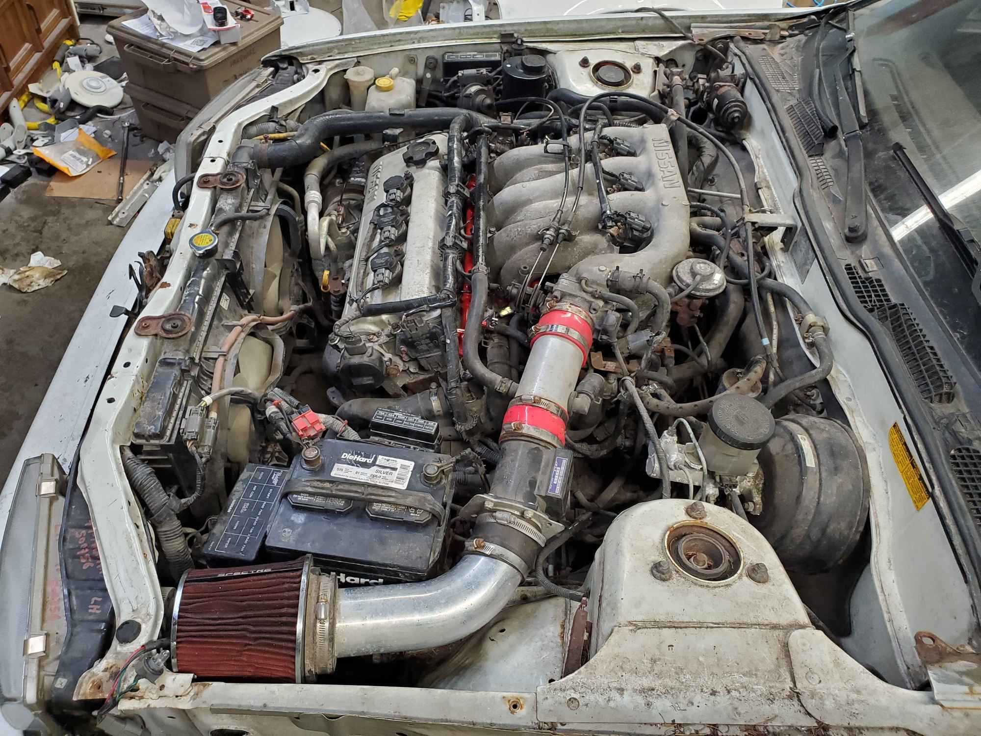

It's together, and it runs smooth and strong! I even balanced a screwdriver on the air plenum while it was idling. ;-) Everything worked perfectly and smoothly right off the first start, so I'm tickled about that.
Buuut...I do still have a few things left to figure out. The shifter sticks. (It may also be low on transmission fluid.) The rear valvetrain sometimes starts rattling, but it seems to come and go with some sort of intelligence. Is the rear VVT going out of phase? I didn't notice any slack in the chains when I had the valve covers off. The hot/cold slider works, but the HVAC output control does not. It stays on face+feet, which is a problem, since it's required by VA law to be able to defrost the windshield. I'll get into the book and see if I can understand how the system works.
The steering stalk seems to be *almost* working. Turn signals and headlight/parking light work, pushing forward puts on the high beams, returning to center has high and low beams on. If I push the lever forward, it goes back to just low beams. That also won't pass inspection.
The power mirrors don't seem to do anything. The window controls on the driver's door will move the driver's window down and up, but it will only move the other three windows down.
The exhaust clearly has no cat converter. That's a delightful smell! I just don't want to smell it when I'm waiting at a bank drive-through. ;_; So, I'll be adding a cat. I'll also be adding a muffler and a resonator.
The radiator core support is reeeally rusty. There aren't any holes yet, so I think I can save it.
Honestly, though, it's just about ready to drive. Other than a few fairly little things, I think it's good to start driving around on a daily basis. Errr, I mean it doesn't have a hood...or a fender...or insurance and license plates...or most importantly, a stereo.

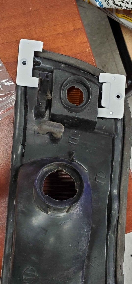

The turn signal lens isn't bad at all. It's just missing the teeeeny fragile plastic tubes that held it onto the fender. Instead, I attached these white PVC pieces (from Ubiquiti POE injectors). I tried cyanoacrylate, but it popped right off. Soo, I did it again with long thin films of JB Weld. That ought to do it!

Fixed the HVAC...there was a missing fuse. It still failed inspection. One of the high beams didn't turn on for the inspector. It's a little crunchy. I have another light switch coming in. I could show them how to do it, and it will *probably* pass, but eh... Also the 3rd brake light, which I moved to the back deck, decided to stop working. A little Deox-IT and some LED bulbs, and it's right back.
