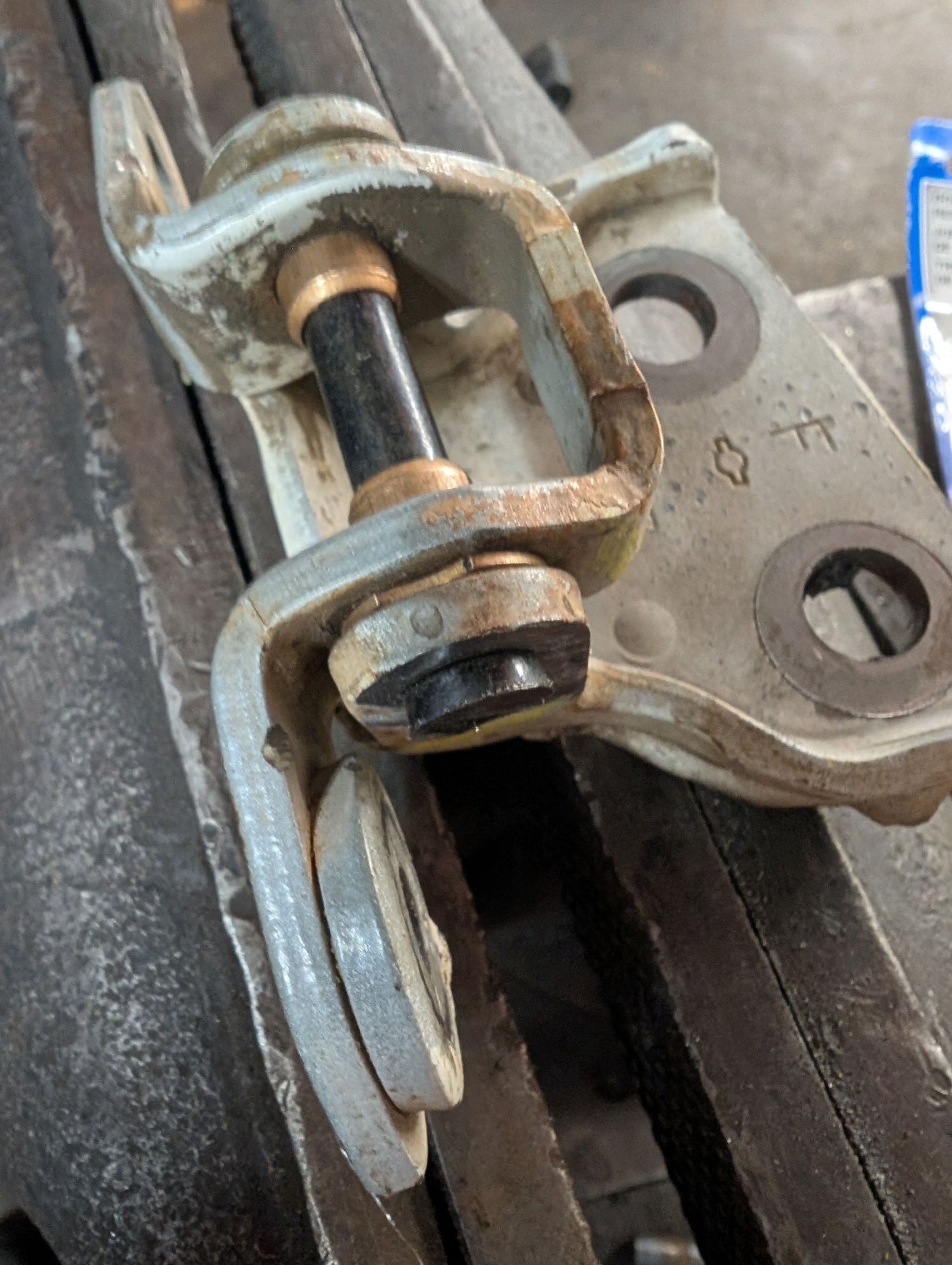

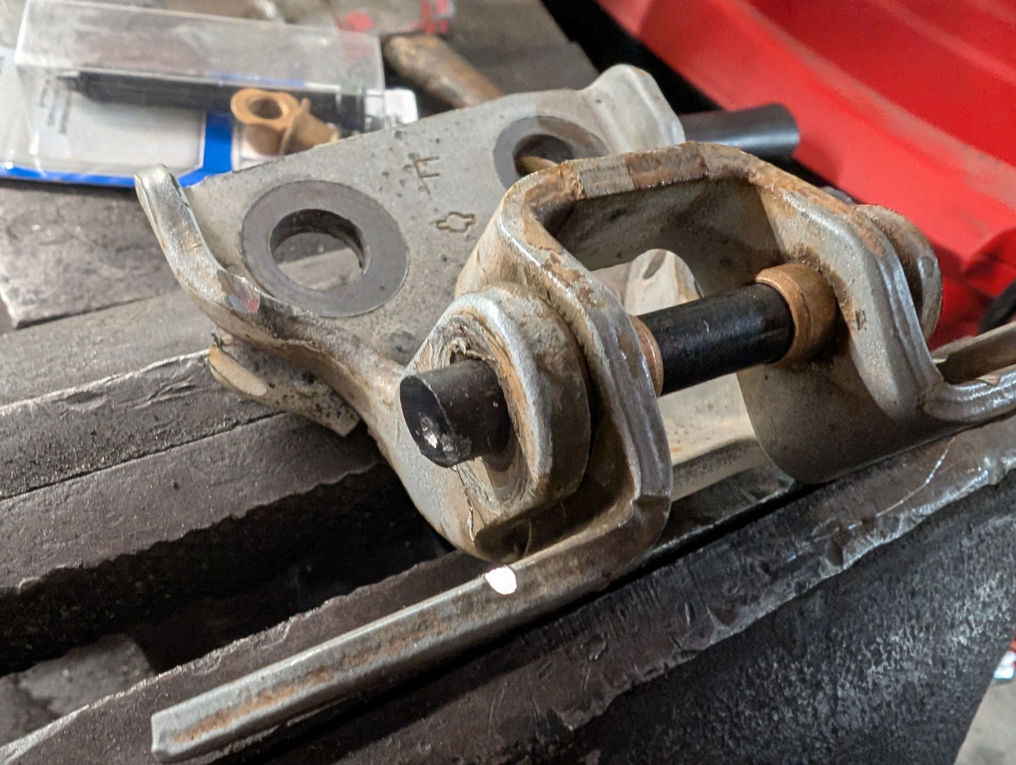

I haven't been active on the forum in a while but I'm working on my 3rd gens again. The hinge repair kit has not been talked about, with part numbers, as far as I can tell in the search. There is no specific kit for the 3rd gen. However- get Dorman kit #38397. The bushings are correct, the pin is the correct diameter just a little too long. My driver door hinges are now like new. If anyone wants more detail, ask and I'll make another post.
