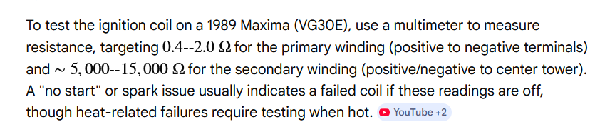

If the timing belt isn't broken that's a good sign, have you checked all of the fuses & fusible links? You can try Ohm testing the ignition coil as well, generic AI search gives the below specs

Don't trust the AI
