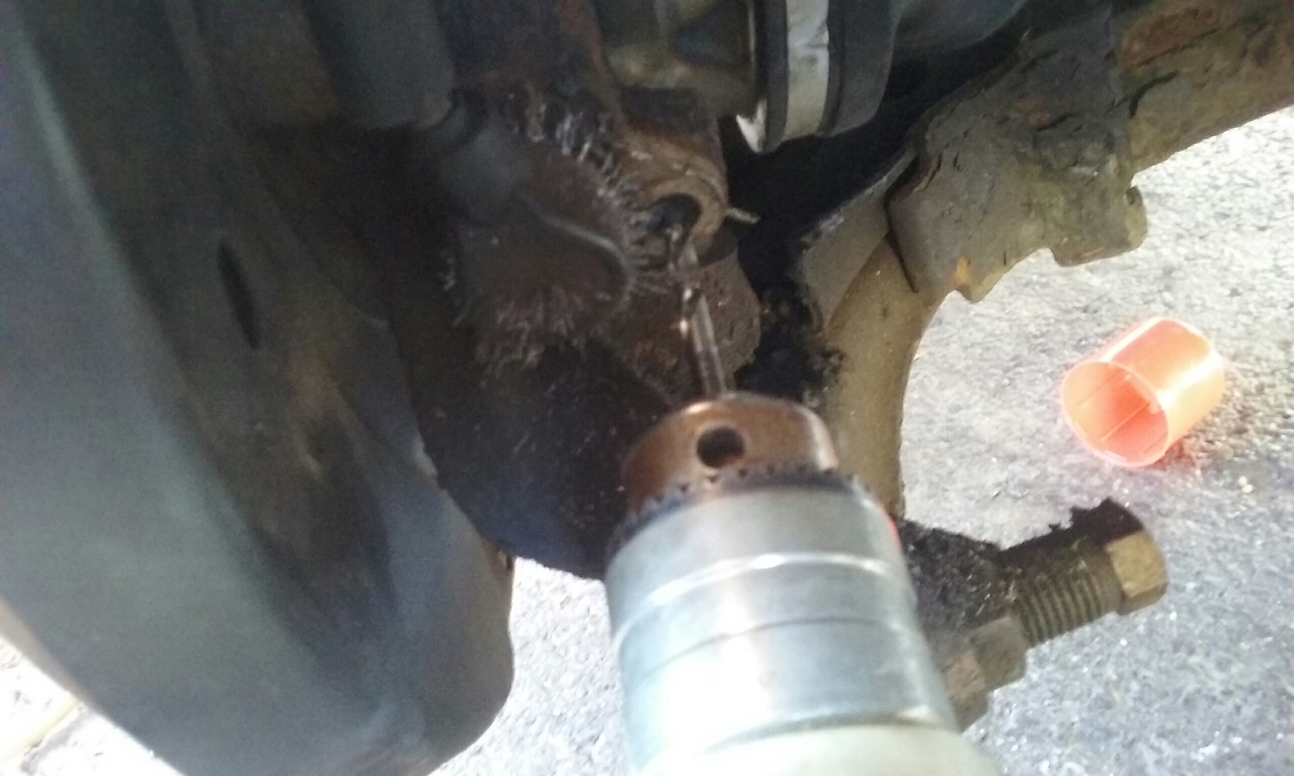

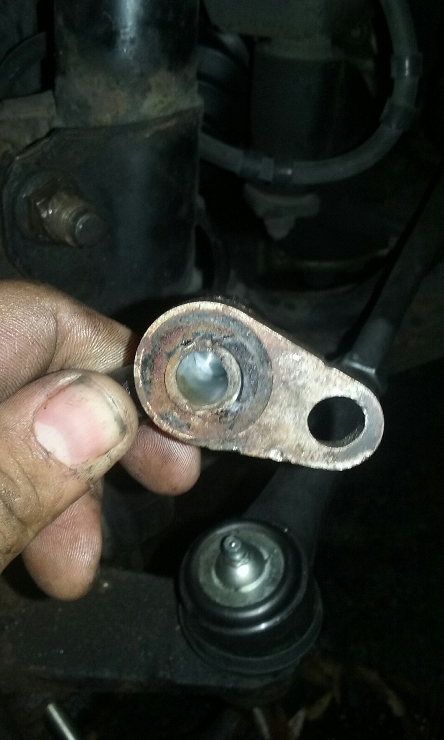

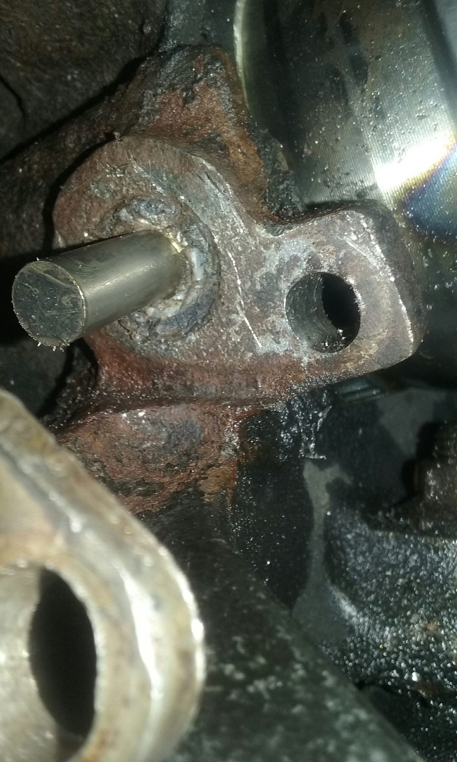

Not impossible to take out, they are impossible to take out without breaking it lol. Once that happens you have to remove axel from hub and use a punch tool to bang it out. But if the 12mm or 10mm bolt holding the sensor to the hub breaks. Your going to need to drill through the hub to fit a bolt and nut. Not a big deal. Buying a hub would be pointless because you dont know the condition of the bearing/hub and your probably gonna have the same problem etc... and if your not doing your own work it will be costly to press in bearing. This took me about 1hour to do, it was fairly easy. Just need patience and right tools and you can have the new sensor in.

All four of mine broke it was a fun project
