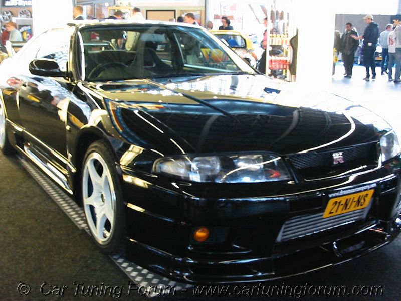

I'm going to make my own front bumper, I'm going to use a frontbumper from Wings West that was originally designed for a Acura Integra, saw it up and mold it wilth my stock bumper. I haven't ever done it before, but I think when I take my time, do some research and have enough patience, it should be possible.
I made a photoshop example of how it would look, and the minute I had the bumper fit and the colours matched I knew this is what I want!
What do you think about my design?
If you have experience with molding bumpers and stuff, please email me your tips and tricks.
GreetZ, Mitch

When I was with Lockheed we made parts (urathane, carfon fiber, kevlar®, fiberglass) from scratch all the time. It is not difficult, however you must have a few key ingredients:
1. Time - it is very time consuming to do the job correctly. Don't expect a weekend project, more like months. (test fitting, re-testing, re-fitting, re-fitting, re-fitting, allowing proper time for the components to bond....)
2. Proper tools and materials - In theory, you could use a Dremel tool, some epoxy and some bondo, but it would fall apart, crack and look sub-par within a week. Fiberglass and urathane require specific atmospheric conditions to set properly, so you'll need a dedicated (not the garage, you'll kill your whole family from the fumes) space to work in, with proper climate control and ventalation. Also, when working with specialized epoxies and bonding agents, it is very important to have everything prepared accurately, which means all components need to be mixed by weight (buy a nice scale). Most importantly, purchasing appropriate safety equipment is a must. You'll need a class 3 respirator, chemical gloves and possibly a chem suit to protect from spills.
I would encourage anyone to custom-fab parts from fiber, but just know what you're getting into. Because of the time spent, you may want to consider creating a buck/mold system so that you could make multiple pieces to recover your investment. Go to the local library or Barnes & Noble and look at books on fiberglass techniques, they will be very helpfull.

Belosic, thanks for your input, that's what I asked for.

working with fiberglass is likely the way that you'll have to take to make that bumper work. It will take Time as mentioned above, not to mention, reduce your daily drivability (is that a word). Once some moron backs into the bumper...kiss it good BYE!...otherwise...just take your time, and props for trying something out of the norm...oh and welcome to the orgy!
