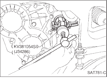

Change transmission seals with cv axle replacement?
I've got a '96 GLE with an automatic transmission that has a torn driver's side boot. I've ordered a new
right driveaxle from raxle's. According to the factory manual and the Haynes
manual you're supposed to change the transmission seal that surrounds
the shaft for the inner cv. I see no discussion of changing it
in this thread . Are you supposed to ??, and are there any
available tools to make easy to do, rather than the special tools shown in the factory manual.
Thanks,
Phil

You could since you are in there anyways, but I would not unless they are leaking.

I think you do
I30ds and Randy,
I haven't pulled the cv joints -> driveaxle because the new driveaxle hasn't yet arrived. I'm not sure if you get any fluid loss unless the seal is worn
when you pull it out. The car has about 100k miles on it and the factory and Haynes manuals say you're supposed to change the seal. I just don't see any mention of it in the motivate.ca article or in this thread. If anyone who has personally done
the job reads this, could they comment please.
Phil

You dont have to replace the seal... Only if its leaking. The tranny must be drained prior to removing the axles or replacing the differential side oil seals.

Whatsa "kent moore tool ??"
I30ds, whatsa "kent moore tool??" I see from the shop diagram, they use some tool with the same diameter as the seal to push it in. As for the tool they show taking it out, I have no idea what it is , nor if it is easy to scratch the seal shaft taking the seal out.
Thats the kent moore tool I was talking about.

Found some Spx Nissan Tools
This is the tool to protect the seal and align the shaft when putting the axle in : http://www.nissantechmate.com/detail.aspx?id=228
The seal puller tool is shown in the manual here:
http://users.rcn.com/charlestek/DiffSealPuller.gif
I would guess that this is expensive, and I don't see
anything like it in the SPX Nissan tools, or maybe it is there somewhere ??
Hmm, If you click on the "Click Here to download" of this link
you get an adobe pdf file of all the tools!!! I'll have to look:
http://www.nissantechmate.com/ToolOrg.aspx
The tool is tool # J34286 but it isn't listed. Probably is a generic seal
puller. I'll have to call Spx Nissan/Tech-Mate/Kent-Moore and ask them.
Probably/hopefully I can buy/rent the tool from my local clueless autozone.
No this is it... http://www.nissantechmate.com/detail.aspx?id=105
remember each side is a different drift if you have the LSD tranny.

Looks Like tool it install Seal
I30ds, this looks like the tool to install the seal.
What about a tool to pull the old seal out??
That tool was right.
