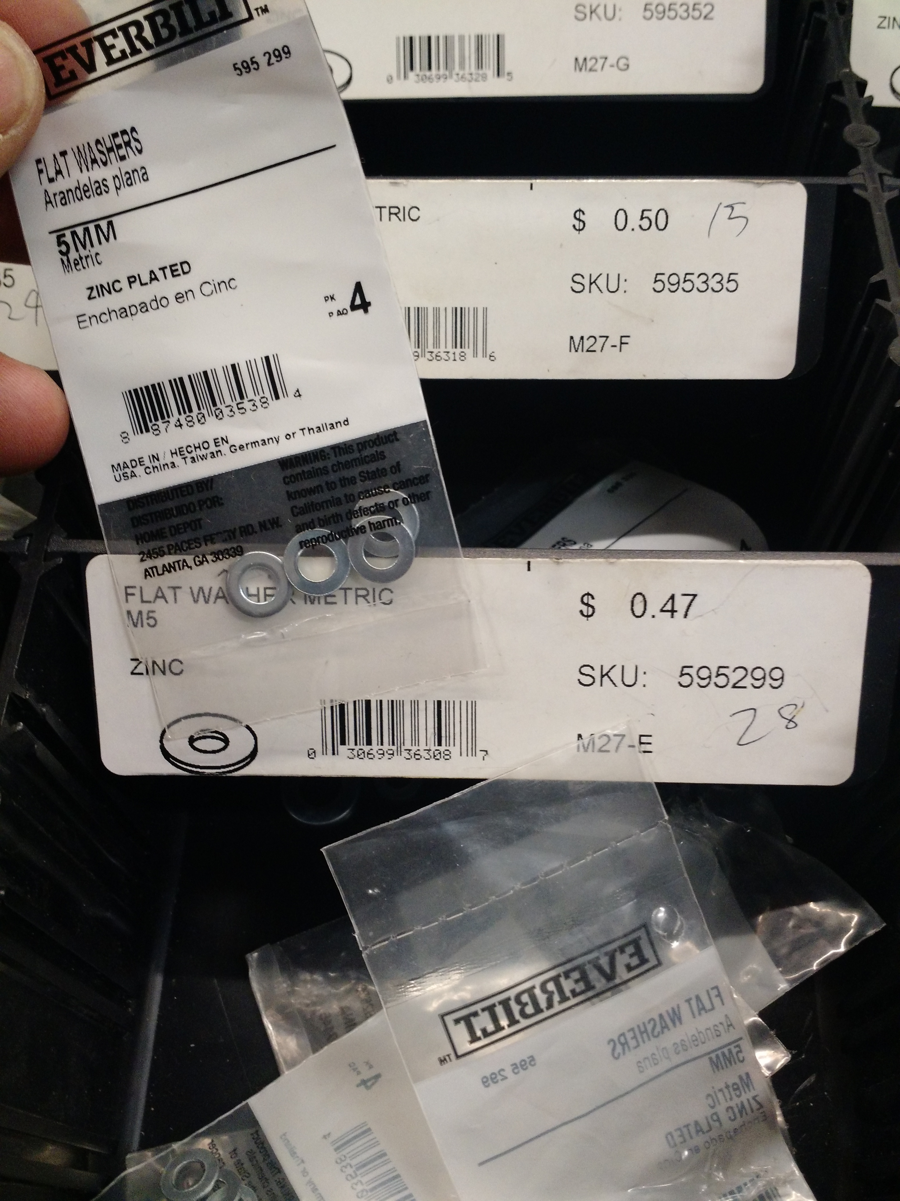

Ok I went to Home Depot and search for the number 5 washers and lowest the had were 6 ? So where you get the fives ? Thanks
I just attached a photo
