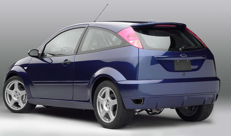

Yes, I've seen the RWD Focus that you can purchase aftermarket:
I've also seen a few AWD civics and an Integra. That's what convinced me to go ahead and do some serious research on this.

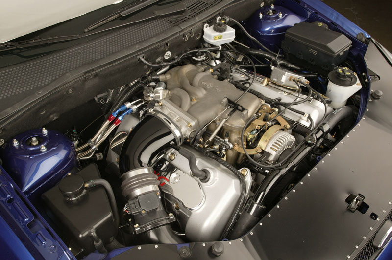

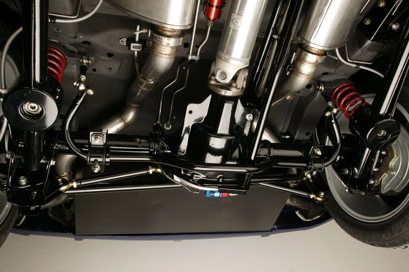

Okay i tried to dig up two articles for you. The first one i found was a second RWD V8 Focus, sleeper as ****. Made by ATI heres the review by Sport Compact Car http://www.sportcompactcarweb.com/ro...or_ford_focus/
The other i tried to find was the twin engine 1998 Tiburon. also check out www.durocco.com he made his own AWD twin engine scirocco. maybe a twin engine max is also a possibility.
Either way good luck itll be a hard project but definately different and amazing if you accomplish it!!

Subscribed. That Focus is the Focus RS I believe. Proto V8, never produced.
