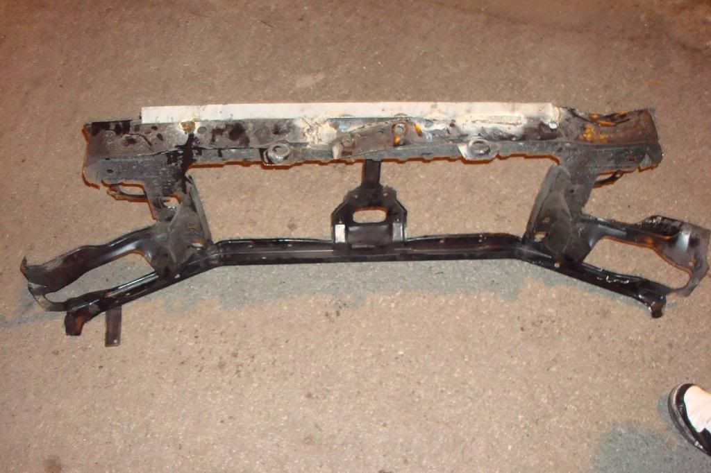

I dont have step by step pictures but I do have a couple of pics I took during the process, I will try to upload em tomorrow and post some sort of instructions while at it.
First time replaced there were to lil spots welded, second time I said screw it, its probably gonna rip again so I'll save myself the welding lol

Haha yea brakes are nice! Here's the pictures I found, sorry they were taken at night which is when worked on the car cuz the aftermarket parts store was kinda far and made it back at night. These were taken around thanks giving last year.

I just got in an OEM radiator support (listed as "lower Tie Bar") from a place in Buffalo because that was the closest, and cheapest I could find. It was only $129 + SH which was about $14. Here's a link to the website. http://www.trademotion.com/partlocat...?siteid=214143
This is a site mentioned somewhere above but for some reason this way in is $6 cheaper.
I took some measurements of my cheap aftermarket one that I mentioned earlier and compared it with this new Nissan one and found that the Nissan one uses 25% thicker steel. Also, on the Nissan version, where the bar passing under the engine bolts up, Nissan installs a nut plate out of even thicker metal (totaling about 3/16") whereas the cheaper one just welds the nuts to the lesser gauge sheetmetal and calls it good. The cheap one measures about 1/16" at the same spot.
I am going to begin this installation attempt tommorow and hope I can finish it in a reasonable timeframe. I plan to take plenty of pictures as I proceed, so they will be available for interested parties.

As I mentioned, it is the "Lower Tie Bar" which is how Nissan refers to it but yes it is what most call the Lower Radiator Support. As others have mentioned it's really the only part that rusts out. However, I discovered today that it is actually easier to replace the whole thing because of where some of the welds are and assuming you want to do it right.
Since I had the cheaper whole assembly I decided to make a "hybrid" out of the two. Fortunately the upper section is made from a similar gauge of metal so I think I will do OK. It also means that the money I spent on the cheap aftermarket one won't go completely to waste, plus I can practice my welding on thin gauge sheet metal before I try the real thing.
