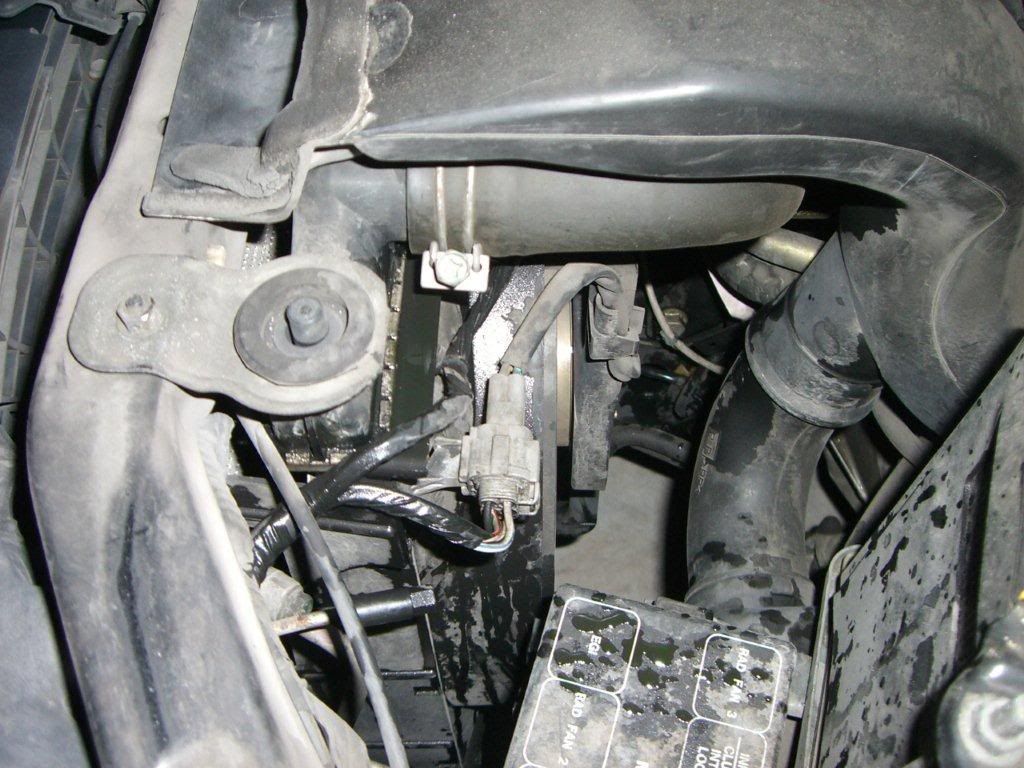

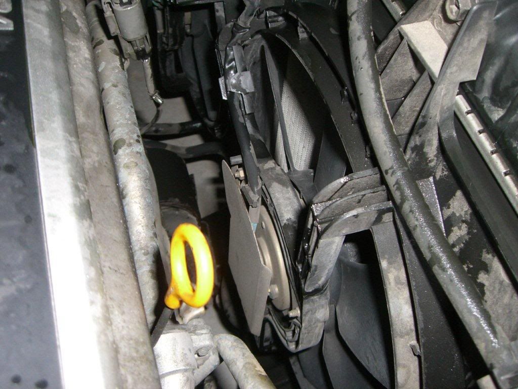

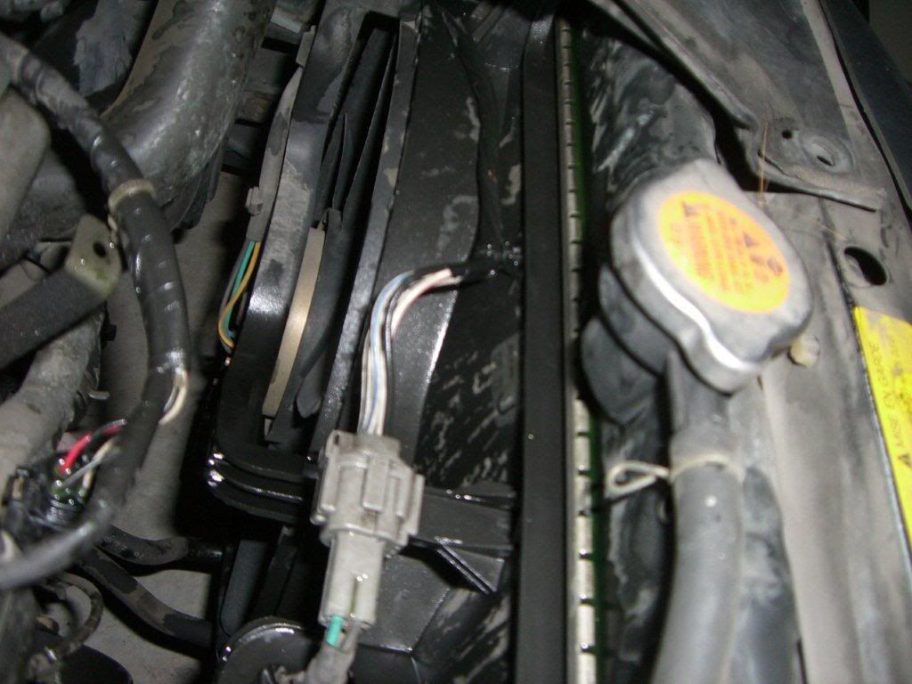

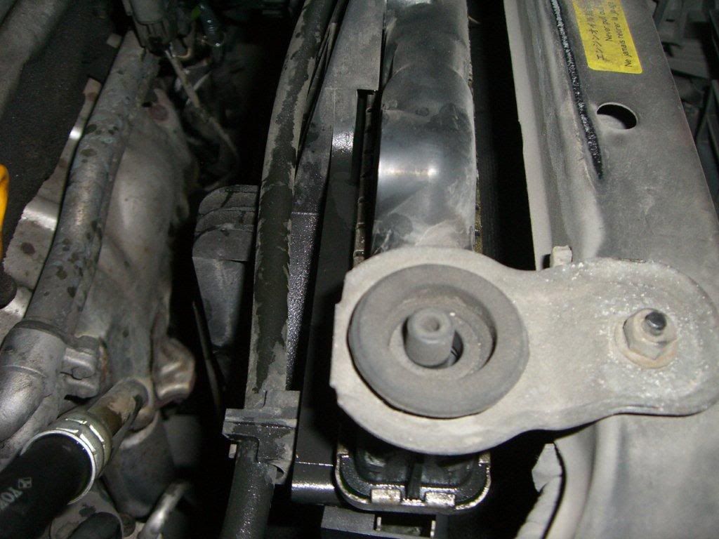

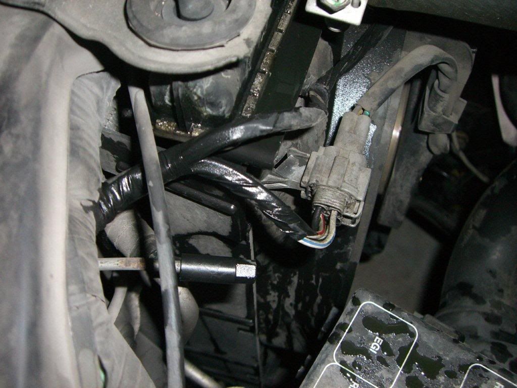

Yesterday I noticed that a couple of drops of coolant were falling on the ground near the front DS of my 98 Max. When I popped the hood, I could see where coolant appeared to spray from the radiator itself. I checked the hoses and they were all fine. The car hasn't been overheating and the coolant reservoir hasn't been very low. I even opened the cap on the radiator itself once the engine cooled down and the coolant level appeared normal. I did research this forum and saw that some of these late models were prone to the radiator cracking. I have attached pictures below. Does this look like the same issue? It seems that replacing the radiator is pretty straightforward, but does anyone have any tips or advice that can come in handy? Also, what do you recommend as a replacement? Thanks!

Looks like the classic upper plastic tank crack to me.
Let the car cool completely.
Hose it all down to clean it up and rinse the coolant off of everything.
Start it and let it warm up while you watch.
See if you can pin point the location of the leak.
But, based on the pooling of coolant in and around the aluminum tabs at the top of the tank, I'm saying it looks like the classic upper plastic tank crack to me.

there isn't a crack, but the gasket between the plastic part (tank) and the metal part (core) went bad. Happens all the time on these style radiators regardless of what vehicle it is put in.
You can have a radiator shop fix it pretty cheaply if you want. I did that quite a few years back on a camaro. Sent the radiator in to be tested, found the leak, they repaired it for $35 and I put it in. worked fine for years that way.
