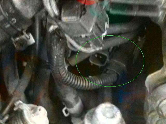

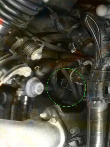

Sorry for this noobish post. I just bought this maxima and noticed that a connector isnt conected. I cant find where it's to suppose to be connected to either. There's two green connectors, one is connected while the other isnt. Please help.
Thanks very much.
P.S sorry for bad pics, i'm using a mobile phone's camera.

That is one of the 3 solenoids for emissions. IIRC green is EGR. I bet you some one had to replace that solenoid and could not get it out so they installed the new one next to the old one. There is supposed to be only 1 green one. What year is the car?
Id look at my car but I ripped all that stuff out years ago and relocated it.

Hey, thanks for the reply. Its a 1997 Maxima GXE. I'll post more pics tomorrow if you like.
