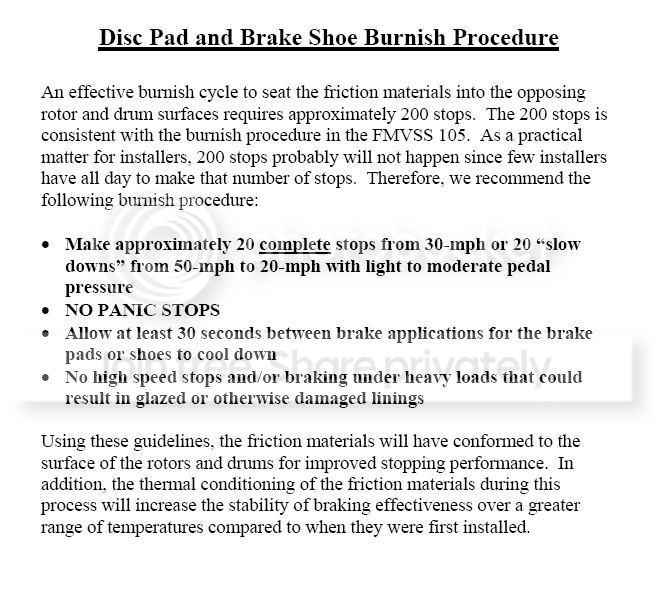

I can across this comment when looking up the anti-squeal bit:
If the ten stops were done in a row without any cool down, then the procedure will work for many performance pads from Porterfield, Hawk, PBR/Axxis, etc.
However, it is not the correct method for OE replacement pads from Raybestos, Akebono, Wagner, etc:
(source)
(source)
